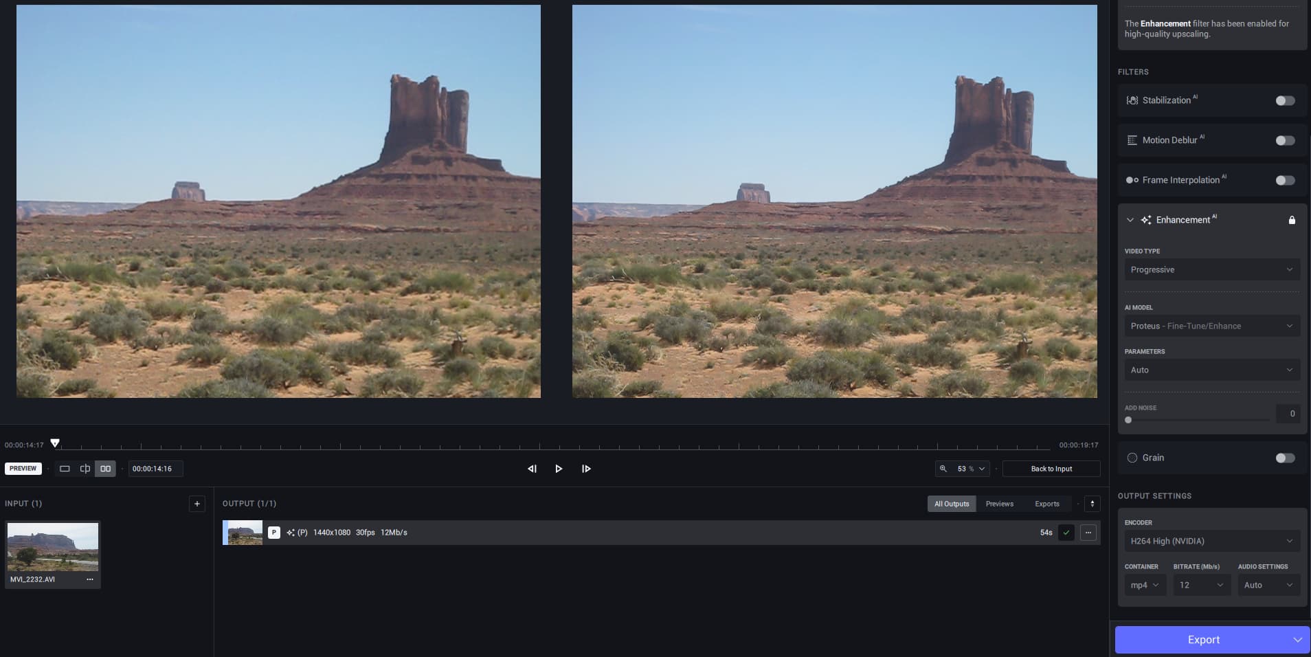

here: clip
everyone is welcome to try. settings I used:
Proteus enhancement, no stabilization, no motion deblur, H265 Main10 (Intel) encoder, mp4 container

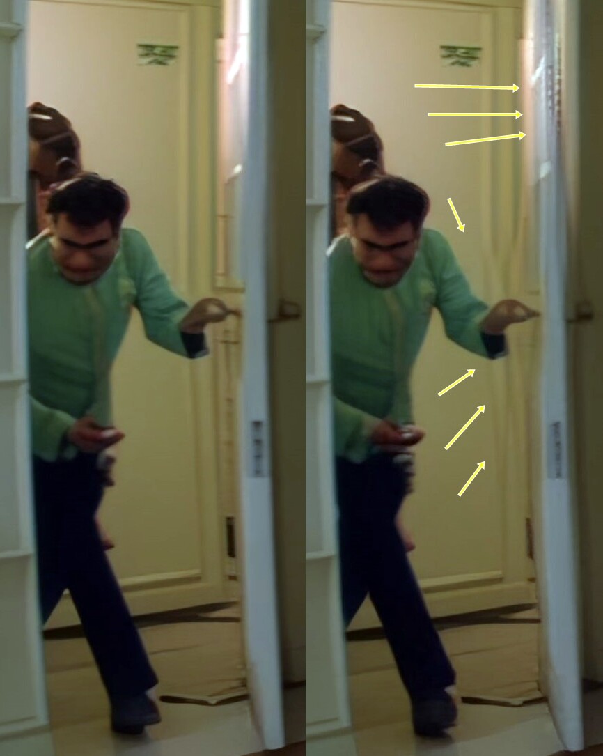

I found that when converting a DVD 25fps to 4k 60fps (Chronos Fast + Proteus), with the Replace Duplicate Frames function turned on, the final video has small jumps, jerks, and distortions that are unpleasant to the eye. Without this function, the video seems to be smoother…
This is a matter of course. The function of replacing duplicate frames is to insert more frames, which of course is more prone to problems.
No issue by using H264 High (Nvidia) Here, will try H265 Main10 (intel)
No problem using H265 Main10 (Intel) as well here.
