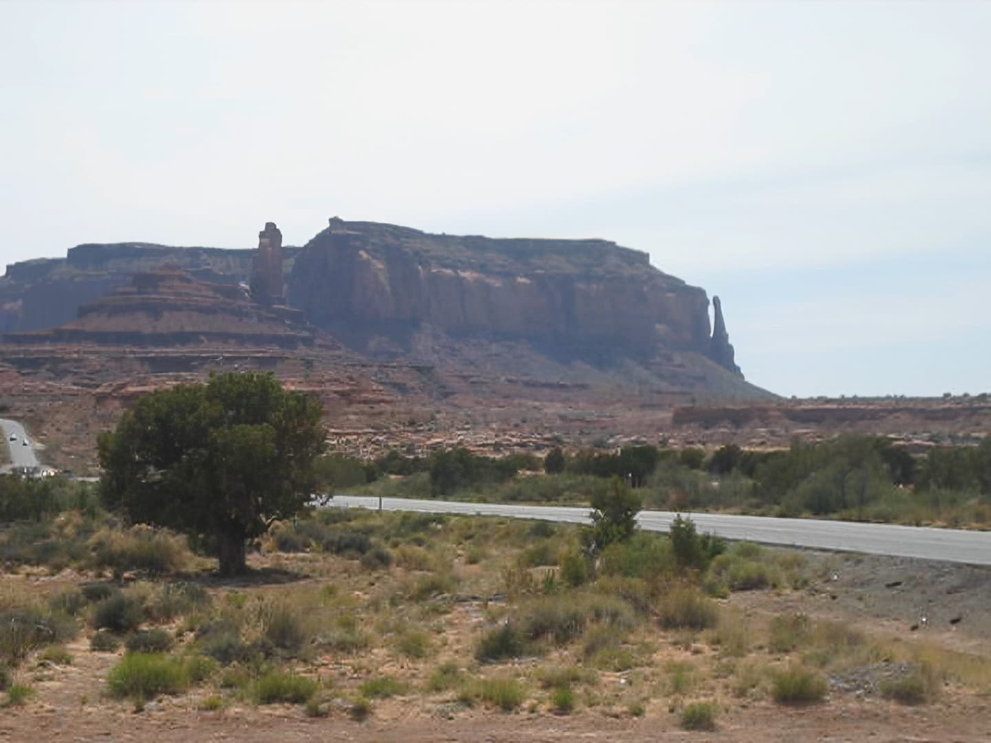

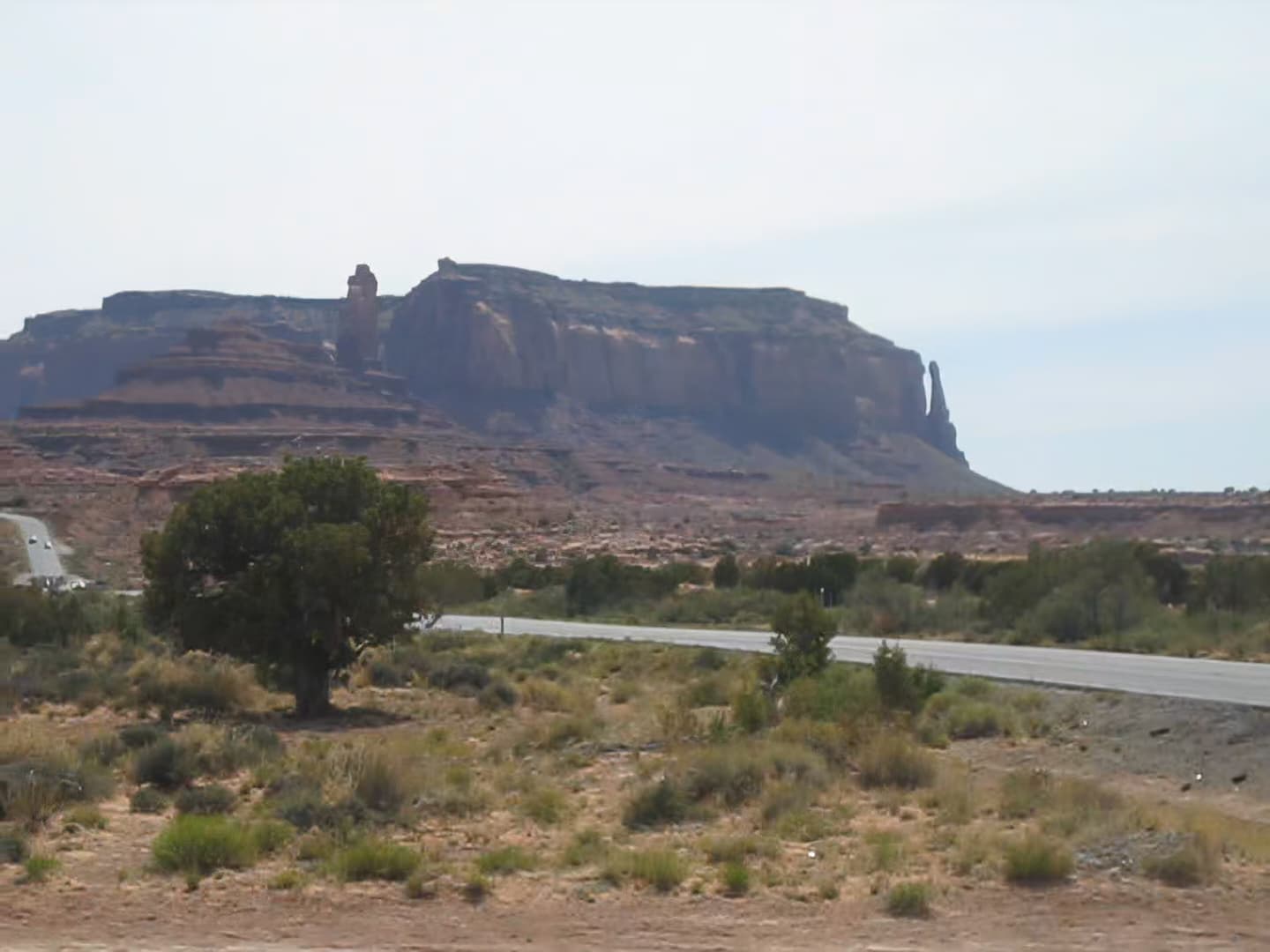

You need to compare that in a video player. I use Media Player Classic.
Note that Video AI will always display the color wrong both left and right picture.
That is why you don’t notice the issue.
it is a different clip but it is affected in the same way.
the other clip I prefer not to share for personal reasons.

yes, I have the issue here in MPC-BE, need to do some test, but i think it’s maybe related to the Mjpeg format you have → intel Encoder in H265 Main10, i’ll test other combinaison, hold on , and will re encode your original video too.

Found your issue !! it’s the Mjpeg format, maybe an issue with the windows decoder of the mjpeg one, i bought some years ago a licence of a Mjpeg specific decoder because of this, i had a Movie (done by a director friend) to upscale from an Avi Mjpeg Capture Card (from 1999…). Had to buy a special encoder for that, windows one was doing a mess. (it was even worst as entrelaced).
here is the picture directly exported by vegas pro 19 as Png. the issue is the same than the picture displayed in MPC (first is your original Avi source video)

I don’t know how you do it, but on my side, using nv encoders, there is no such problem.
what did you do exactly ? and give system / codecs spec ? (with codec you use ? i use the Lav Filters from MPC, maybe it’s related to the Lav filters on MPC itself.
First / saved picture from the source file in Avi, picture saved by using MPC-BE
Second / saved picture from the source file in Avi, picture saved by using Vegas Pro19
video displayed inside VegasPro are fine like in Topaz.
MVI_2232.AVI_snapshot_00.00_2023.02.19_13.34.07
MVI_2232.AVI_VegasPro19
Maybe it’s just a decoding problem, using nv h264&h265 encoders behaves basically the same in mpv.

yes that’s what i’m thinking too. but the picture output from VegasPro is showing the issue. So i’m trying to find where it is (lol), much easier to test than in Topaz :wink: but clearly it’s not a topaz / VideoAi related issue
thanks for the suggestion.
it looks like the color is affected simply by converting the video from avi to mp4.
that makes the matter even more complicated for me.
and i have to withdraw my suspicions and doubts about correct operation of Video AI
the problem seems to lie elsewhere
You only need to transcode the input video to a common format first, and if there is no difference, then throw it into the Video AI test.
yes, if i have the same issue with Vegaspro19, clearly the issue is not related to Topaz / VideoAi.
i thought that it could be an issue with Color Profile 0-255 / 16-235 , i tried that but it’s not. on vegaspro, it’s not related to MPC-Be, but i don’t know which is doing the import treatment, is it Lav Filters with Vegas ? I’ll Need to install my old Mjpeg dedicated decoder, but really i’m too tired to try all this now (didn’t slept since 24 hours and can’t sleep before 10 hours lol), but at least, you know it’s not a topaz related issue ! so if you can continue to investigate on your side, that would be kind :wink: (or hoping someone else here want to help (but outside of the topaz Ai “thing” as it’s not related).
