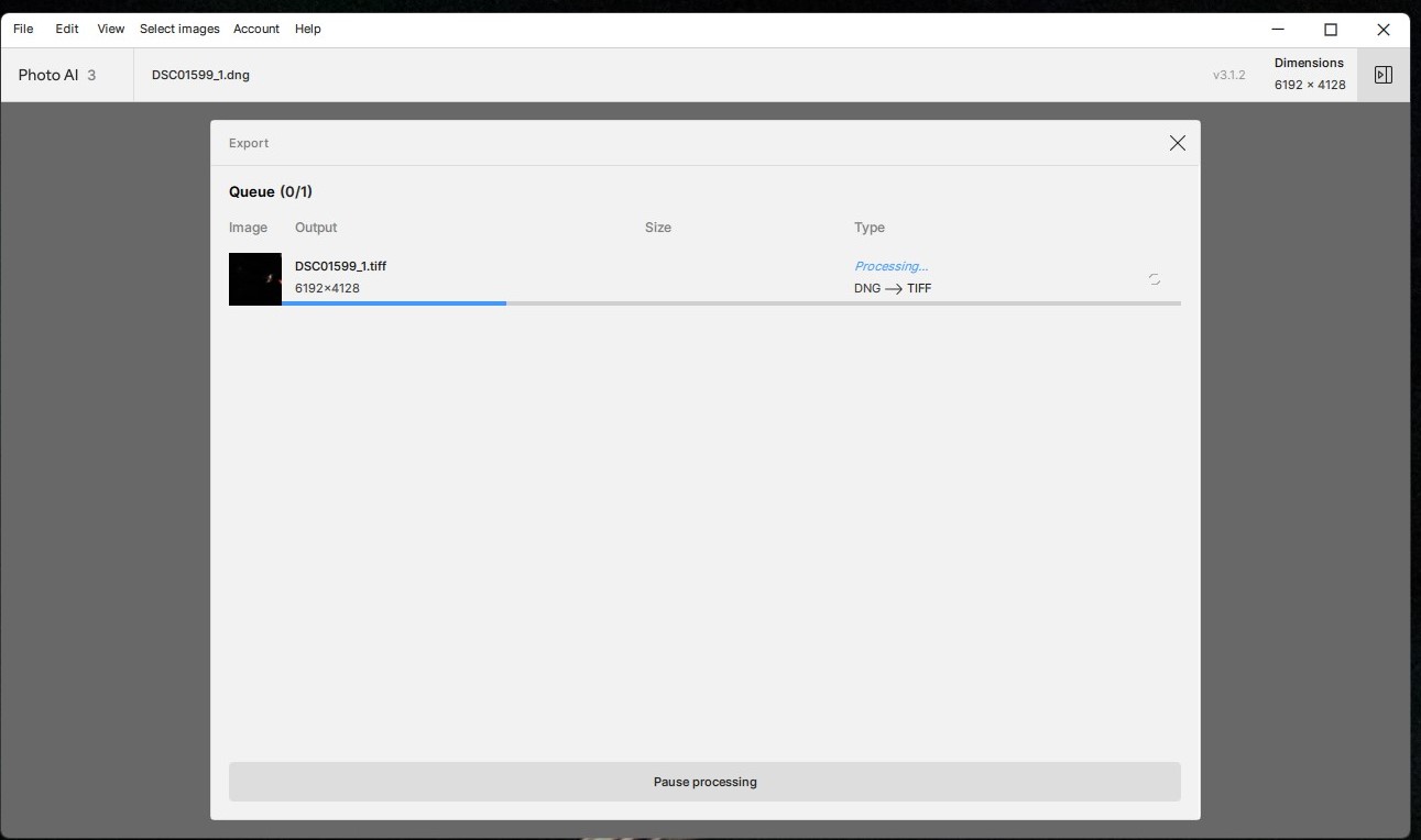

I’m still only seeing re-export from tpai to c1 as a tiff, even using this procedure - C1 creates a dng and tpai imports it, but the export to Capture One dialog only gives me the tiff option still.

Sorry Peter, does not work. When I choose “ edit with” and use TAI (not processing) than I only can “send” a .tiff or .jpg to TAI……Both ways I get a .tiff file back in Capture one. So uninstalling TAI3, back to 2.4.2

Hi David, in my post I did not mention that I am still using Windows 10. I did another test today with my laptop which is running Windows 11. Results are fine when I use TPAI as described. One thing to consider is if you use either “adjust lighting” or “balance color” or both the result will be tiff and not .dng

Hi Peter,
I just did an uninstall/reinstall of 3.1.2 and still can only export to Capture One as a tiff (windows 11, tpai 3.1.2, c1 16.4.4, using edit with (not open with) photo ai (not process with photo ai)). I’ll keep playing around but I’m not keen on doing a full reinstall of C1 just to make a plugin work.
“Edit with” does force c1 to make a .dng and load it into the current (“Recent Imports”) workspace, TPAI denoises this .dng, but (without doing anything other than denoise, and even not doing denoise), export to capture one only uses tifs (and this tiff doesn’t get reloaded into the Recent Imports workspace, either).:
The best I can do is quit the tpai plugin after c1 creates the dng, open and denoise the dng in the standalone tpai, and save it back over the original dng, which c1 will then operate on.
My license runs out tomorrow so I’ll have to hope this gets cleared up.
Regards,
David
David, I am just a user like you. I would contact Topaz support. Good luck
