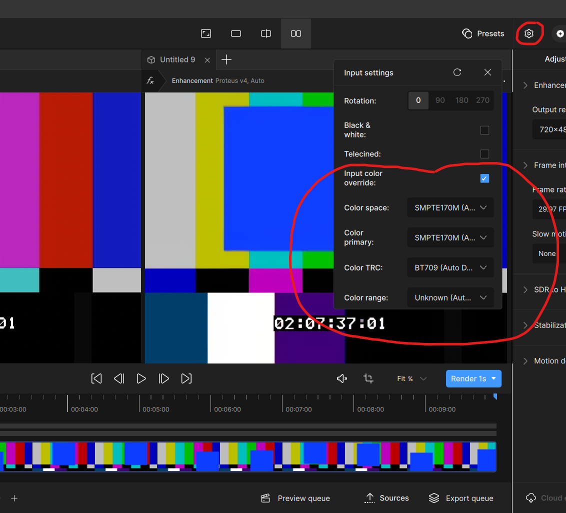

Hi there! I realise this comes 2 years later but… using your work flow with FFV1 in TVAI 5.3.6 results in heavily color-shifted (orange-skinned) results. From my research, it seems TVAI is assuming the wrong color space (BT.709 where it should be 601). Are you aware of this issue? If so, do you know of any workarounds? Much appreciated
FFv1 gives the best video quality if you use AVI. Regarding the colors, when I upscale my SD sources to HD, they switch to BT.709, so the colors change (for the better).
You can check what TVAI detects, and use a tool like MediaInfo to confirm:
