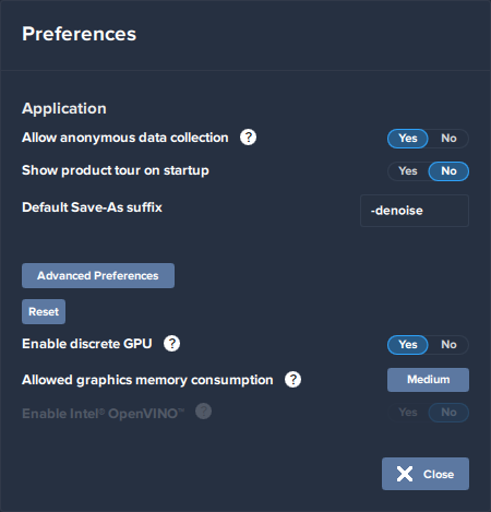

Very strange problem that I haven’t encountered before. DeNoise AI v2 doesn’t want to denoise my images unless I run the program as administrator. It opens fine but using any denoise setting doesn’t do anything. I tried both GPU and CPU. It only denoises if I run the software as administrator. I’ve never had to do this before with any version of any Topaz software. All of my other Topaz AI products work perfectly fine without running them as administrator.
