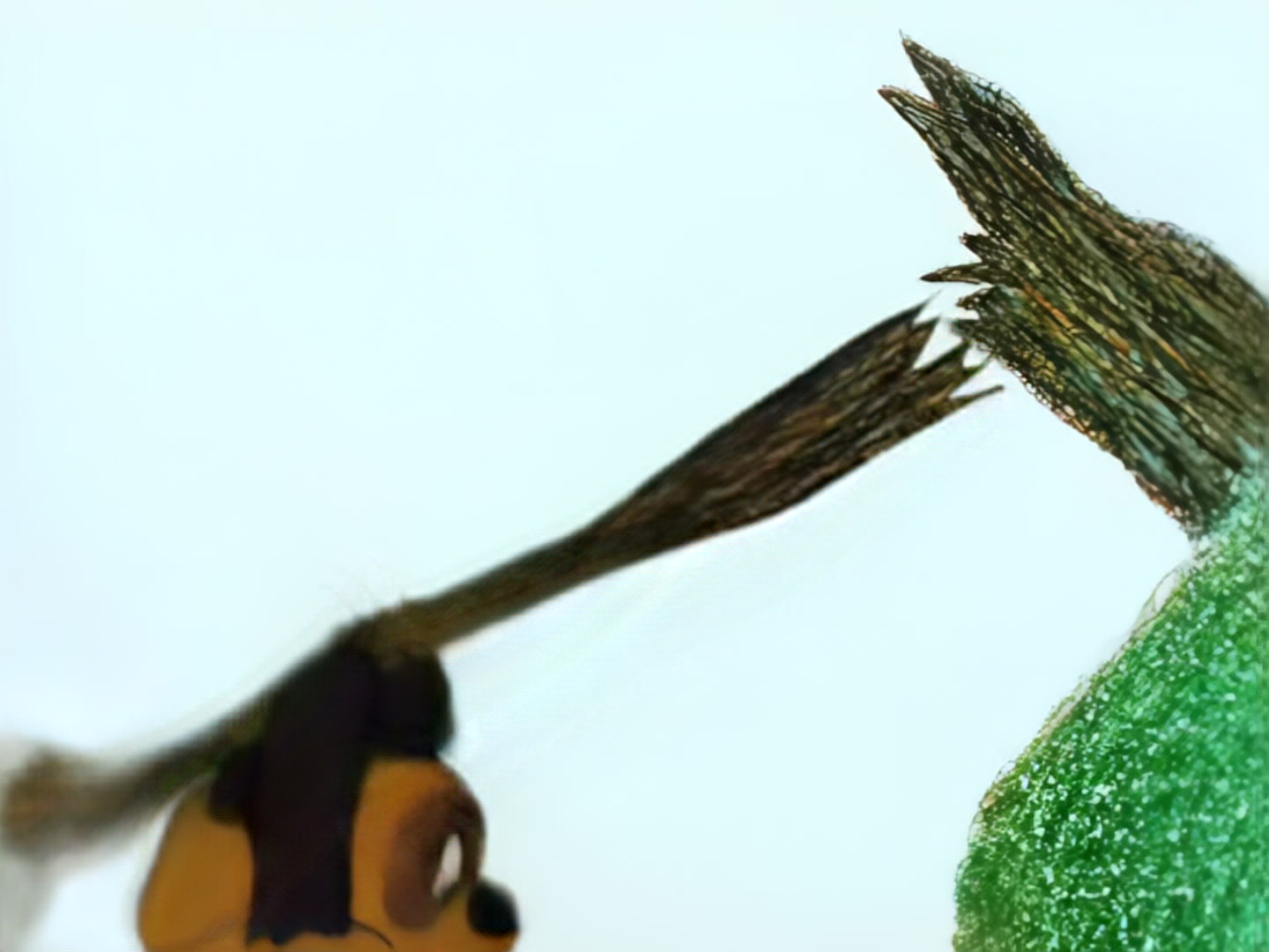

Frames interpolation bluring.
Here is a comparison between RIFE model and Apollo model:
Apollo:
Frame 1:
Frame 2:
Frame 3:
Rife 4.6:
Frame 1:
Frame 2:
Frame 3:
Conclusion:
Both examples are x2 interpolation.
In RIFE example Frames 1 & 3 are original. So they are intact (model do not output them).
In Apollo model frames 1 & 3 are changed (even thou should not?).
And frame 2 in Apollo (interpolated) is very blurred/lost details.
As I saw Chronos have same issue.
Ofcourse maybe Apollo & Chronos were not trained on animation…
Can it be fixed?
I think interpolation model should not add motion blur effect to interpolated frames.
Looks like its a result of wrong training data (blurred fast movement scenes should not be used as training data?).
