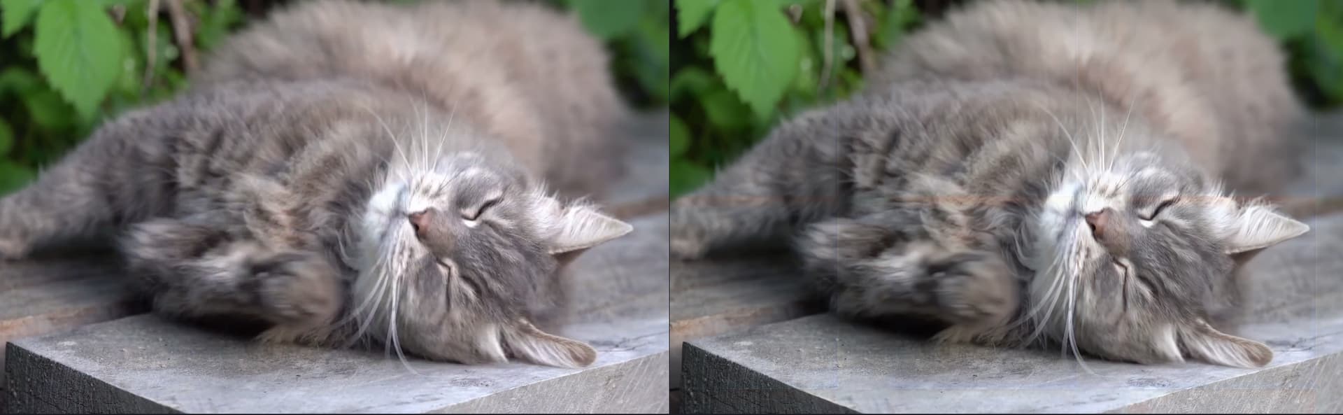

Proteus v4 still appears to have a tendency to make a video softer and blobier than Proteus v3, especially when working with lower quality videos.
Higher quality videos are still softer, but it’s not as bad.
Here’s some examples:
Note: Original on the left, enhanced on the right
Note 2: Also, all these images where taken from 120 frames into the processed video.
Note 3: Auto was used in all situations.

On a positive note: Proteus v4 continues to be significantly better than Proteus v3 at dealing with and hiding compression artifacts from the original video.
Looks somehow like a loss in tonality to me.
Maybe you could add some noise to it to fill the gap.

I think the reason for the loss of tonality is that the image is converted to a JPG according to forum specifications.
When viewed on the NLE, the tone jumps are not as apparent as they are in the JPG displayed on the forum.
In Proteus v4, the noise is reduced, but the detail is greatly diminished.
The image quality is like an oil painting, as if a large amount of Gaussian blur had been applied.
yes, Prot 4, is like Artemis Low little brother
Input and Output frame a hard to compare because they show different frames again! :eyes:

So far, in the examples shown, Proteus v4 is adding significant artifacts, and detail is significantly reduced.
It’s unusable in this state.
