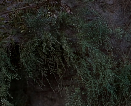

After installing this beta, it has messed up Proteus 4 in the main version of TVAI.
I was working on making previews with the main version CLI. I installed this beta between runs. After the install, the speed of runs doubled and the results started coming out super bad even on settings I had tried before.
Guessing it has to do with the Proteus 4 model that is available for download now. When I installed the Beta, I told it to delete old models.
Since then I have reinstalled the main version of TVAI and restarted my computer. The new Proteus 4 model is still there and is still slower and gives terrible results.
New results:
Old results exact same settings:

So is it a model issue or a program version issue?
EDIT: I compared the new downloaded model in the BETA (I cleared my model Directory) vs. the older Model from From Jan 31st that is in my non Beta model directory and the file size is exactly the same.

I found the root of my issue. Nothing to do with models, just mistakenly renamed some files.
What was it in the end…? you keeping me in suspense on purpose? :slight_smile:
I am not certain how it happened. The original file got replaced with the upscaled file. I’m blaming my script. I might have unintentionally programmed it to do that if I forget to give it a new name.
