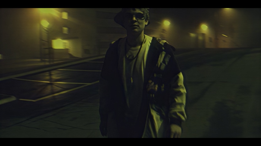

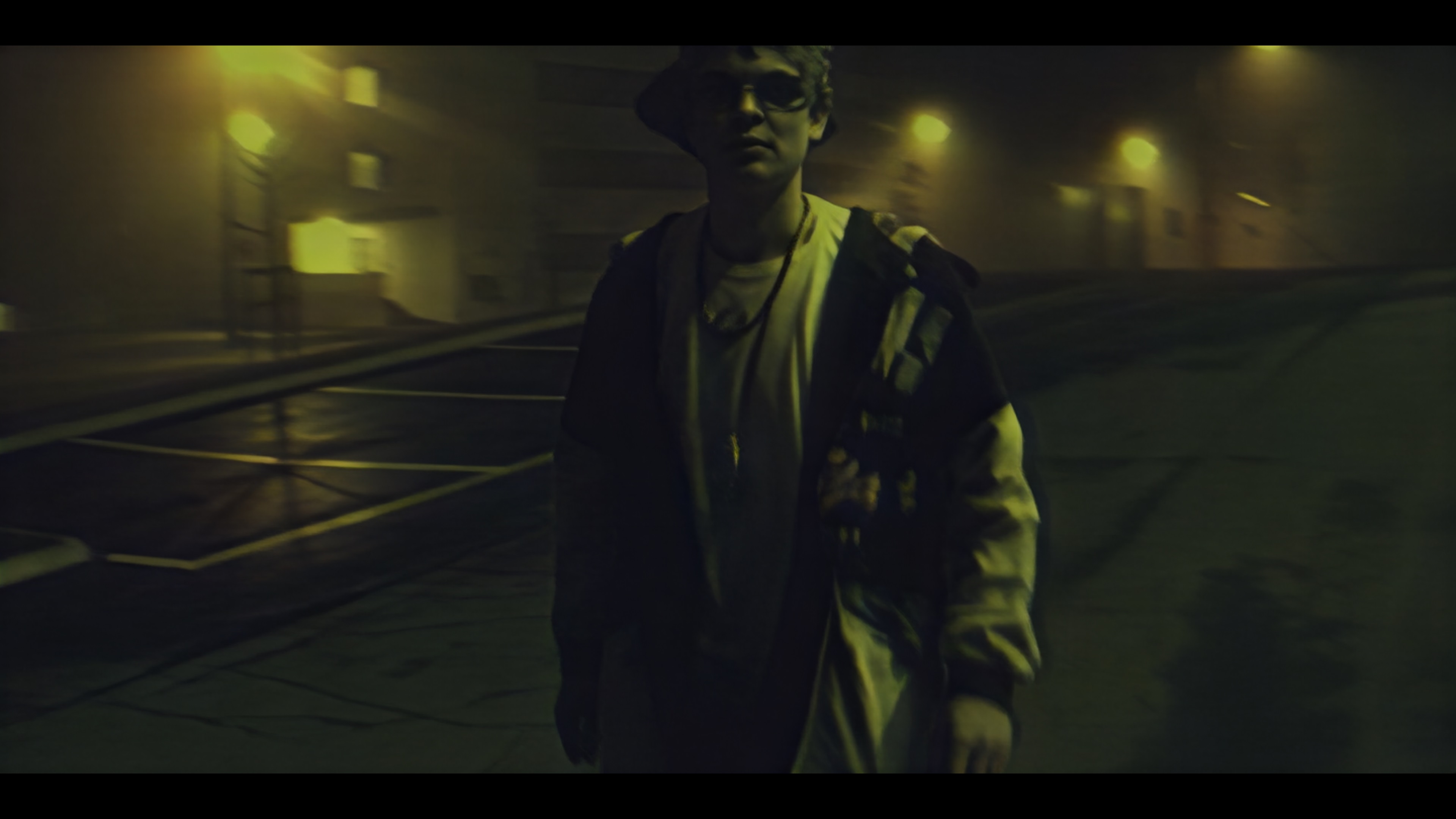

Okay, the original file is actually quite compressed, not only grainy and low-rez… :stuck_out_tongue:
SLP using @hi8upscale’s 5-export blend (1440x720p that will be upscaled further to 4K later)

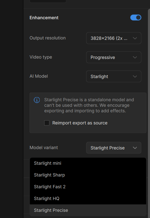

…so is Starlight Precise 2.5 simply listed as “Starlight Precise” in the UI? Because that’s all I’m seeing.
Yes it is “AI model = Starlight”
Then under “model variant = Starlight Precise”

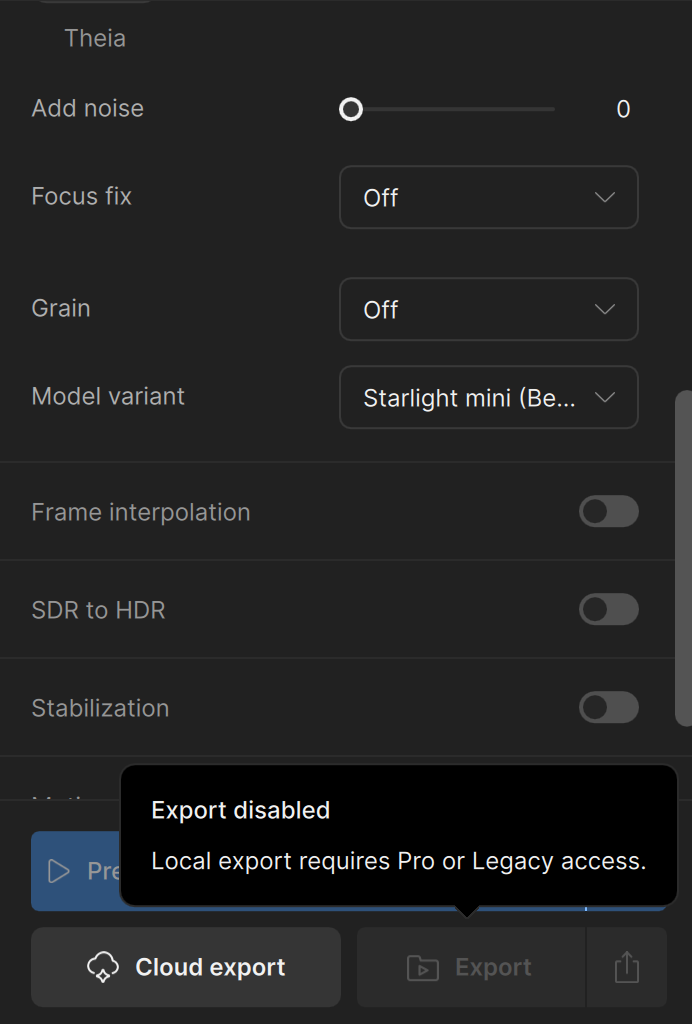

Trying to run Starlight mini on my m3 max. Why i’m getting “Local export requires pro or legacy access”
I am OG Topaz user since begining. :c
Admins, can you fix me pls?
Just payed 30 dollars, reneved montly license and get this sadly thing. I want use Starlight mini. Do i should write to support?
