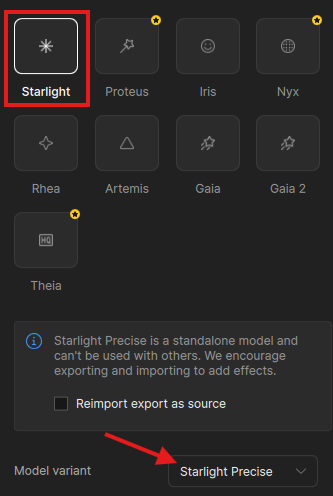

You should see it under the Starlight model when looking at the model variant. Precise 2.5 is available to all users with an active subscription to Topaz Video.

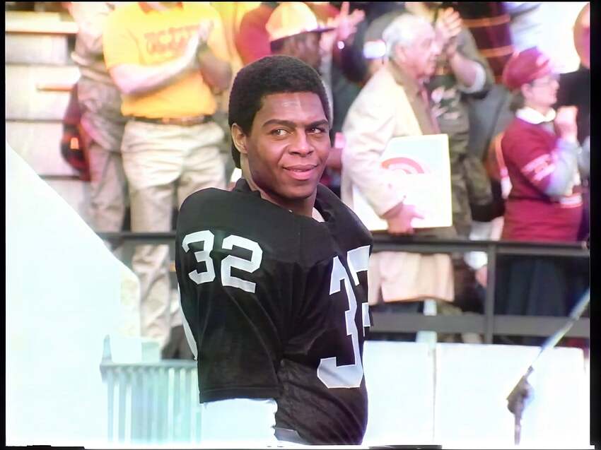

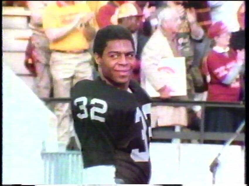

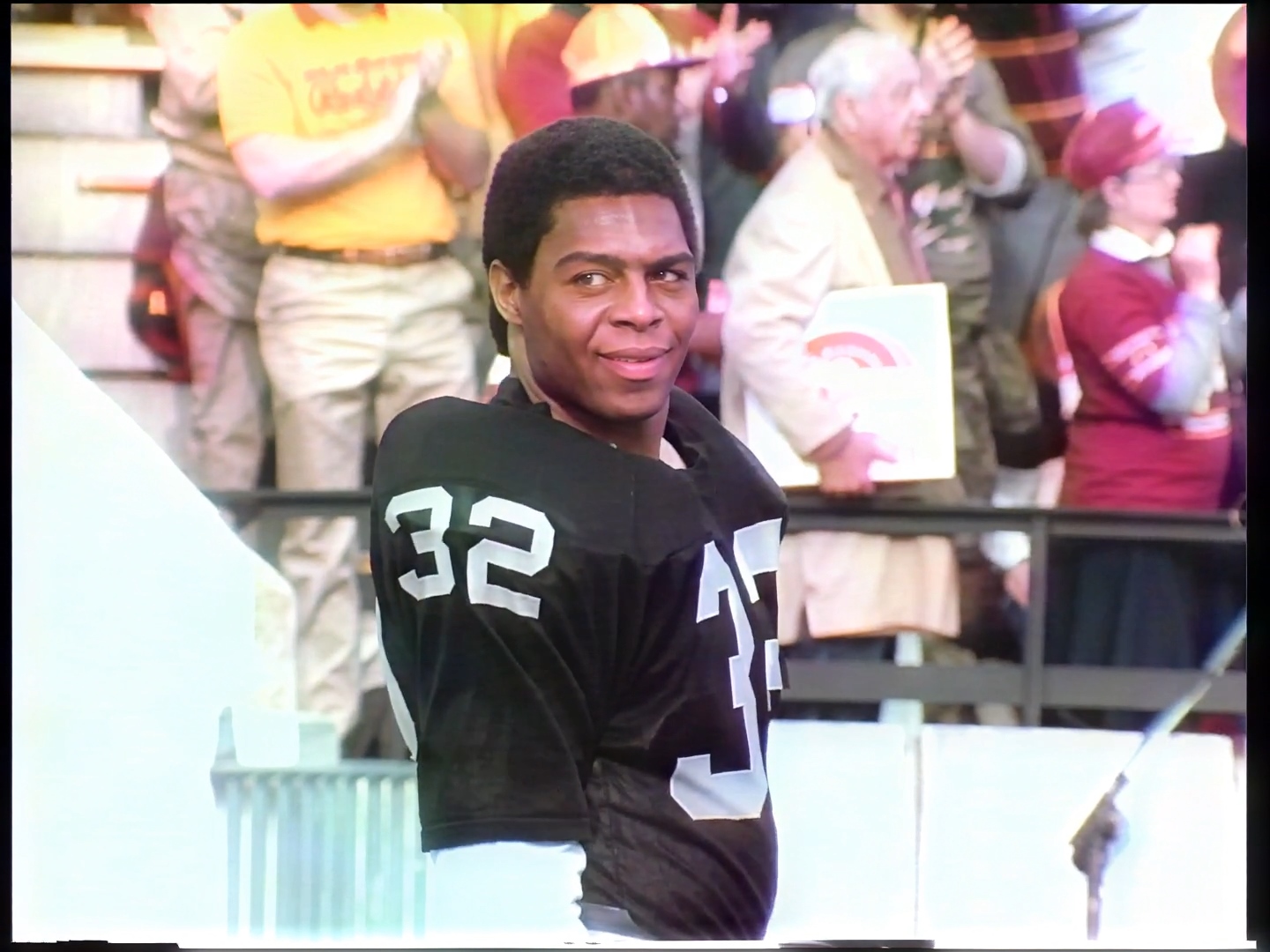

Any chance the frame ghosting issue might be fixable?
what is it?
Sure, but then you could only run the models on Nvidia Blackwell if they use FP4 and only on ADA and above for FP8. There are many people who are running Topaz Video on 20XX & 30XX series cards.
It is a CMake (a C language compiler) environment variable. If you don’t do programming you won’t have it.
Could this be due to interlaced input video?
No, I’m working with progressive video.
It has been mentioned to the research team and devs to see what can be done. We are working on replication across multiple sources to help understand what is going on here and causing it.
