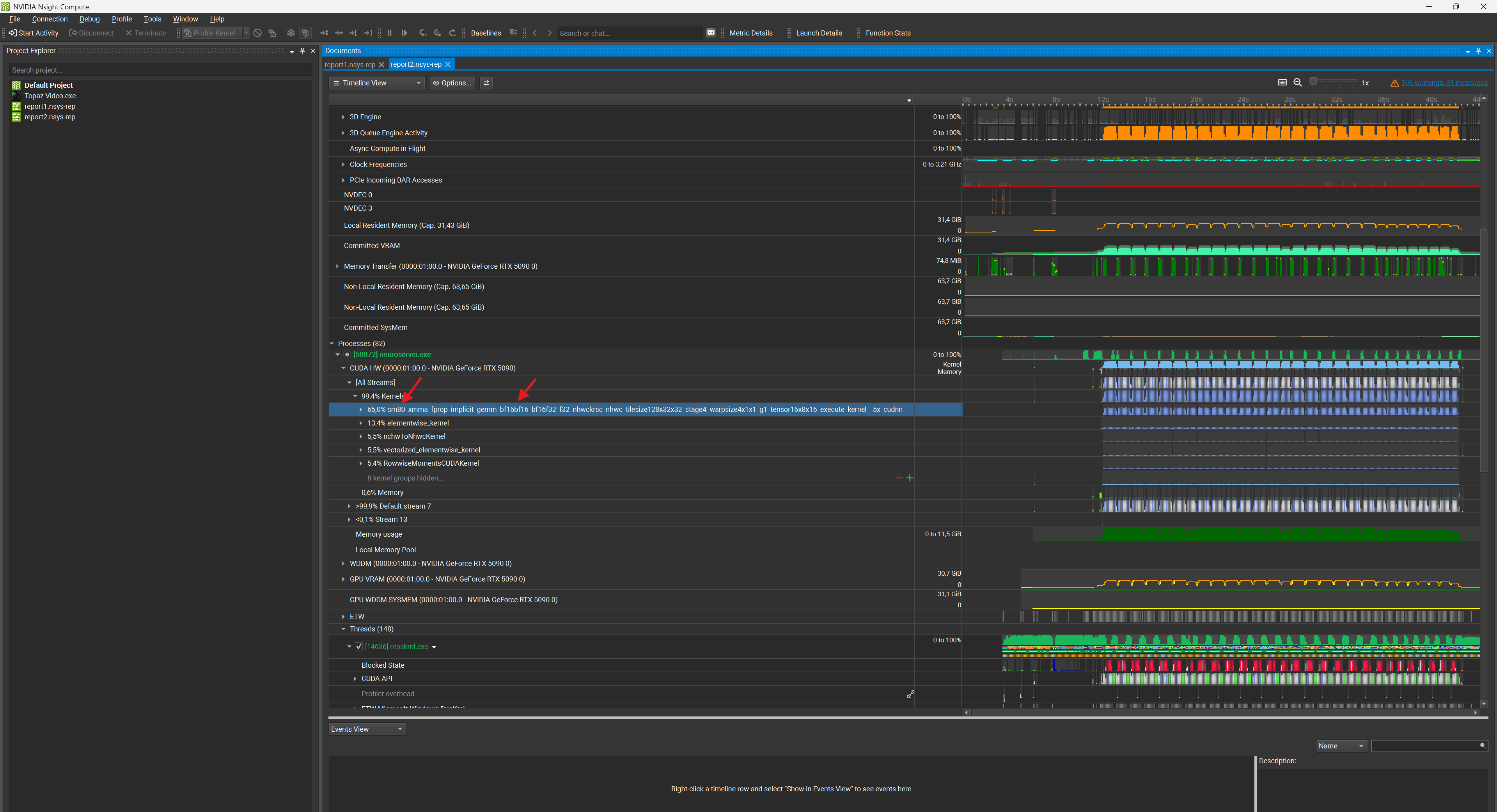

Topaz SL Precise + RTX 5090 = SM80 (Ampere) + BF16
I discovered while running the Precise model is that on my 5090 it’s using an Ampere series SM80 and BF16. There could be an option for FP8 and even FP4 for the 5090, which would greatly speed things up. I couldn’t see it for the other models because they were disabled after I reinstalled.
