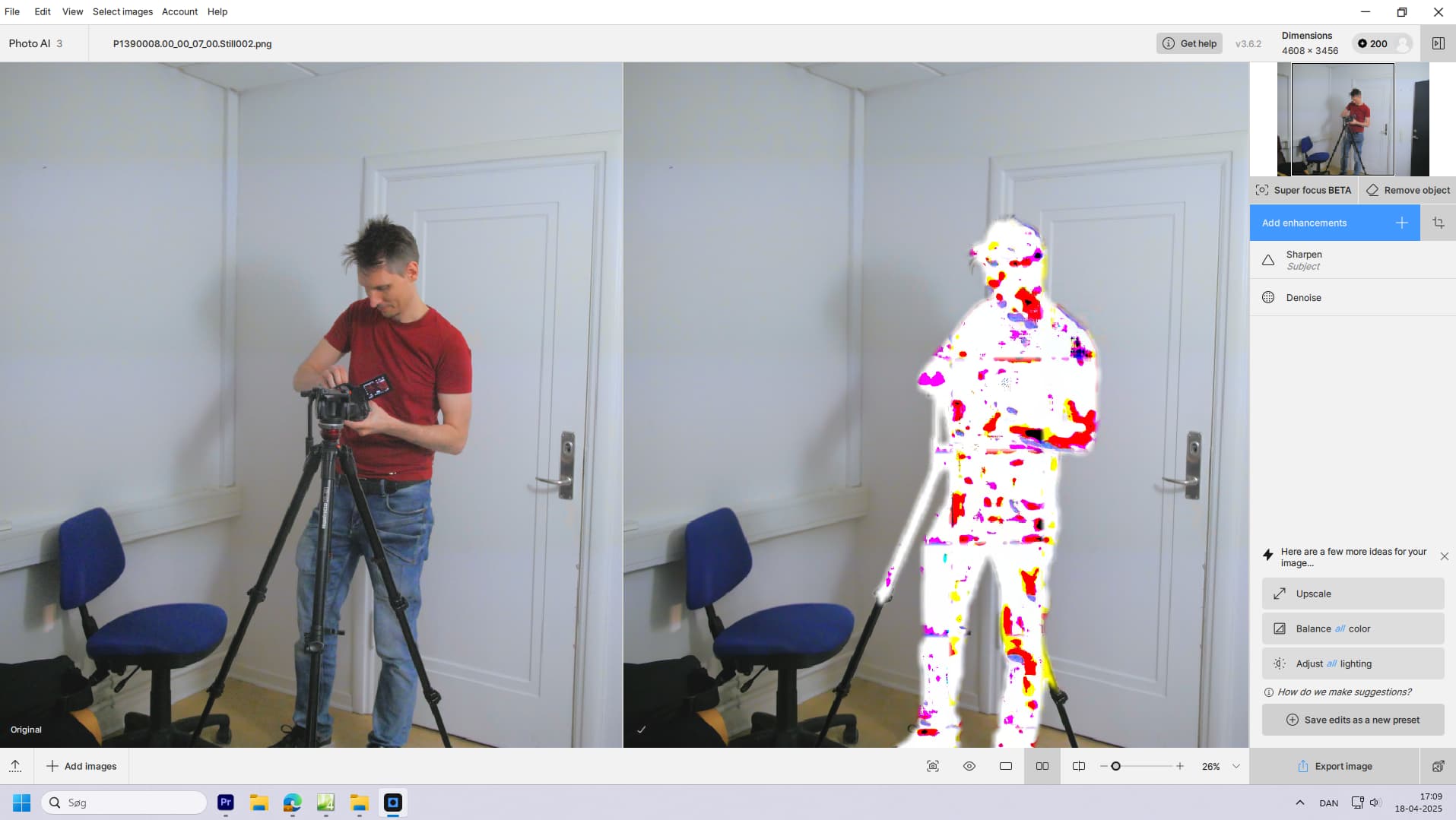

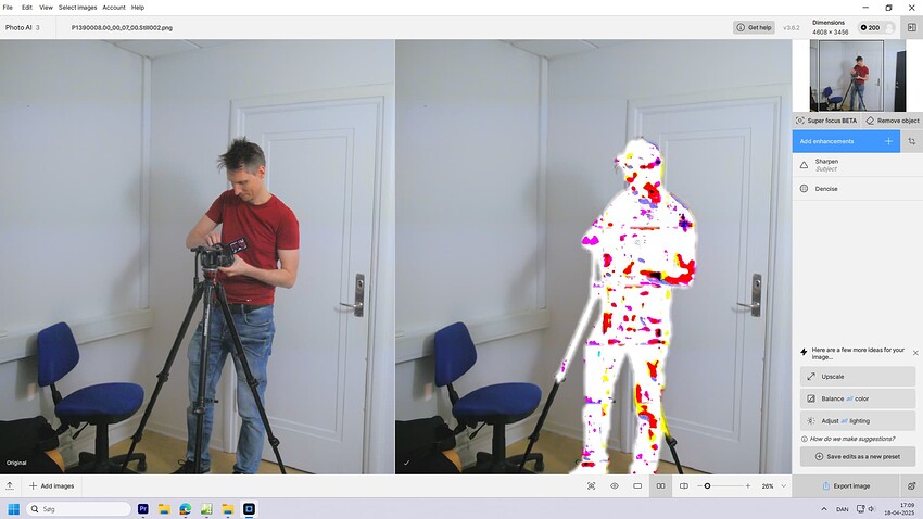

So this started happening as soon as I updated to 3.6
I was hoping it would be fixed quickly, but after the 3.6.2 update and it still occuring (every time), I’m getting a little annoyed.
It happens whenever I use sharpen and denoise on the same picture. The order of the filters doesn’t matter, and it happens both with png and jpg (or jpeg) images. I don’t use other formats.
I just checked and it happens every time I use sharpen. No matter what. I feel like sharpen worked in 3.6 but it only did this when sharpen AND denoise was added together, but maybe I remember wrong.
@mr.mart - yes most likely this is because you have the new RTX 5000 series graphic cards, that will have issues with the specific NVIDIA Standard AI model. Referenced here as a known issue that the development team is working on! For now, use Sharpen Strong, which you can force as the default model to be used in Edit > Preferences. Our development team is looking into the issue with Standard and we will circle back here once resolved!
