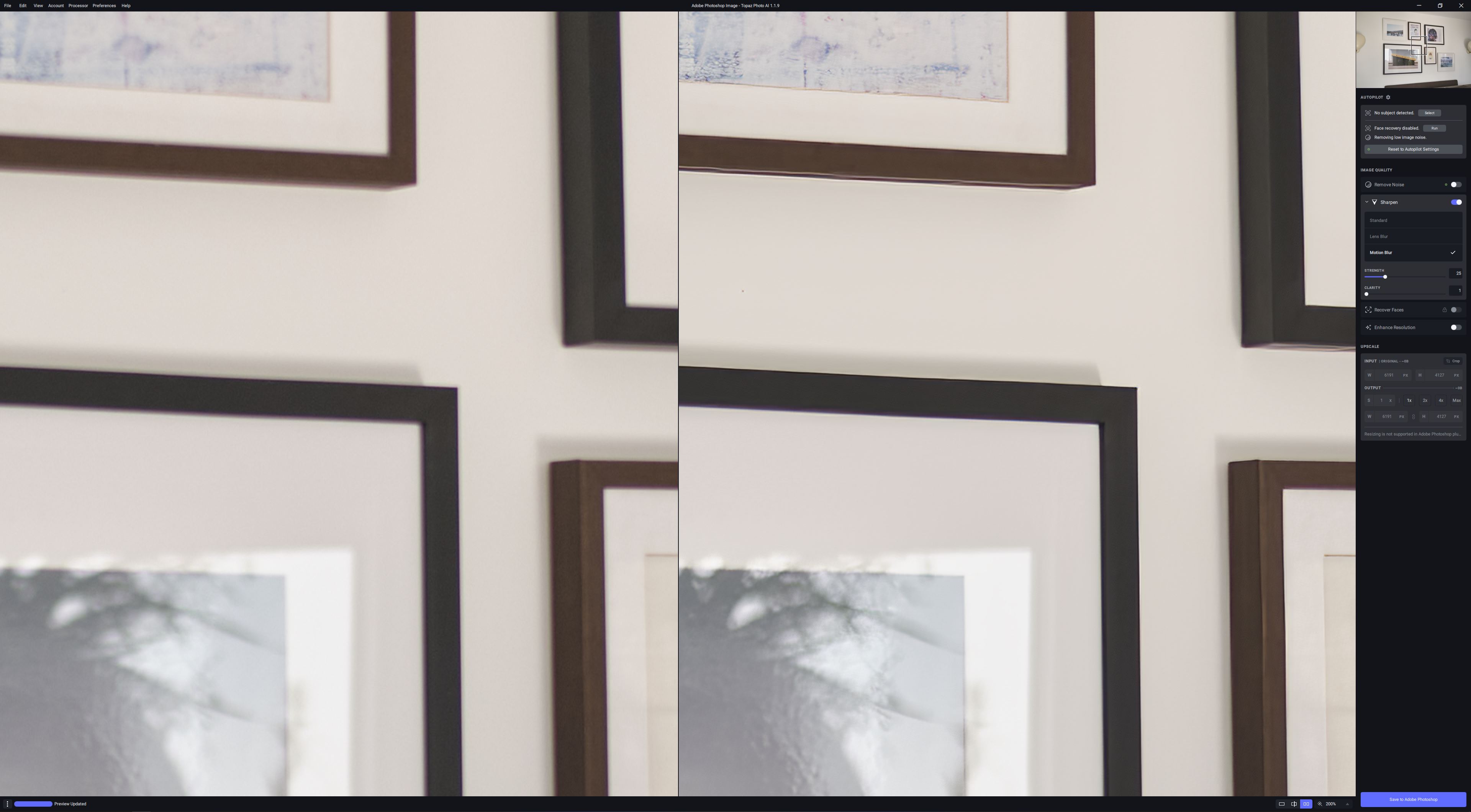

Gigapixel’s new model have superior detail retention at x2 enlargement compared to
the current Photo Ai’s enlargement at x2. No noise reduction was used on either program.

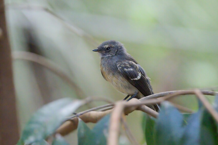

I’m Using Lightroom Classic as my photo editor and exporting TIFF to Photo AI - and to Sharpen AI for this post.
Background:
I have an ISO 10,000 RAW (Nikon HE*) file
(all files here converted to JPeg for ease of viewing)
Edited in Sharpen AI - for noise only in this example, I can adjust noise and still retain detail in the feathers:

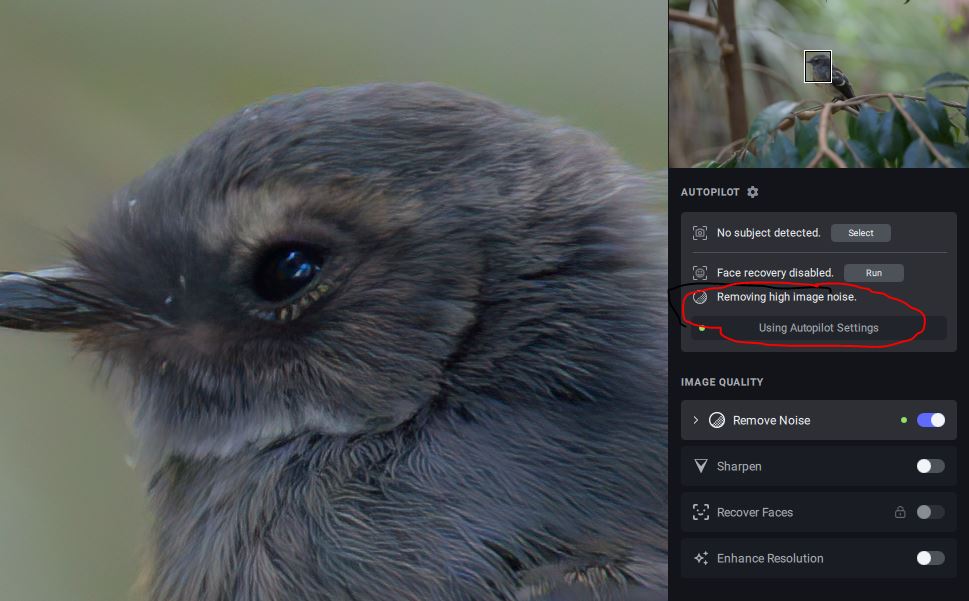

Edited in Photo AI - Autopilot adds noise reduction - I have no way of reducing the level of denoise.
All other Autopilot settings are off - this is what Autopilot is doing:
The level of Denoise is too strong - detail in the feathers is lost.
It would be great if Denoise can be turned off in Autopilot and adjustments using the sliders is allowed.
Many thanks :slight_smile:
I see what you’re saying about losing detail (at the very least, the feathers are softer than they could be - the eye too; which is critical for wildlife photography).
What happens when you run that same image (where you’ve circled “Removing high image noise” in the Settings Panel) & get the result you’ve included a zoomed in result of above - if you go down to the little arrow pointing to “Remove Noise” & you click on that to expand the Settings for Remove Noise. You should be able to manually make your own modifications to the A.P.-selected denoise settings. Are you able to do that? If so - is there enough buffer room on the denoise slider to lessen the amt of denoising somewhat & perhaps pull up the detail or clarity a bit in that same Remove Noise part of the settings panel? Does that help you at all?

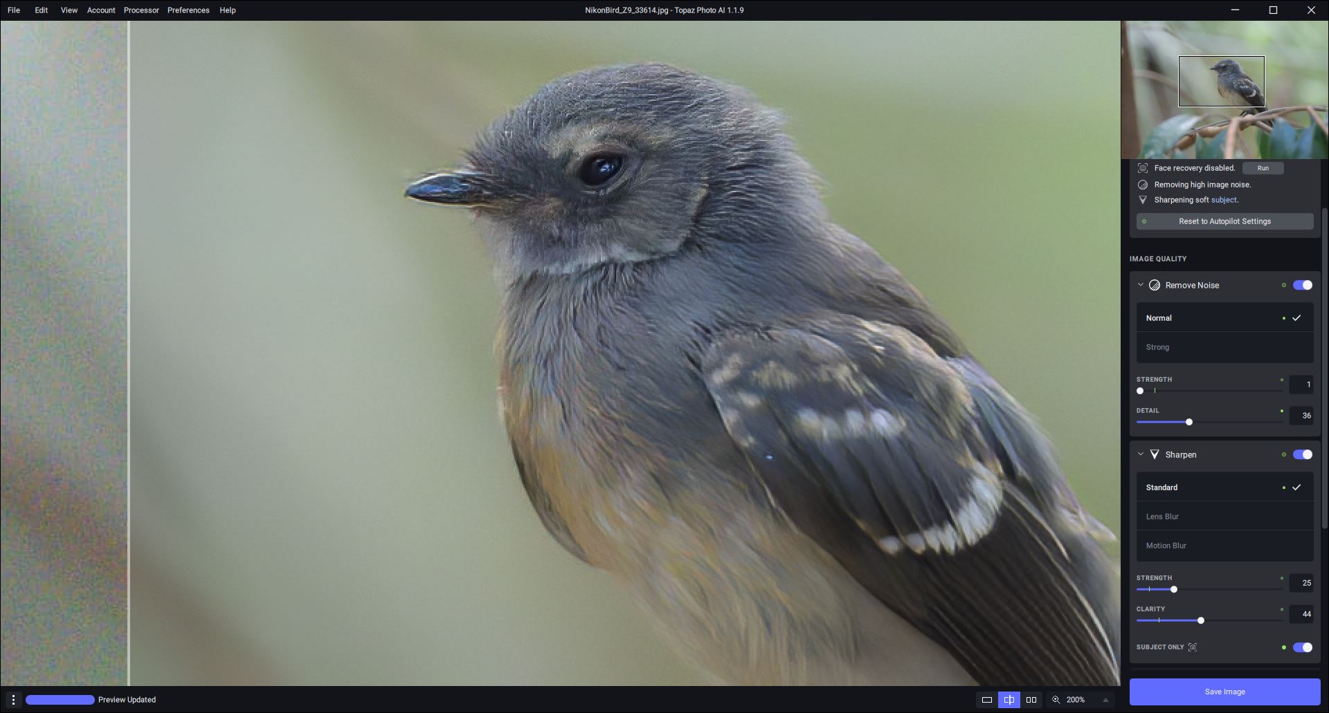

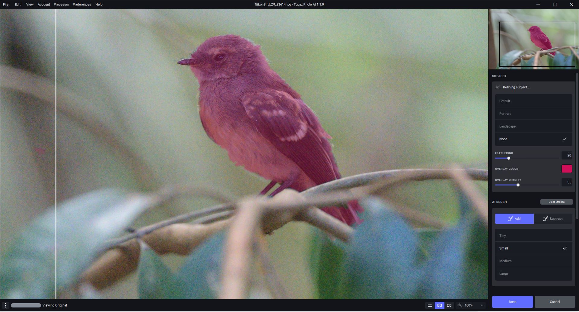

Here are some screen snips showing what I was talking about - I’ve zoomed in to 200%, so if you’re at a more normal viewing zoom level it may look better. You’ll have to play with settings to see if you can achieve what suits your taste.
Denoise & Sharpen Settings Panels Expanded to show Manual Settings:

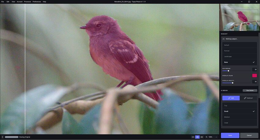

Manual Masking of Just the Bird (from the Select Subject part of the Settings Panel - I’m not a fan of the AI ‘brush’, but that’s neither here nor there):
The bird with the Sharpen Subject Only switch turned on (so just the masked - ie, red overlay - area of the image gets sharpened).

Sorry, I should have expanded that panel - the strength slider has been reduced to 1 on this image, the auto setting was around 11 I think, but even at 1 it’s too strong.
