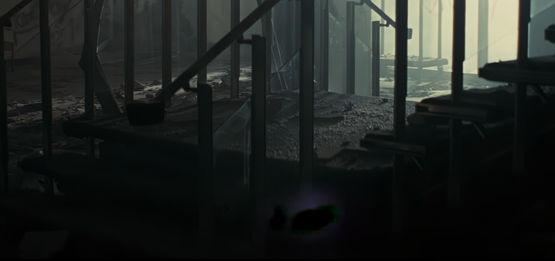

Proteus 3 black splotche blotting

Ive had the same issue when upscaling 1080 to 4k with the proteus model but it varies per instance. When I reset the program, it sometimes goes away. But will occur in other areas. Not sure why… Has there been an update to this? Im using the latest version.
A bit late to (revisit) the party, but has this finally been resolved for v3 yet? It only occurs for me when upscaling, say, 1920x800p to 4k, and then with ‘crop to fill.’ Especially since the latter takes ages. If not, then it’s high time this bug be squashed! (at 5.4 now).

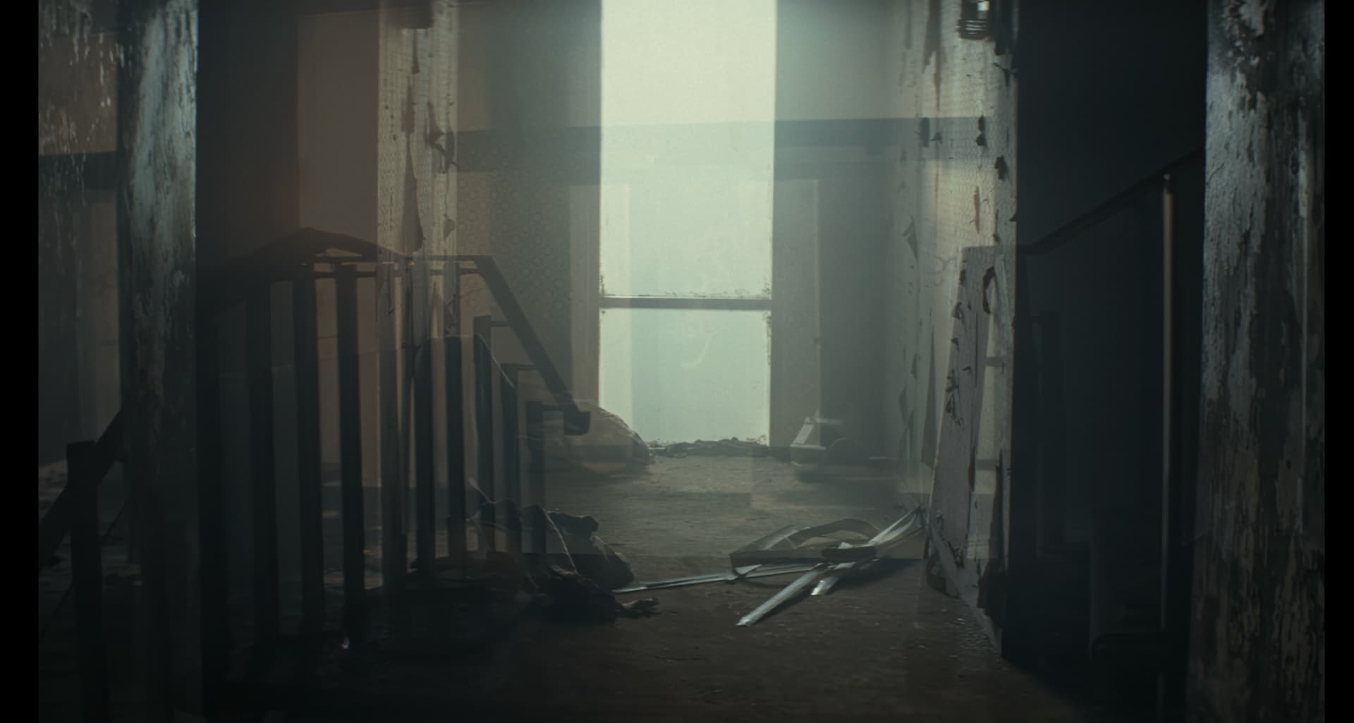

And TVAI wasted, yet again, 1 full day of my time:
Whooooa!
Is this real? Can’t be. Topaz, and some users, claim that Proteus is the go-to general model. How long was your process time, resolution and parameter settings?
Oh, it be real. My parameters are in the exact post I made above: Proteus 3 black splotche blotting - #73 by meimeiriver
And the issue only occurs with ‘Crop to fill’ (source was getting cropped to 1920x816p).
Oops, I did missed that, meimeiriver.
Wow! Sorry for your valuable time seems wasted, meimeiriver, but I promise, all is not lost because it did directed me. Thank you.

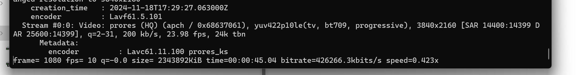

Maybe indeed not. :pray: After carefully examining how cropping is done, I realized cropping a source to 816p does NOT automagically crop the sides off (which it absolutely needs to do, as those sides will inevitably be lost on upscaling to 4k). So, I added an x-value for the pre-crop (see below). These values may not be entirely correct yet, as TVAI seems to use a 4px (overscan?) area I can’t quite place. But the black blotches are gone, and fps has doubled again. :slight_smile: (See below)
ffmpeg “-hide_banner” “-i” “F:/jobs/repo-00.01.16.497-00.02.09.085.mkv” “-sws_flags” “spline+accurate_rnd+full_chroma_int” “-filter_complex” "crop=w=1920:h=816:x=234:y=132,tvai_up=model=prob-3:scale=0:w=1452:h=816:preblur=0:noise=0.32:details=0:halo=0:blur=0:compression=0.18:estimate=8:blend=0.2:grain=0.01:gsize=2:device=0:vram=1:instances=1,scale=w=3840:h=2160:flags=lanczos:threads=0:force_original_aspect_ratio=increase,crop=3840:2160" “-fflags” “+flush_packets” “-c:v” “prores_ks” “-profile:v” “3” “-vendor” “apl0” “-quant_mat” “hq” “-bits_per_mb” “1350” “-pix_fmt” “yuv422p10le” “-an” “-map_metadata” “0” “-map_metadata:s:v” “0:s:v” “-movflags” “use_metadata_tags+write_colr” “-bf” “0” “-metadata” “videoai=Enhanced using prob-3; mode: relative to auto; revert compression at 18; recover details at 0; sharpen at 0; reduce noise at 32; dehalo at 0; anti-alias/deblur at 0; focus fix Off; and recover original detail at 20. Changed resolution to 3840x2160” “H:\veai/repo_560787555.mov”

EDIT: I underestimated the fps increase. :slight_smile: It went from a measely 2.2fp to 10!
Which just goes to show to what absurd sizes TVAI must be upscaling the cropped source first (which, by all logic, should ere go faster).
