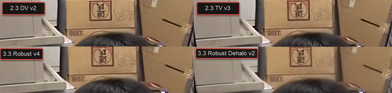

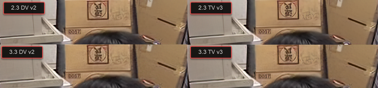

Anyway, I make a png output then and still 2.3 output is clearly better than 3.3.3 with the same models:
Now 2.3 Dione DV v2 and Dione TV v3 compared to 3.3.3 Dione Dehalo v2 and 3.3.3 Dione Tv v4:
And 2.3 Dione DV v2 and Dione TV v3 compared to 3.3.3 Robust v4 and Robust Dehalo v2:
all these are captured from the png output, not the preview inside VEAI or TVAI.

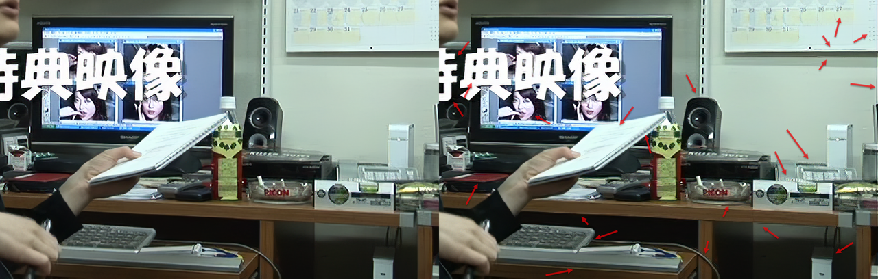

Here is another similar source: 720 x 480 interlaced. Dione 2x DV v3 in both 2.6.4 (left) and 3.3.5 (right): image.png
And here is the source. Full frame and 53 seconds: Topaz Interpolated Source and Comp.zip - Google Drive
Every single detail is worse in 3.x. It even has a lot more noticeable halos around the hands.

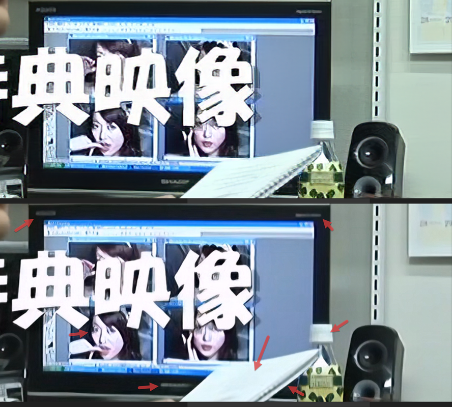

Many parts look cleaner and smoother (and warmer tones) and many details are just gone, but I assume that is also due to the HVC1 compression, which is not good for a true comparision. Can you export to PNG or any other lossless output in the future? exact frame is 244,59.94, at time 00:00:04.071
2.6.4 Top - Hybrid+3.3.6 Bottom
Look at the monitor frame letters. In Hybrid+3.3.6 is just a blur. Same with the notebook. All the detail is gone: no lines in the page and the spine is also a blurry mess.
