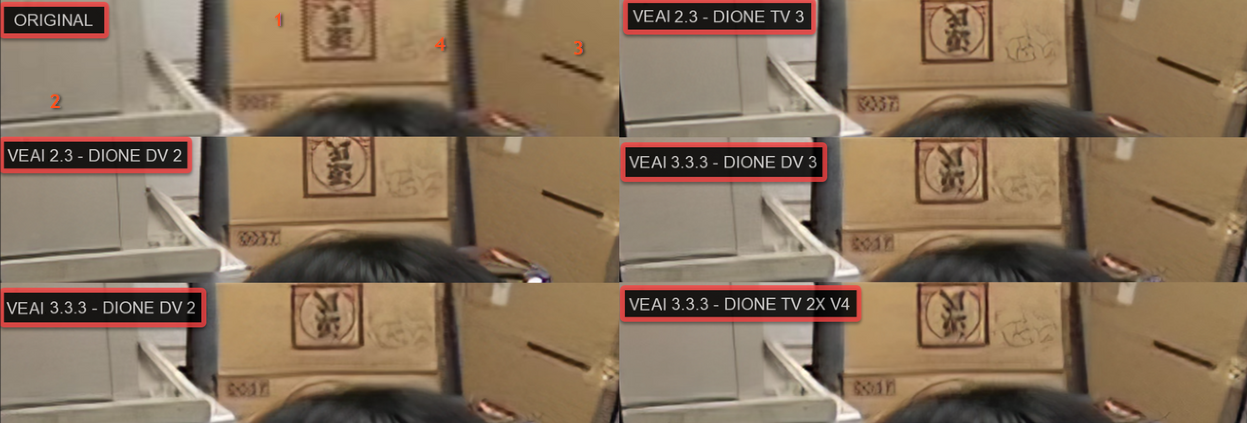

Whis is Topaz Video 3.x quality so BAD compared to 2.3? šŸ¤¦šŸ»
Check this comparision:
Original is a 720x480 progressive interlaced DVD rip.
Both Dione DV and Dione TV in VEAI 2.3 offer a pretty good quality and output a smooth 59.94 fps video.
Meanwhile, Video AI 3.3.3 using the same 2.3 models look a lot worse, like it’s missing half the resolution, the new IRIS model is a blurry pixelated mess and even the ā€˜Interlaced Progressive’ models, which output just 29.97 fps look much worse than VEAI 2.3 doing a 59.94 fps output… :person_facepalming:t2:
How can the quality be so backwards after so many years and updates??

Here’s a new comp sheet with only Dione models and 2x resolution, and what I think are the most interesting points: https://i.postimg.cc/RVRnZc5p/Comparision-Dione-x2.png
  1. The logo in the box: One part is the kanji letter in the center, which is clearly well preserved in 2.3 with both Dione DV and Dione TV and totally botched in 3.3.3.
    And the other important aspect is the shapes surrounding the kanji, the circle inside a square, with some lines in the upper area. Those 3 elements are also clearly a lot worse in 3.3.3 than in 2.3: The circle doesn’t maintain its shape (specially on the right side), the square shape is blurred and its corners fuzzy and almost disconnected.
    The horizontal lines in the upper part are almost totally lost in 3.3.3, as if only half of the image was processed.

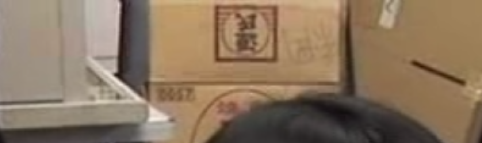

    For further reference: here’s what this looks like in another part of the video where the camera is static, so there is no interlaced lines: https://i.postimg.cc/gzChSzHs/image.png
  2. Black line between light gray: straight with the shape well preserved in both 2.3 models, totally ā€œhalf resā€ looking in 3.3.3
  3. Black strip on the cardboard box: clean and perfectly antialiased in 2.3… pixelated, blurred and showing halos in 3.3.3
  4. Dark area between boxes and boxes edges: clean and uniform with straight edges in 2.3. Noise and blurred edges in 3.3.3
Also worth noting is that I always liked a lot how VEAI 2.x could output a very smooth 59.94 fps video file from an interlaced source, thus improving not only the resolution and quality of the image, but also the motion smoothness.
Now in 3.3.x even the options that don’t smooth the motion and duplicate the fps look much worse…

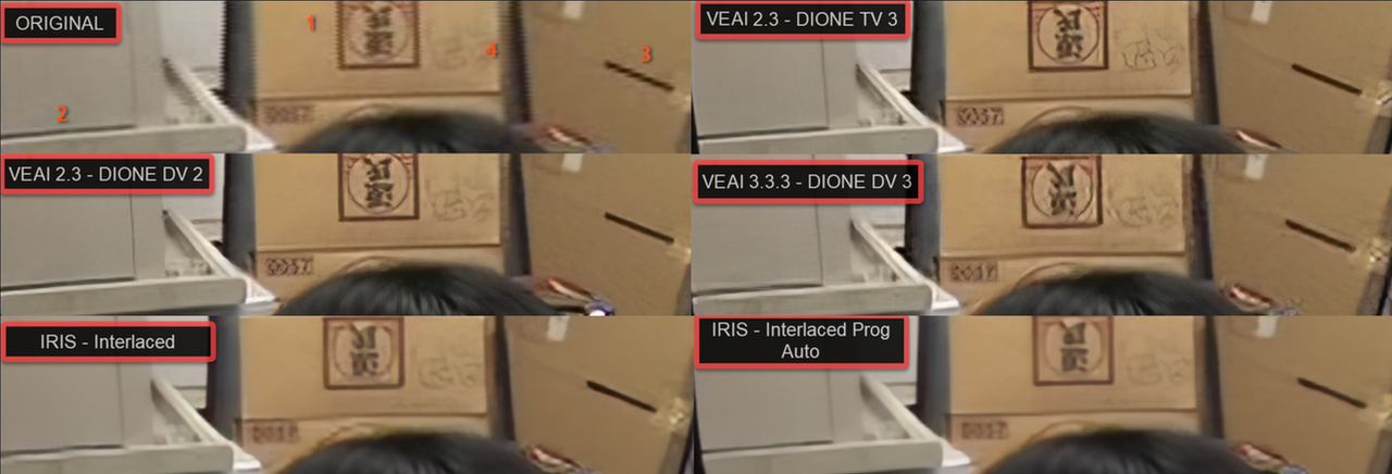

And then IRIS: https://i.postimg.cc/k4Qghm7Y/Comparision-IRIS-x2.png
which is blurry and pixelated ā€œhalf resā€ looking in ā€˜Interlaced’ mode or just totally blurry in ā€˜Interlaced Progressive’ mode; both losing all the fine details, as in the logo.

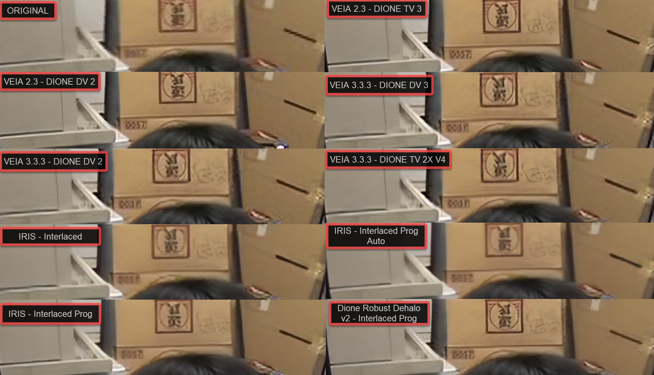

Here’s a capture of my output which was a 480p to 1080p upscale in three Dione models from TVAI 3.3.4 and exported in ProRes:
Looking a bit different to yours.
