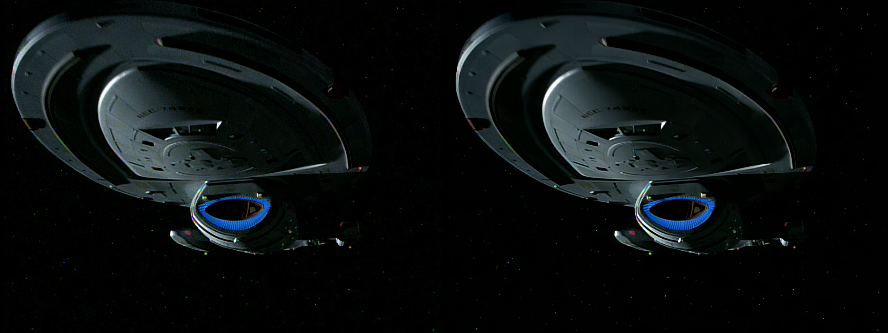

I don’t have a lot of CG in the current episode I am doing, but this is a side by side comparison with GaiaCG post 1.7 (run just now in 2.2) and GaiaCG in 1.5.3. The current GaiaCG is on the left of this image.
The difference is more stark in many other scenes as well. The original GaiaCG was designed for CG content and it did wonders with some of this content the other models can’t match. However, I guess that the usage for this model was low enough that they didn’t bother to try to fix the issue with the engine change as most probably didn’t use it much. It was not really useful for enhancing faces - which is probably a large factor in which models get selected.
That doesn’t mean the model as it is now can’t be used, but it is not remotely close to what it was originally being used for and the outputs are not compareable anymore. The only way to get that same CG output that works wonders in some content is to go back to an older version that has it.

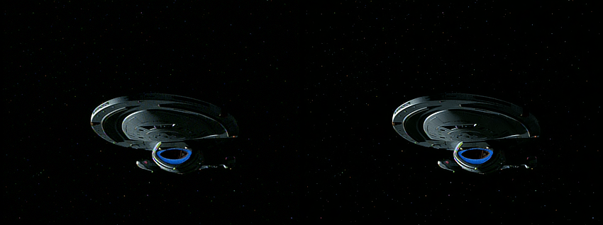

Second one for reference:
I am quite familiar with the older Gaia CG version. In some ways, it was similar to what Artemis MQ and LQ do currently, except it also added a level of shading detail that made things look more real and 3 dimensional. In comparison, Artemis denoises and sharpens, but the results look flat and lack realism. The new Gaia CG v5 doesn’t compare to either in any practical way.

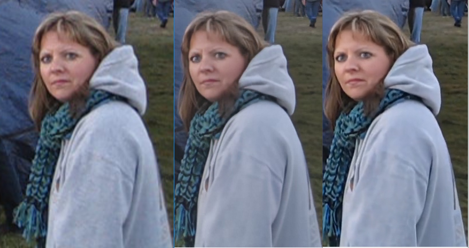

I do a lot of upscaling using Artemis LQv12 typically at 200%. Recently I happened to do one at 400% and my impression was that it was better, so I just did this experiment.
The source is 640x480 from 2010. Left is the original zoomed 200% in the viewer (MPC-HC). Middle is the v12 2x output. Right is the v12 4x output, downsized 50% using avisynth spline64resize. The whole image (a cropped portion of the original) capture was then enlarged 2x to make the difference most apparent.

The problem with LQ in either case is it eliminated the texture of her hoodie and turned her face into a wax mannequin. If you disregard those idiosyncrasies, then it’s alright. :blush:
Hmm, wondering why you can’t do it yourself?

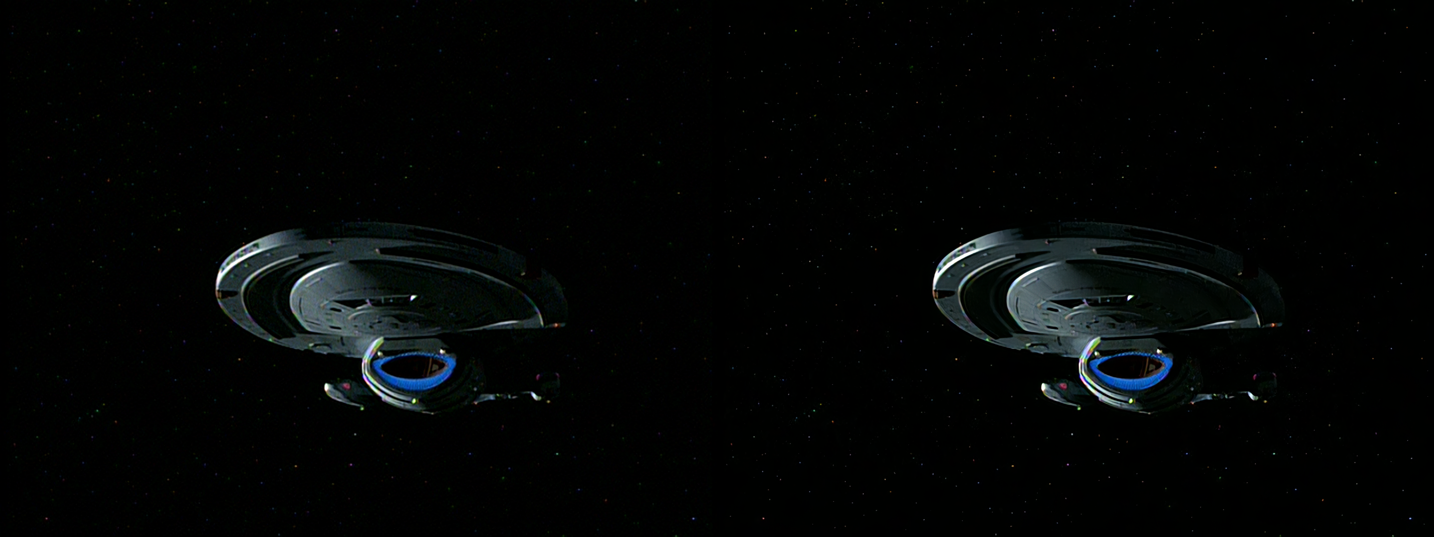

Probably not the best video for this purpose, but here you go:
