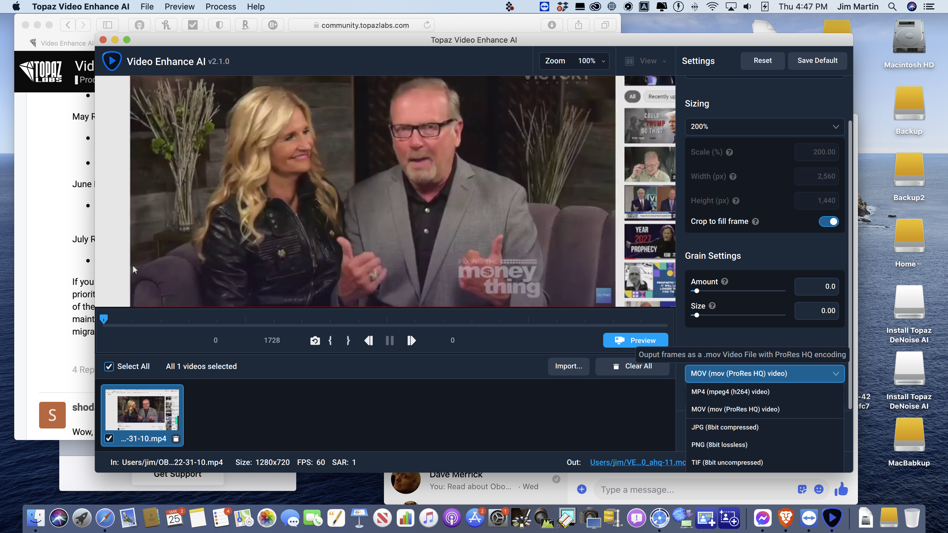

Video Format dropdown should no longer clip at the bottom of the screen when the window height is small

Playback toolbar has been overhauled to be more flexible, fully functional, and easy to use
More preview modes: Choose between single view, split view, and side-by-side view

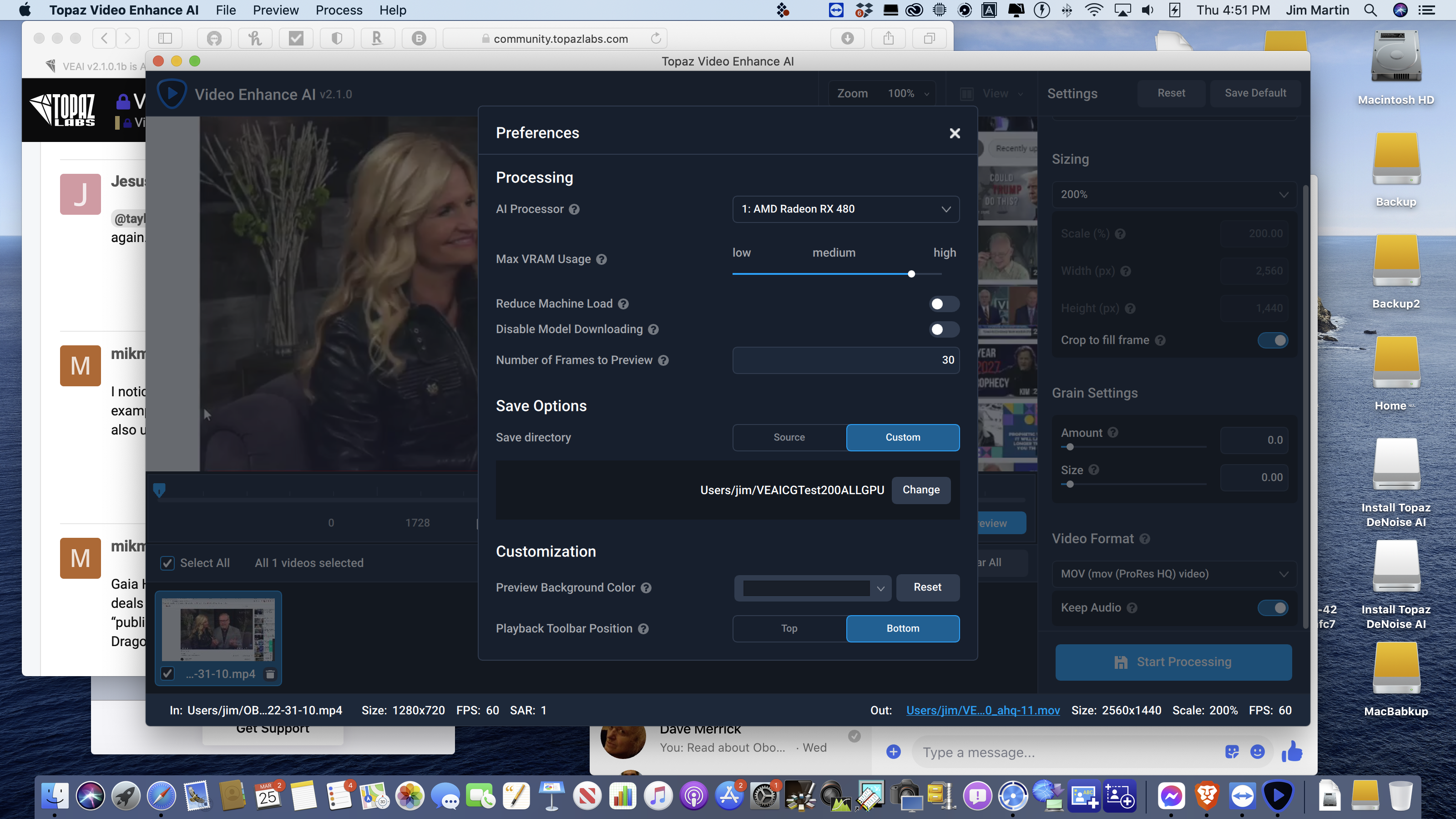

Added ability to change the number of previewed frames in Preferences
Added ability to change the preview panel’s background color, chooseable from Preferences
Added ability to change the video playback toolbar’s docked position to above or below the preview panel

Preferences dialog now shows a confirmation icon when a setting has been updated
