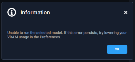

it seems that dione tv v3 cant be run on older cards, even lowering vram

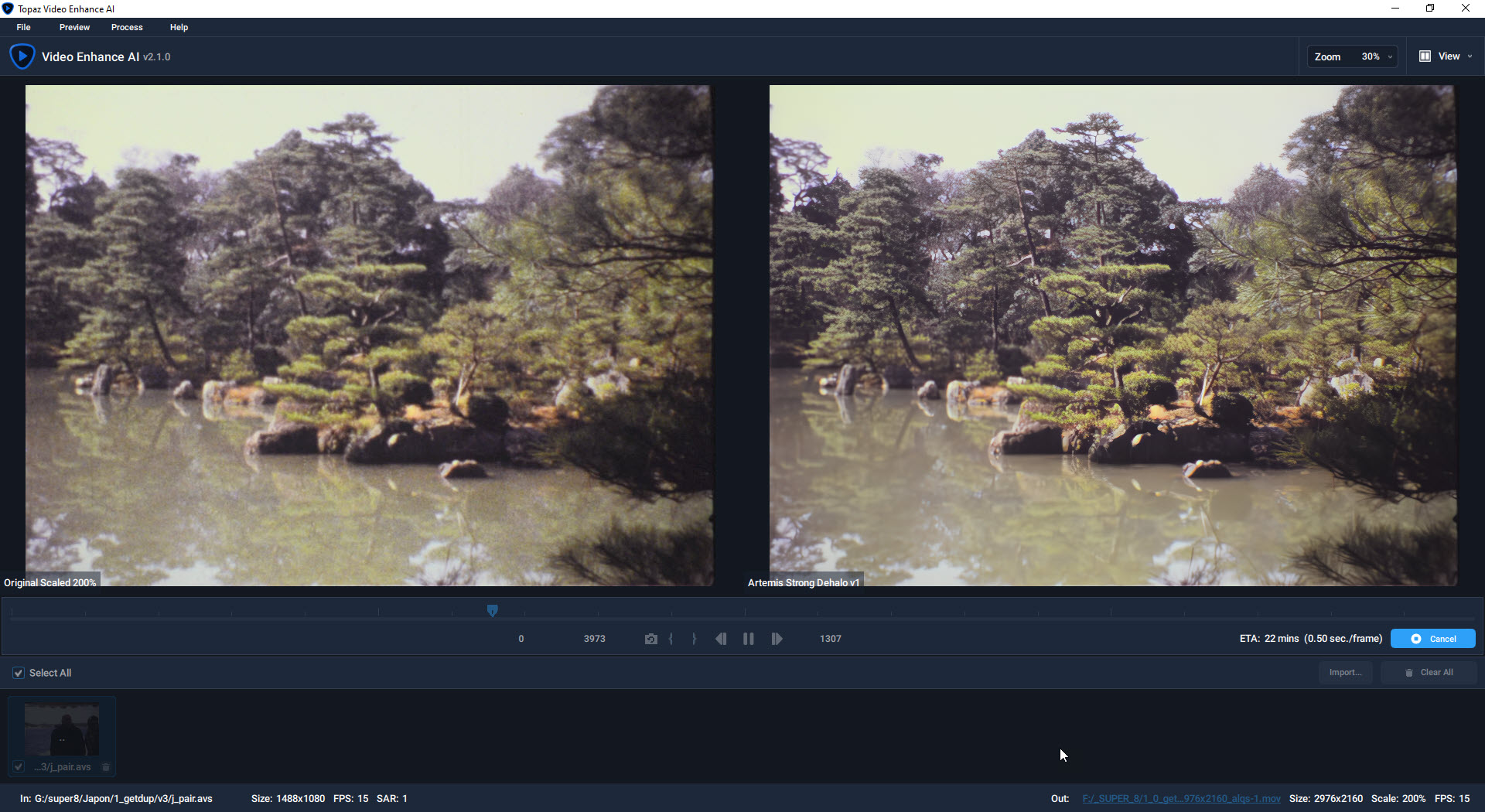

Here a Super 8 clip from 1964, filmed by an amateur camera and a correct lens but not an Angenieux …
The film has a very coarse grain (Kodachrome 25 from memory) and it becomes very difficult to keep all the details and cleaning in preparation for an edit.
The Artemis Strong Dehalo V1 model managed to do this straight away even at 200% retaining all the details. Even better than AMQ / ALQ : depend the source

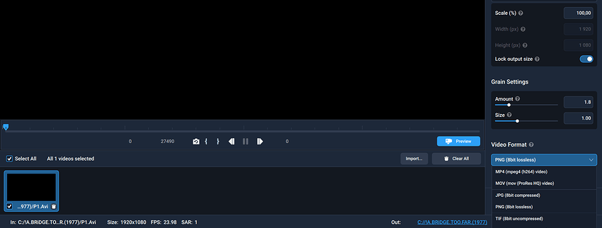

Strange… No Tiff 16bit uncompressed? It’s still an option in 2.1.0.1b…
@taylor.bishop No Tiff 16bit uncompressed as an option for output?
Is this option not showing up for you? Can you send me a screenshot of the Tiff 16bit uncompressed option missing from your interface?
None of the output format options should have changed in this update.

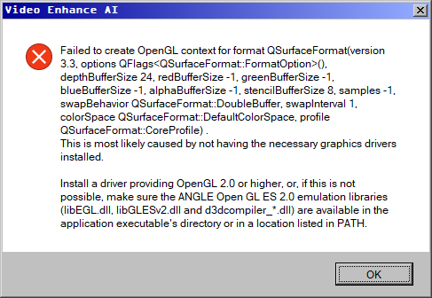

Starting with Video Enhance AI 2.1.0rc2, it no longer starts on a GPU-less machine without further user intervention. It throws this error:
veai_opengl32
So VEAI versions 2.1.0rc2 and above now need Mesa. This is the first time ever that VEAI needs intervention from the user regarding Mesa in order to run immediately after installing on a non-GPU machine.
There is a very old version of Mesa that the VEAI installer copies into the VEAI application directory as opengl32sw.dll. If it’s renamed to opengl32.dll, then VEAI will run.
The latest version of Mesa that I recommend is MinGW 20.3.4. Versions after that (so far) have unresolved issues. For Mesa version 20.3.4 (as well as other newer Mesa versions), both x64\opengl32.dll and x64\libglapi.dl need copied into the application directory.
I haven’t checked for sure what environment variables it needs… by default, Mesa runs OpenGL at 3.3, but I have mine set to 4.2. I haven’t tried deleting my environment variables and checking to see if VEAI runs OK without them.

Tiff 16bit uncompressed not showing up but it’s still here :+1: however not easy to see in a 1080p monitor because it’s the last option. I have to change my task bar settings to hide the task bar in desktop mode.
