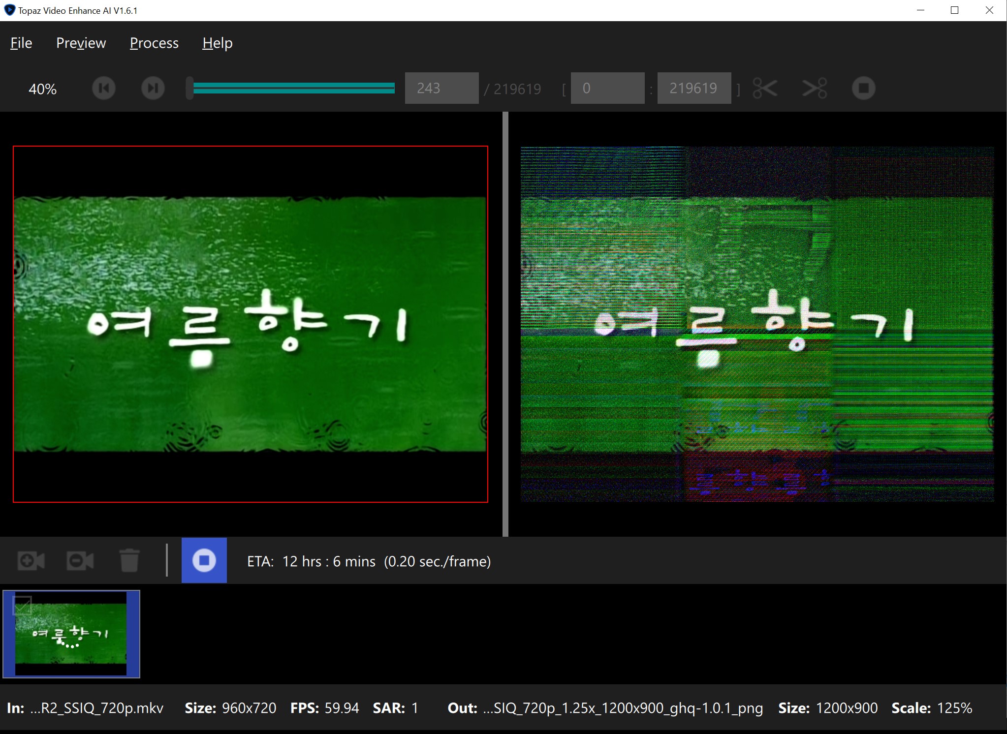

This is Video Enhance AI v1.6.1 on RTX 3080:
The initial run took over 30 min. to start! and after it starts the result output is scrambled and unusable!
The RTX 3000 series had been released for around a month now, is there any plan to make this work soon? I’m getting pretty promising time per frame though, it’s about 2x faster than RTX 2080 Ti!
