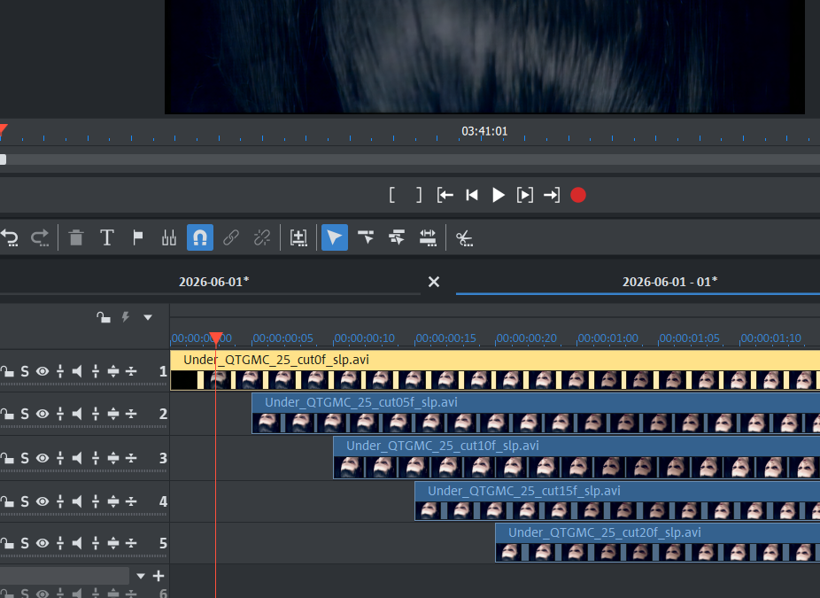

If the video clip has a static background (camera not moving), Starlight Precise sometimes creates visible ‘jumps’ in the background. For me, the “jump” occurred after about 25 frames. To hide these ‘jumps’, I am currently using the following method:
Create 4 copies of the original video sequence.
Then trim these copies at the beginning:
  • Remove 5 frames from the first copy
  • Remove 10 frames from the second copy
  • Remove 15 frames from the third copy
  • Remove 20 frames from the fourth copy
Then render all 5 files (including the untrimmed original file) with SLP. Due to the time offset, SLP seems to enhance each clip slightly differently; the results are not exactly identical.
Then overlay the 5 SLP results in a video editor (layer opacity from bottom to top: 100%, 50%, 33%, 25%, 20%) and make sure the clip ends are flush in the timeline so that all 5 clips are in sync. The beginning of the timeline should look like a staircase (due to the time offset of the 5 clips).
Afterward, I could no longer see any “jumps,” and overall the result was more realistic (smoother skin, less exaggerated, no overly sharp edges, etc.).
The only downside: It’s much more time-consuming and labor-intensive. But I find the result convincing, and depending on the project or scene, it could be worth the effort.

I used an FFmpeg script to trim 5, 10, 15, and 20 frames and create four separate videos. At the moment, I’m upscaling all 5 versions with SLP. I’ll also check whether the overlay can be done with CMD instead of in a video editor, as that would simplify the process.

SLP Anti-Jittering project finally finished! My computer was sweating for three days straight… and afterward, so was I. It is a SLP 4x upscale, no SLM used. The entire processing chain was done losslessly in FFV1, stacked all five upscales in my video editor on top of each other and set opacity.
The result: hell yeah, the five-layer blend-trick definitely works! The footage became smooth, with no more jittering! However, the amount of time required doing this is enormous—I’ll probably never do it again.

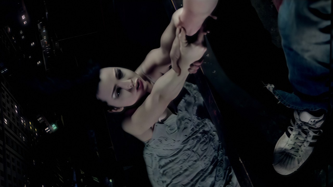

The overlay softened the SLP, which was exactly what I wanted. However, in this particular case it was still a little too “crispy,” so I used SmartBlur at a very low setting: smartblur=lr=0.7:ls=-0.12
I then imported it into Topaz and used Iris MQ as the finishing model (with Gaia as the second model), and added some grain. Unfortunately, YouTube killed most of the grain during re-encoding.
My FFV1 upscale looks better than on YouTube, but that was to be expected and my FFV1 is 4:2:2 10-Bit (converted, better grain), for Youtube i did 4:2:0 (in cases of compability).
The screenshots are taken from my original FFV1, so you can also see some grain there.

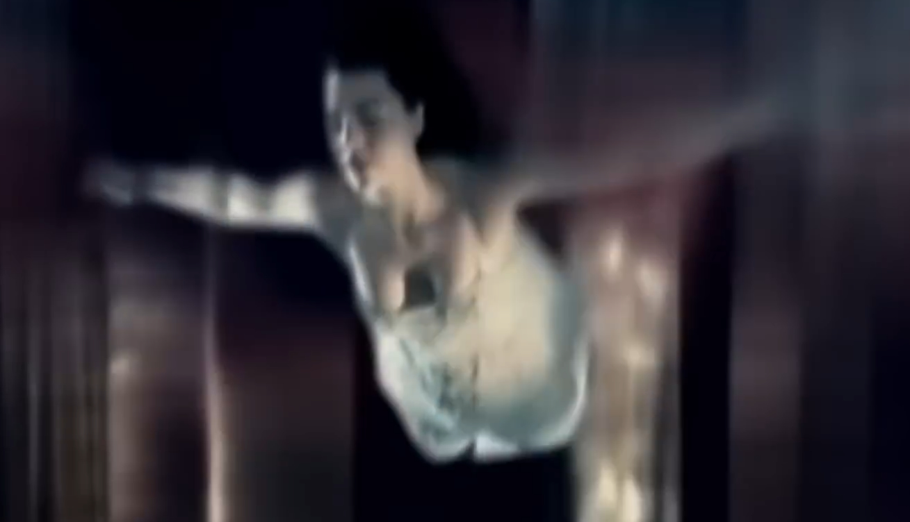

here is the official SD version, close to the DVD version (sure I used DVD source)

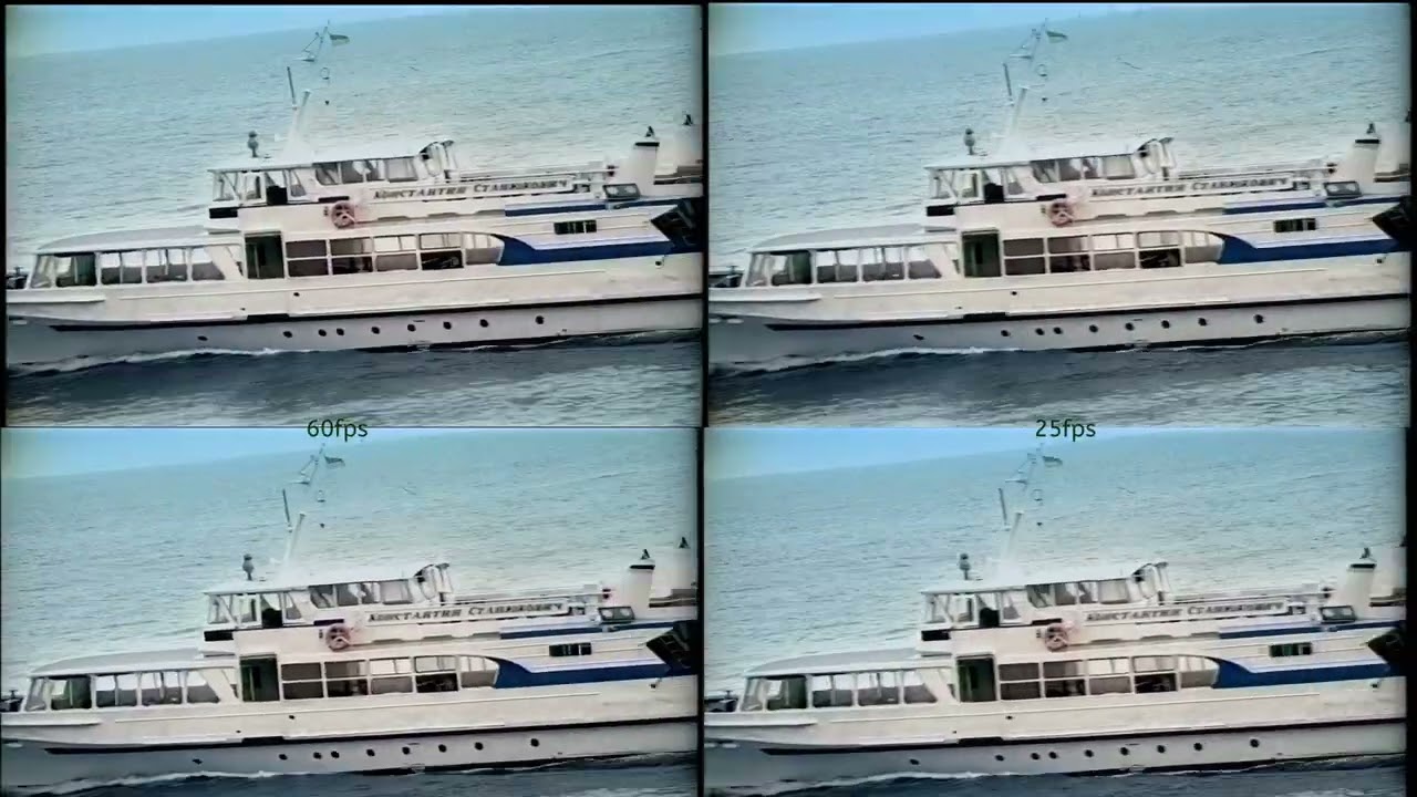

Why aren’t you using RIFE interpolation? It seems to work pretty well.

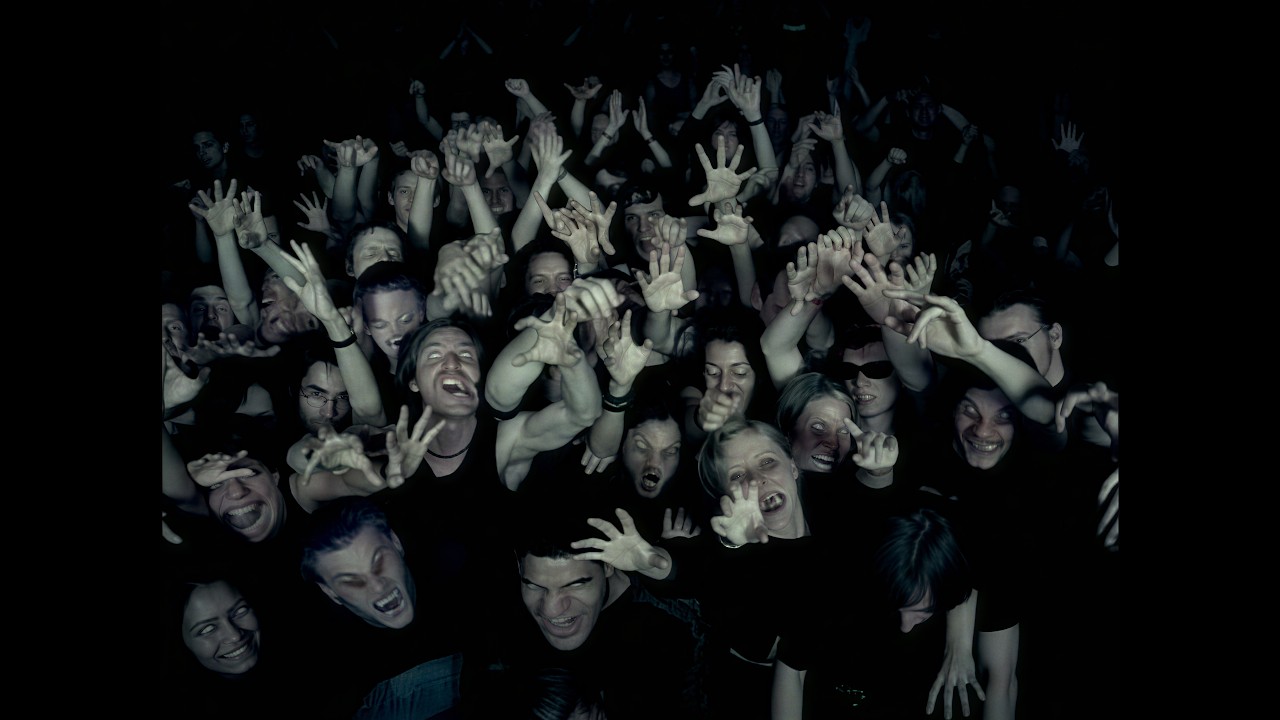

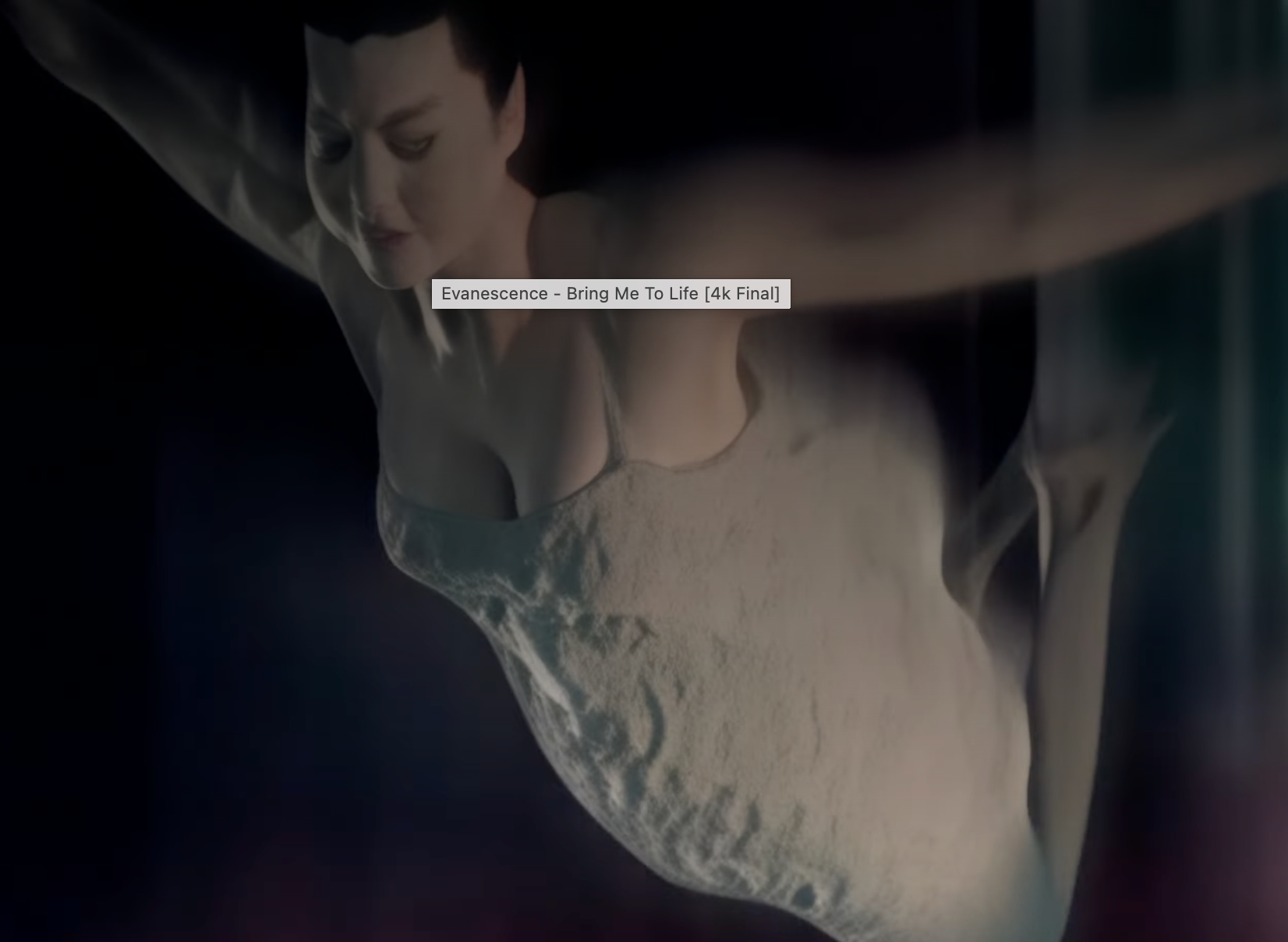

Still quite some monster faces which the starlight models (especially SLP but also SLM if it gets decent material by the previous SLP run) luckily do avoid most of the time.

Why would he? It would completely alter the look of the video from filmlook to videolook. And also introduce motion artifacts in high-motion scenes…
You know… Most music videos are shot/mastered in 24p/25p TOTALLY on purpose.

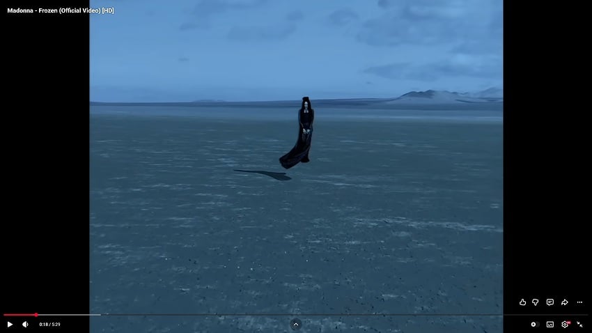

Previously the official Madonna channel posted an “upgraded” HD version of Frozen where she looks like a Dracula being in some shots… :stuck_out_tongue:
Great video production-wise, where they did stuff never seen before. But they should have put as much care into remastering it as when producing it originally… Kinda sloppy for something that “big”.
These 60fps look absolute trash.
Nope. But that is not high-motion video… Run that on the Evanescence video and I can show you plenty of artifacting. Algorithms skipping interpolation for processing they deem “too difficult to process properly” is also a type of artifacting…
I knwo what you mean but in this “dream” part monster faces exists also in the original (below), it’s not the same frame there are worser ones than this:
Iris MQ can sometimes cause slight face distortions (also Proteus Natural does!), but apart from this scene, all other faces—including small ones—look fine. In some cases, Iris MQ even improved faces. The Iris denoise made the skin look cleaner and less dirty, which SLP sometimes tends to do. It’s always a trade-off, but in this case I think Iris brought overall more benefits than drawbacks and creepy look fits in this dreaming szene, it’s just more pronounced than in the original
