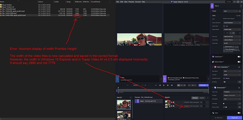

Error: Incorrect display of width Prioritze Height
The width of the video files is now calculated and saved in the correct format.
However, the width in Windows 10 Explorer and in Topaz Video AI v4.0.5 still displayed incorrectly.
No problems here, even on that nasty 5x setting.

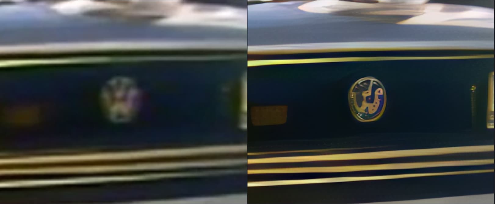

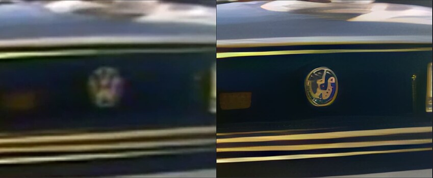

Is this done with Iris-V2 ?

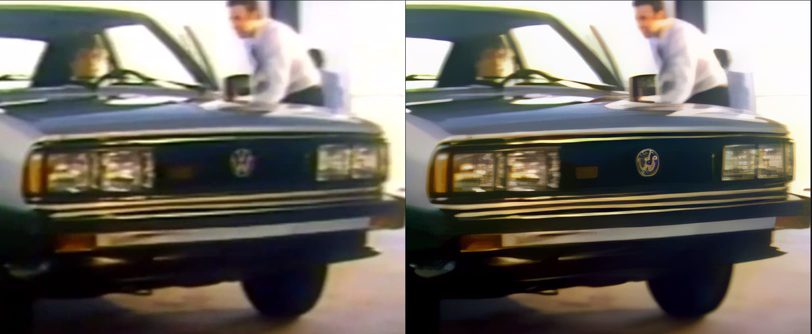

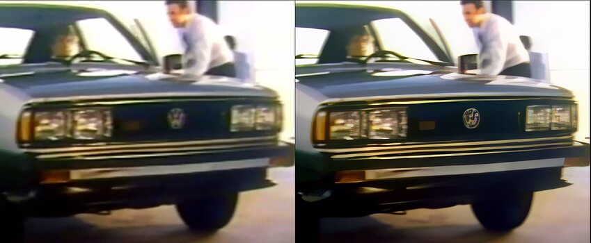

There are still alot of things to do with this KI:
-Preventing Alien Faces…double Eyes or teeth…sometimes letters or wrong letters when they definitely look different…like here the VW-Logo looking like Loch Ness Monster “Nessie”.
In this case you have to choose a different KI…and Iris-V2 can´t be used for official production purposes…changing to other KI´s in different scene is still not possible…but other things like “Addons” no one asked for…also the “Live Preview” is still waiting to be back…
But Iris-V2 is giving the most visual improvent at this time but can only be choosen for private purposes where no other would ask…why are there suddenly those Alien Faces or the other things like weird looking checkered T-Shirt wobbling.
It seems we are still at the beginning of KI and we have to wait for a better Iris maybe Iris-V3 that is under current development(i hope).
