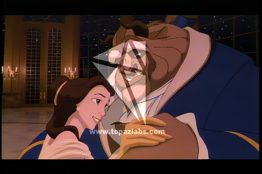

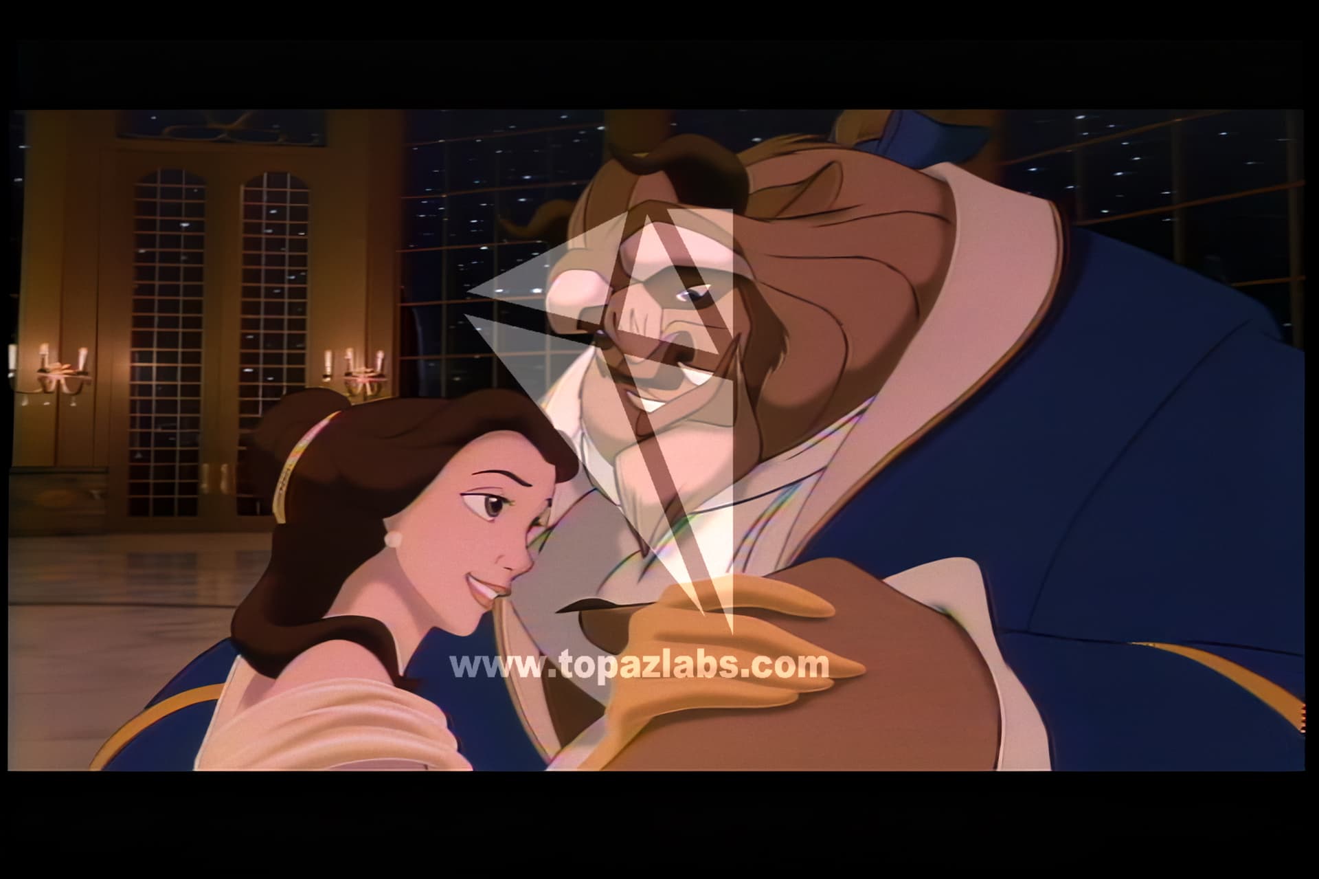

The Inverse Telecine is still not working.
Looks like It is not inverting the 3:2 Pulldown and just converts the frame rate from 29.976fps to 23.976fps then applies a Bob or Interpolate deinterlace method after, instead of actually bringing back the original frames.
Please take a look at the difference in the images I uploaded from upscaling a telecined Laserdisc source using Proteus.
Image 1:
I properly reversed the Telecine/3:2 Pulldown with another software before adding it to TVAI. See how the lines are clean!
Image 2:
I loaded the Telecined footage directly into TVAI. Now see the jagged edges on her face and his shirt collar on the same frame of the movie using the TVAI telecine checkbox!
There should not be any jagged edges with IVCT.
Inverse Telecine/3:2 pulldown is supposed to literally INVERSE the telecined film to bring back the original frames from the filler fields.
