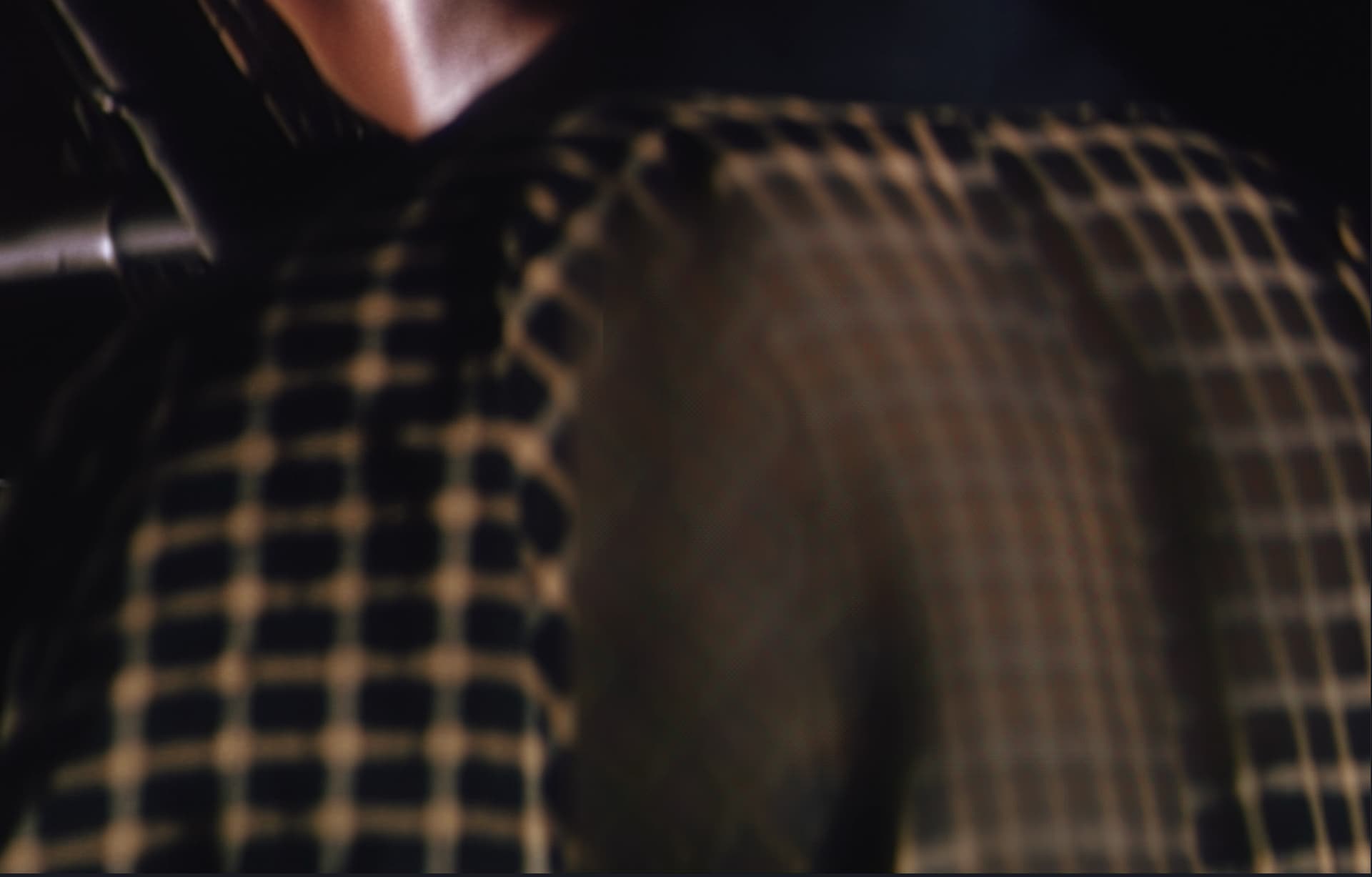

Chronos does not cope with such scenes at all, blurring details.
But it doesn’t make such brightened squares.
ChronosFastV3
