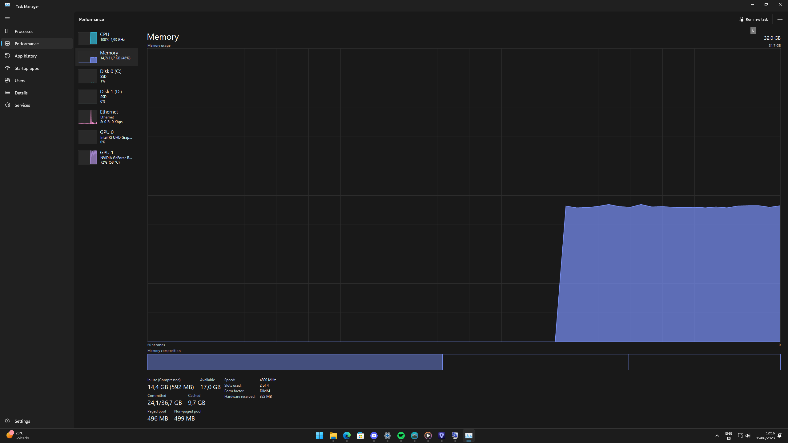

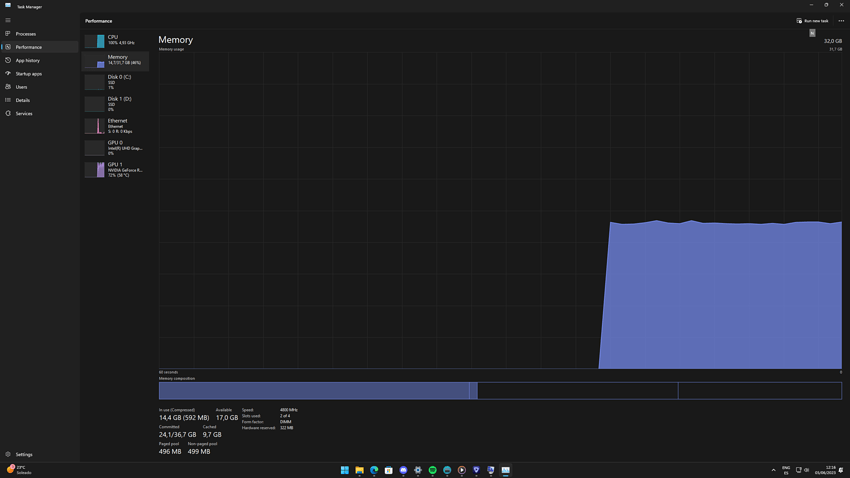

What are you talking about? This is the performance monitor while doing the same process again.
That’s why I made sure to set the temp folder in the same place as the output video location, in case that ā€œwill make a bottleneckā€.
Interesting. By your performance monitor, the bottle neck probably happens in your CPU. It also seems that your system has a very good balance since you can output 78% of your GPU without things piling up in your RAM and SSD. I’m not sure what you could change to squeeze more performance.

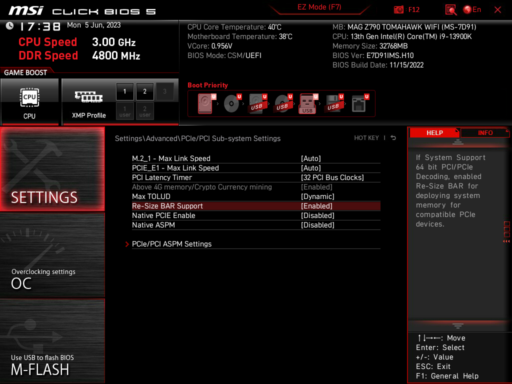

Do you have above 4G decoding and Resizable BAR enabled in the Bios ? If not enable those 2 and see if you get more juice from TVAI
Also try to switching hardware scheduling on/off

That was already enabled by default on my motherboard:
And the GPU scheduling was enabled before, now I’ve disabled it, restarted Windows and…

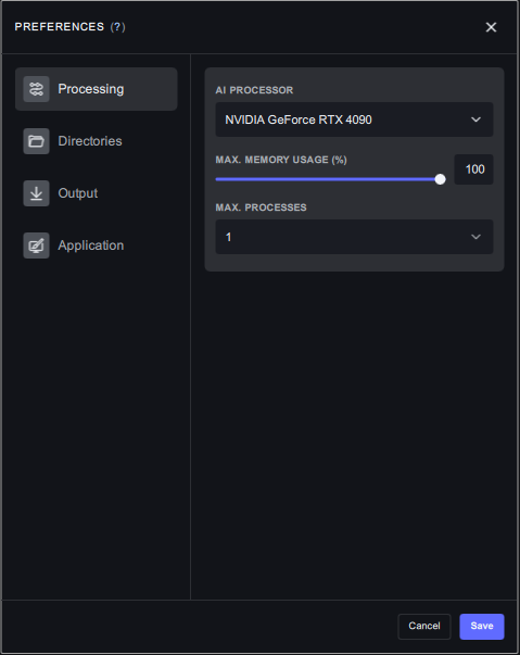

There is nothing I can do, and there is nothing that can be done in TVAI because the only thing that is offered is the possibility to change the maximum GPU consumption (at least if the streams could be increased… maybe that would fix the problem.), which I have always set to maximum and it never uses the maximum. I have already mentioned it several times, the problem is at the internal level of the program, because it uses very little VRAM memory, and it should use much more.

Are you 100% sure you have selected the 4090 under preferences ?
My RAM is 4800Mhz, and DDR5 slow… yeah… :rofl:
