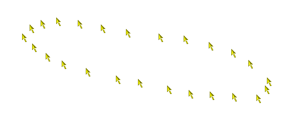

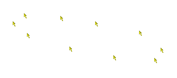

Let me put it this way: On a computer monitor, if you have all your settings correct you can easily move the mouse cursor really fast back and forth and the image of it will stay registered in your eyes for a moment. Just stay focused at a point in the middle of where you’re moving the cursor around.
It will look something like this at 60Hz:
At 144Hz it will look more like this:
I don’t have the hardware to test it, but you can buy 360Hz monitors, and I would imagine it the line of pointers would fill out even more on one of those.
Now part of that is because the sensors in your eyes tend to stay activated longer than super short bursts of light, but the fact that you can see the lingering images means you can technically learn to tell the difference in motion speeds on display screens.

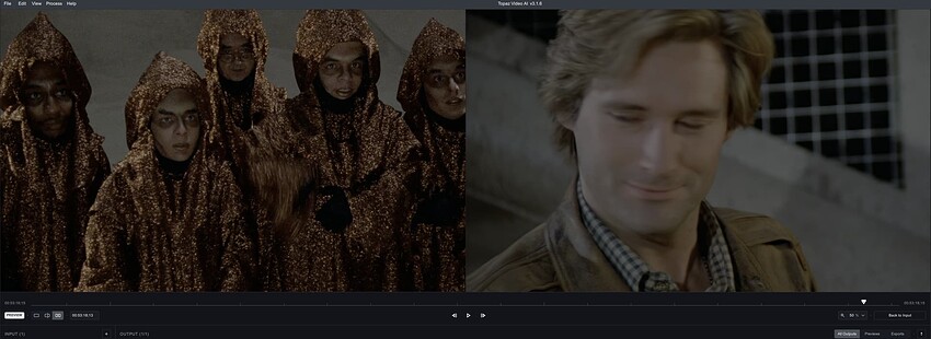

Guys, I just wanted to ask if it was possible we could make the time slider work…
I have been fighting that darn bar since 3.x release. Essentially it is ULTRA slow, click and wait 5-10 seconds (Ryzen 7 5800x, 32gig ram, nvme gen4, 3080) and you MIGHT get lucky and it stays there… 3/4ths the time is shows on the screen for 1 second, then goes back to where the slider was before. This is 2-5x slower when you are already exporting something.
I am pretty sure that is also the reason the side-by-side view has SO much trouble when you want to preview. One side will move, the other half the time stops, the slider arrow stops… the right side moves, but other does not… sometimes it will just show a random frame (which is not in the tmp file it makes). OH yeah, and sometimes it will get to the place on your slider… stay there for like 7 seconds, then randomly move a few frame + or -. I honestly believe this slider is possessed and HATES me.
I love how far 3.x has come and is coming, but man this slider just makes me cringe everyday.
edit attached it a lovely picture of the side-by-side showing two TOTALLY different frames, left side does not move for 2-3 seconds then changes to something else, right side plays like normal. (ignore the video on the right, I am busy playing with settings and sliders trying new stuff.
This one of the reasons why I’m not paying to upgrade, along with a slew of other reasons. They can’t fix the side-by-side view without causing bigger problems elsewhere, otherwise it would have been fixed by now. I’m sure they’ve done a ton of testing on this and have yet to find a solution.

My system is pretty similar, and the time slider is much more responsive than you describe. I only have DVD sources and sometimes FHD blu-rays (So only MPEG2 and AVC codecs.). I do get the marker moving around from time to time when it’s supposed to be paused. I think I narrowed it down to trying to play previews while processing is not complete in combination with a DVD source.
With DVDs, the preview frame mismatch is always there because of the weird 29.97 frame rate requirement. If i convert movies to 23.976 fps and then open them in TVAI, the mismatch goes away.
It is MUCH more responsive on lower quality stuff, 720p 1080p even somewhat, but really starts to tank in 4k+. It is odd on 1080p too, sometimes it will be johnby on the spot, other times it will SLOG like it got it’s feet stuck in acme sticky paste.
