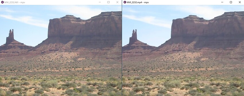

What do you think is the difference between them?

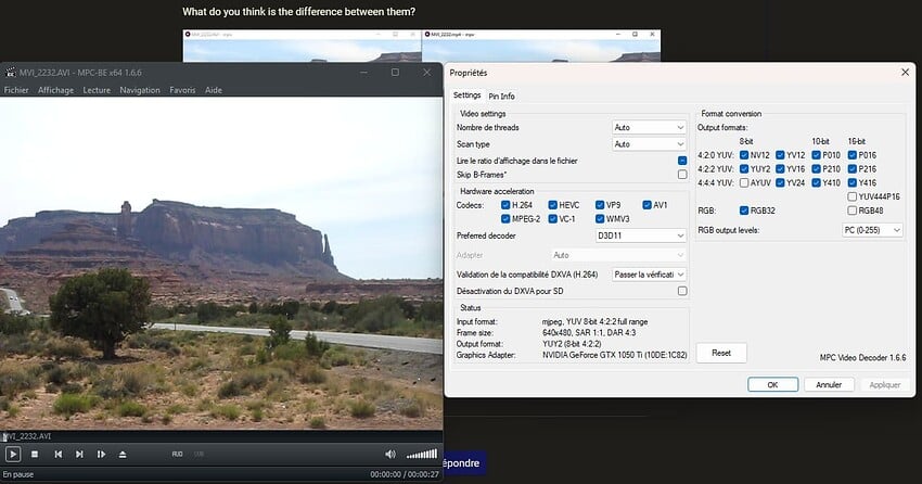

which player do you use ?
capture of MPC Setting
I’ve never seen this image, it’s clearly overexposed. So no matter how much you give feedback, it is impossible for me to appear.
it’s not my problem anyway, and not my video.
That’s right, people who require accurate colors first need a player with accurate decoding.
