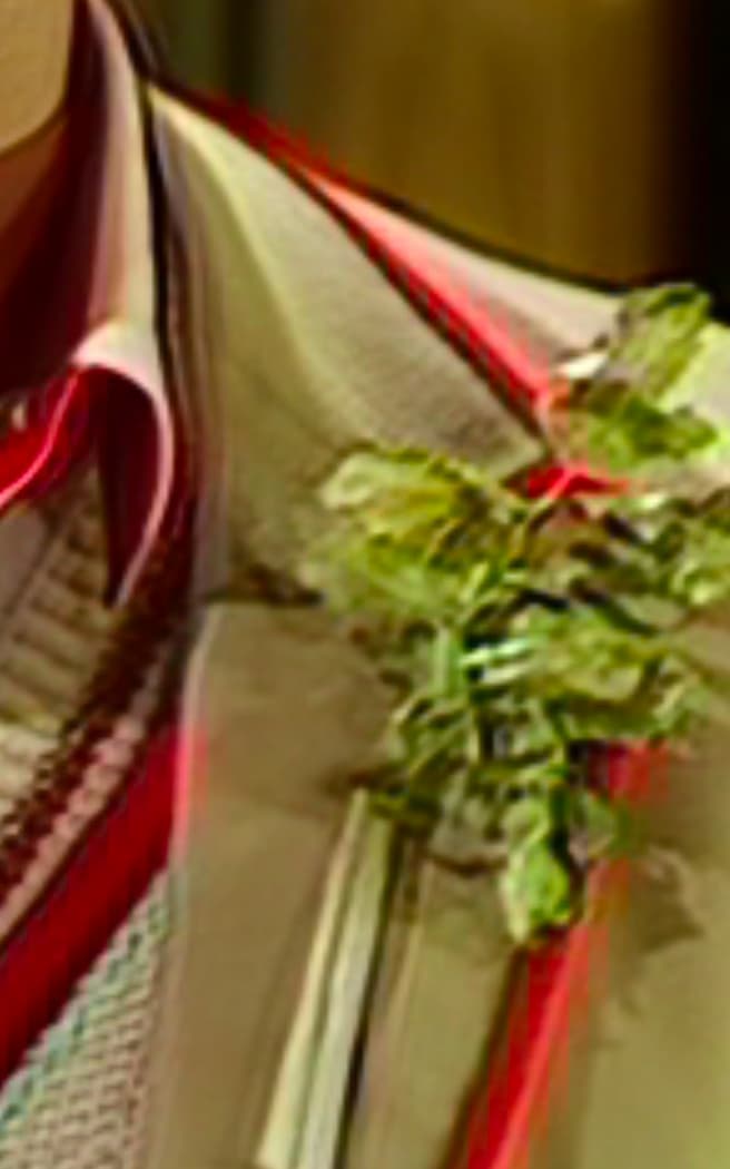

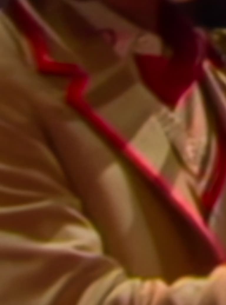

When I’m using Proteus to clean up an video (100% not upscaling yet), everything seems to work except for reds. Anything “red” in the image breaks into vertical lines. Because of this, the picture “out” is worse than the picture “in”. I’m sure this is new as I don’t remember seeing it before.

that’s the input source I got. But previous versions didn’t produce this issue.

Red colors are generally very critical when encoding. Test if the problem disappears with a different export format like ProRes or higher bitrates.
Hi there - thank you for the reply. This is not after encoding (although I use Pro-Res), this vertical pattern is introduced at the preview stage.

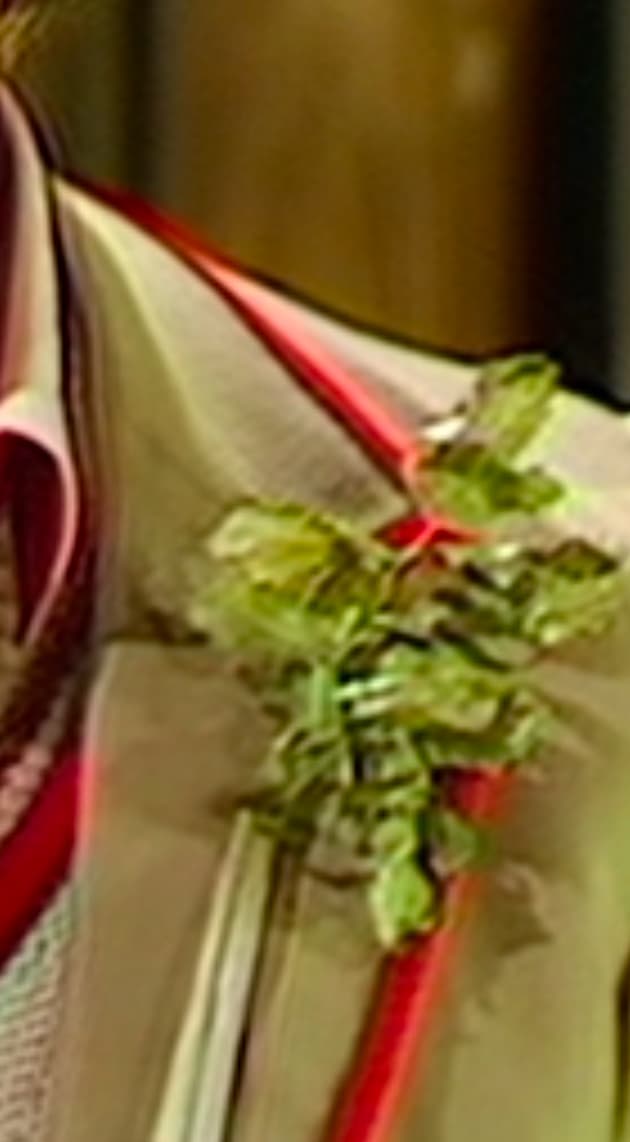

Not sure if it helps but here is proteus in 2.6.4 and 3.1.1
(Not the same frame but I think it shows the difference with the same input.
