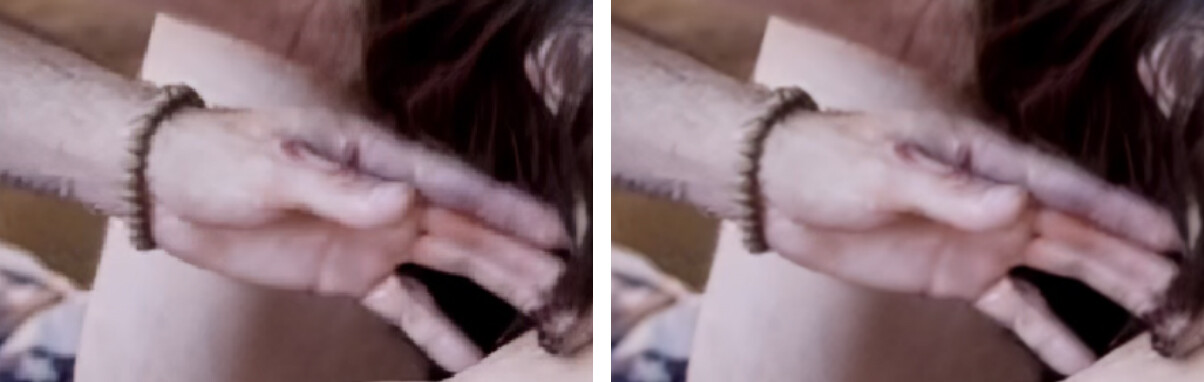

Played around for a littlebit. So far i notice the processing is slower and previews look very pixelated.
3.0.11 (17 seconds)
3.1b (23 seconds)
The spf is simular, but i notice the 3.1b gives several failed model warnings before starting.
On the Alpha post it said models are slow, but it doesnt say that here on the beta. (Proteus auto 1920x1080p)
(Looks a little worse irl, dont think i captured it at a high enough res. But as you can see, its pixelated)
Left: 3.1b
Right: 3.0.11
Update: After doing a short render the speeds where in fact better than 3.0.11, the “failed model warning” was to blame for the slower previews. Also, the rendered video did not suffer the pixelation the preview did. Though, it is hard to work on a video if the preview differ from the end-result
