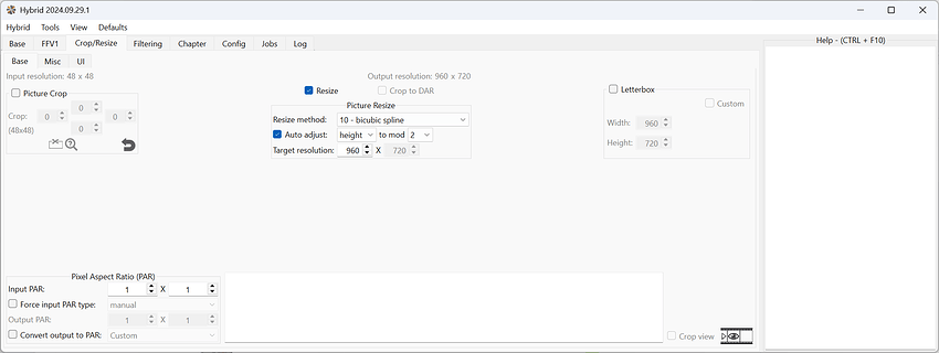

You could try, for example, ScuNET alongside traditional upscaling methods (to your desired resolution) in Hybrid as a “first pass” before using Rhea XL. Interestingly, Hybrid can be “tuned” to blend, meaning you can adjust the strength of the effect (you need to enable the “show -merge controls” option).
Screenshot-00011
