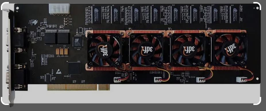

3Dfx Voodoo 5 6000 with four GPUs and 128MB up to 512MB! …SD Ram

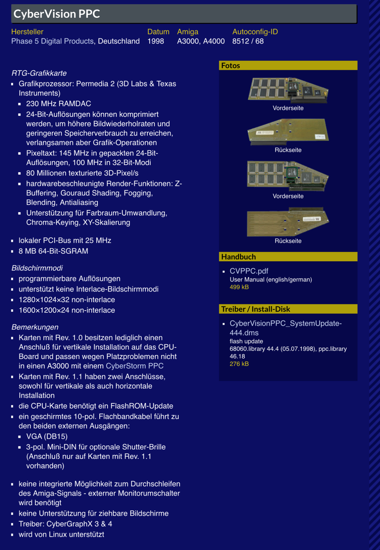

Or this?
Featuring a stunning 8MB 64Bit SGRAM
Also nice but the Vodoo for $4.322,92 is unbeatable, real VGA :crazy_face:
