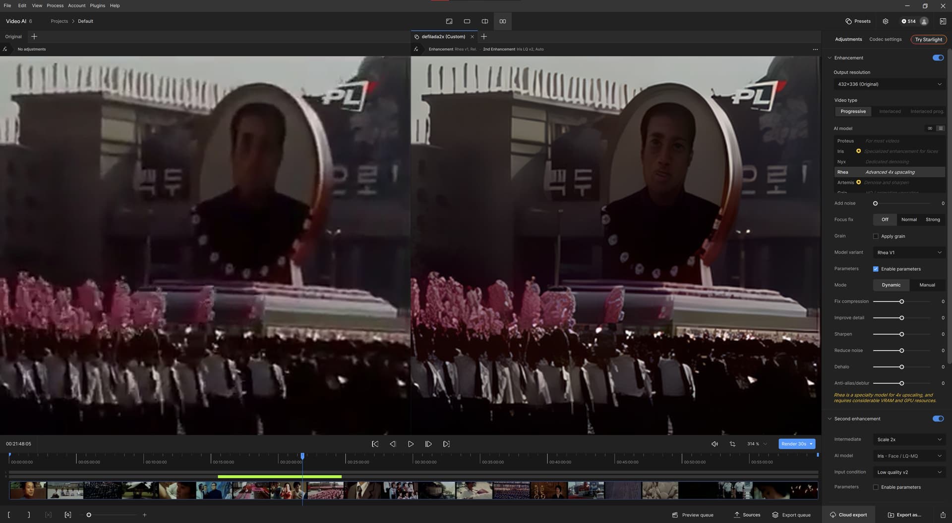

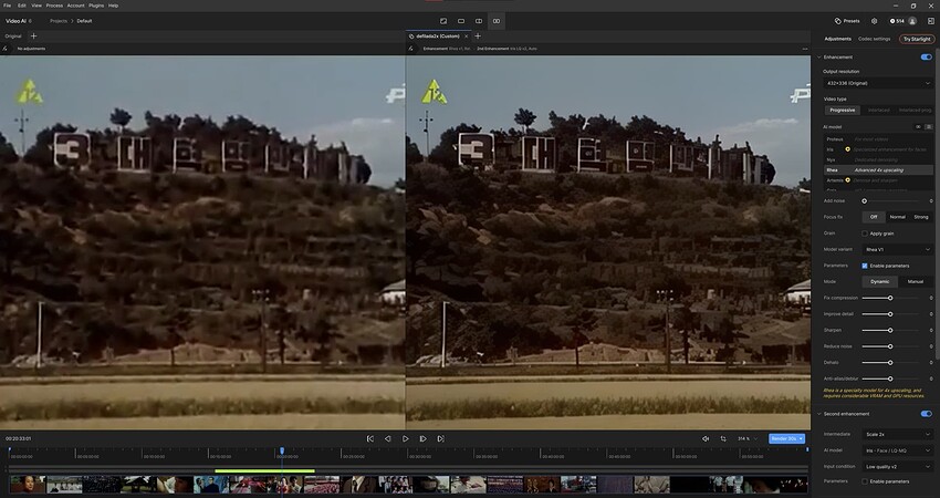

I stumbled upon an interesting preset while experimenting, it does only 1x on 360p (I wish I could upscale it at a given resolution JUST AFTER applying 1x RHEA v1, but, alas, one can dream! :slight_smile:). Please try the preset on destroyed lowres video! :slight_smile:
The name of the preset comes from the old Polish documentary about North Korea by Andrzej Fidyk, ‘Defilada’ (eng. ‘The Parade’). I have it in awful 360p FLV-compressed format.
Nice uplift in 360p quality, funnily enough Rhea v1 is better at 1x, than 4x… :slight_smile:
Is that Korean Elon next to Kim Ir Sen dictator? :rofl:
Gotta love, what Iris LQ v2 did to poor Kim Ir Sen. A couple of frames later he transforms into J.D. Vance…: :rofl:
Oh. Is that Nicolas Cage? :slight_smile:
Hello, Officer Tenpenny! [GTA San Andreas] Or is it Lionel Richie? :slight_smile:
These results are actually not that bad!

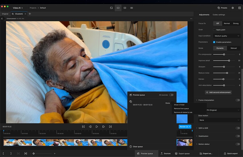

I must have missed something. How do you stop or pause a process in 6.1.3? I don’t see where anymore for either a preview or export. The pics show where I’m looking.
M3M fully loaded OS 14.7.4
Thanks in advance!
***Apparently those capabilities went away a while back I have just learned. Why?
