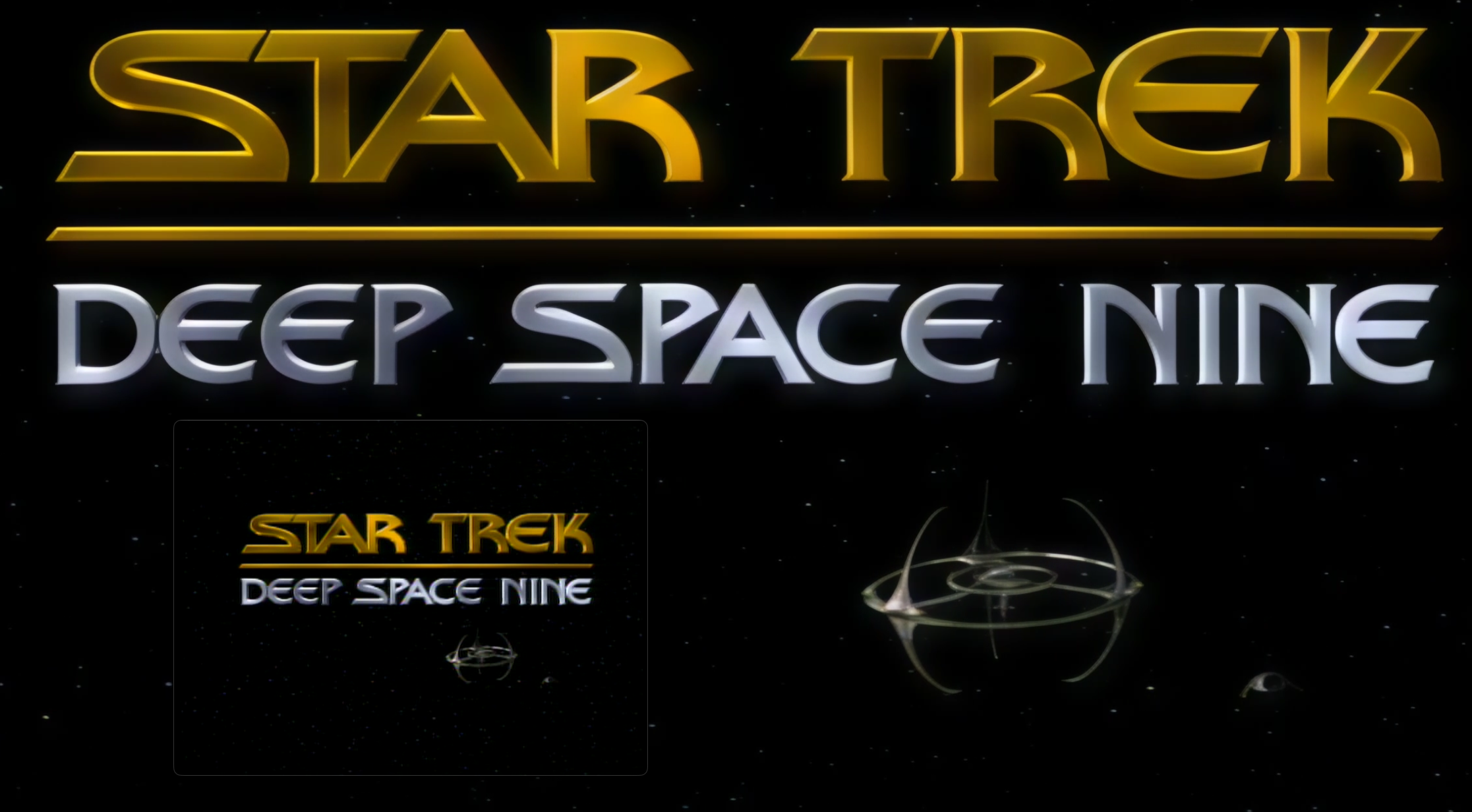

Apple must have changed something got starlight mini working on Mac with Version 26.3 Beta (25D5112c) - beta 3. But we need to new time measurement, more like fpm vs. fps… took 43 min for 31 frames for a frame size of 720x480p, enhancement 4x, no other settings changed
Edit: typo in file resolution, this was 480p, sorry
original video is in the lower left corner
That sounds really promising, putting the speed aside. I’m guessing that was on your M4 Max with 36GB?
