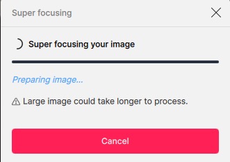

I have found that cloud processing often hangs and even after over an hour it never ends. Sometimes it does work though. It is totally hit and miss. Over the past week or so I have used Super focus on photos that were 12mp to 24mp and out of my 4 attempts to use cloud processing over that week 2 never ended so I finally had to cancel them and 2 worked.
Here is where it hangs when it doesn’t work.
The development team is aware and has gathered logs of users when attempts fail and are looking into getting more consistent cloud behavior. You can test smaller images and also test with no other enhancements and only Super Focus in the stack, which can help.
In all 4 cases Super focus was the only enhancement. For small images I can do local processing. It is for somewhat larger images that cloud processing would be useful. If it would reliably work, that is.
Thanks for the confirmation! We do have a open ticket for generative models not being consistent on larger files, I will add your contact information on it. Thanks for flagging!
