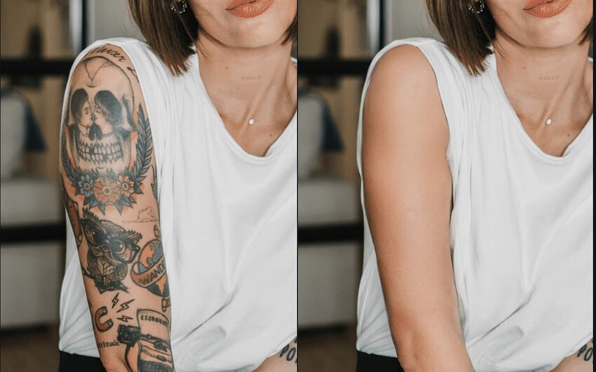

OK, the clue is not (only) to set the Guidance to “keep area” but also to mask the whole tattooed area in one step - otherwise it’ll replace the tattoos with others and not with plain skin.
So the result is MUCH better now:
A screen recording showing the duration of the process on the MacBook with M1 Pro:
RemoveTool.mp4.zip (512.3 KB)
This also kinda limits the tool to lower res images as long as the mask is “limited” to 2000pix. So we’d definitely need a larger possible mask at least for machines with enough VRAM and/or the possibility to give the tool some guidance of which parts of the image it should preferably use for inpainting, e.g. with a second mask. @bin.sun
