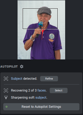

Just installed v1.2.4 and noticed multiple faces detection where I got a portrait of just 1 person.

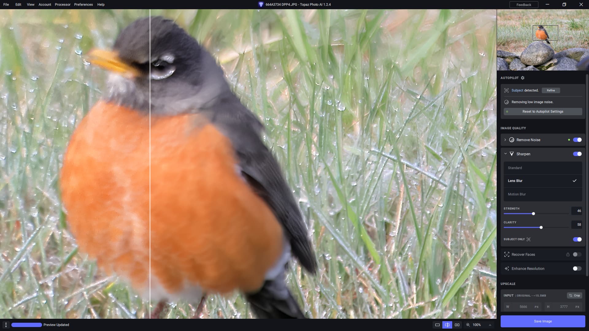

I have tried different settings but for some reason, with this image, it’s not working for me
Try turning the Strength setting up to 100 for an image as bad as that to see if it can correct the blur.

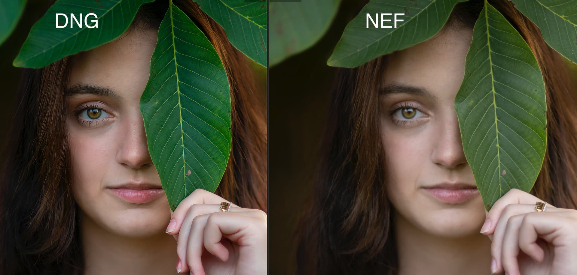

  4. RAW to DNG color issues: colors + contrast do not match NEF. It’s as though a new profile has been used. However, that’s not the case (that I can see in Lightroom). Colors are oversaturated and there’s more contrast. Exporting an NEF to DNG directly in Lightroom doesn’t cause this issue. This only happens when using PAI RAW to DNG workflow. Also, I did not have this problem in v1.2.2. (I went back and installed to verify).

Disregard this; Deleted 2 plist files, and now it’s working.
For another tech issue, I had to delete the 2 plist files in Preferences. That also fixed this issue with the RAW to DNG color difference and the posterization.

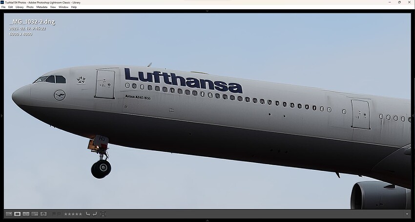

Windows 11. Camera is Sony a7IV. I save images as lossless compressed AWR files on SD. I convert to DNG on import into Lightroom Classic (most current version). Using recommended File-PlugInExtras-Process with Topaz Ai method to invoke Topaz Photo AI using DNG image. Resulting image has artifacts horizontally at the bottom and vertically at bottom right of image - visible in DNG returned to LrC and in Topaz Photo AI.
Only occurs with DNG original. Tested with older Sony raw format from A6000 and A7III cameras. Topaz AI worked flawlessly and returned clean DNG.
Problem does not occur to the same image in original AWR format I retrieved from SD card.
Suspected bug is in the conversion of Sony AWR images to DNG format during import in Lightroom Classic. Artifacts added in reconverting image to DNG.
Temporary fix is to delete original DNG from LrC and reimport raw files without conversion to DNG. But I have >12k DNGs.

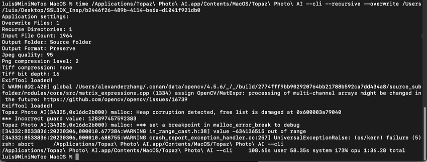

Running PhotoAI 1.2.4 on the CLI it crashes badly
Machine is a Mac with M2Pro 16GB RAM
the directory has several JPG pictures from a DJI Mavic 3 drone
Also note the warn about a issue on GitHub/OpenCV core: inconsistency of addition for multi-channel Mat and Scalar · Issue #16739 · opencv/opencv · GitHub
Any chance we get a 1.2.4.1 version sooner rather than later ?

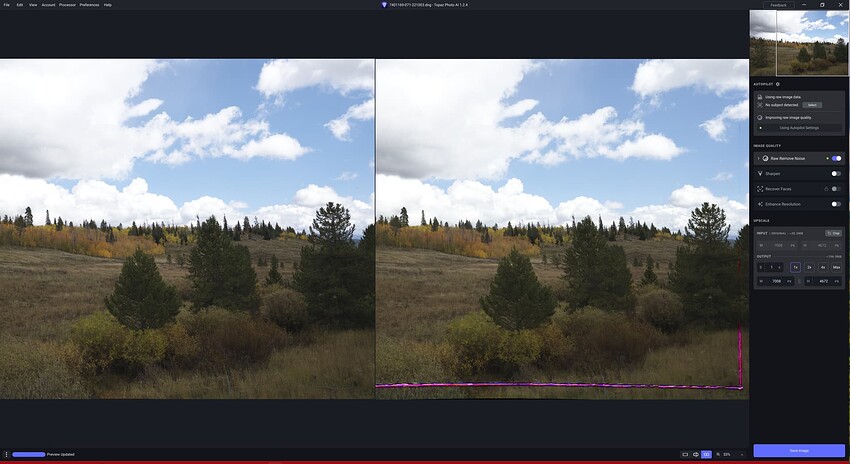

Please move Denoise slider above 25, the pink line will go away. Topas software developer are aware of this problem

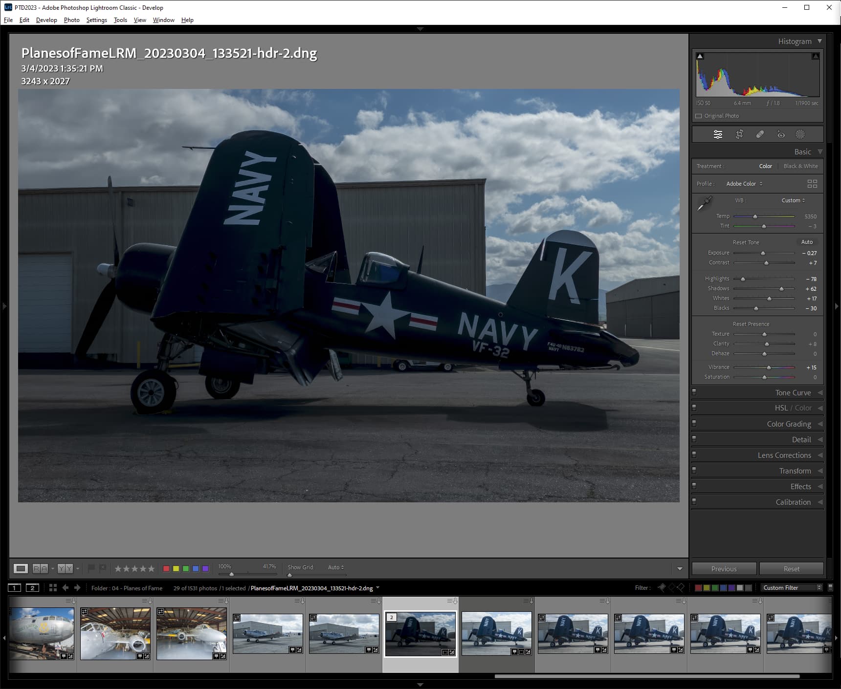

Like that the ability to edit LR HDR files has been added as when I want something quick and not up for changing lenses I tend to go the route of pulling out my phone and using the LR Mobile camera app.
But I have noticed that running these files through Photo AI brings it back much darker even with only slight differences in the settings once it is reloaded back into the LR catalog
Some work can be put into the result to bring it back, but it is a hard press to match it back to something closer to the original.
