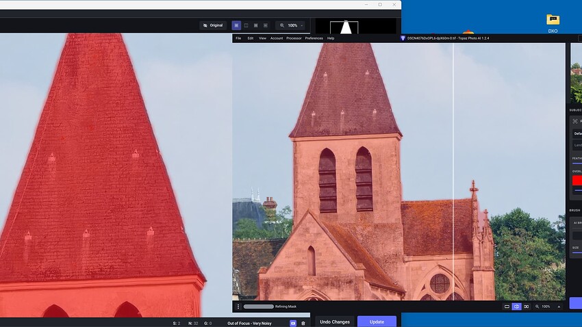

I compared view inside Sharpen AI and Photo AI
I don’t understand the issue with the zoom factor as you can see on this screen shot
Sharpen AI and Photo AI are at zoom 100% . The size of Photo AI display is for me two times too large !
samething with denoise AI also two times too large
This is something I complained long time ago for Denoise AI but never checked it is good with Sharpen AI So it will be good if you can be good and coherent between your applications
Concerning the Basic brush with PAI 1.12.4 I agree this is better than nothing but what I expect is a cursor like the one in Sharpen AI with edge detection I found much more usefull . I Hope it will came

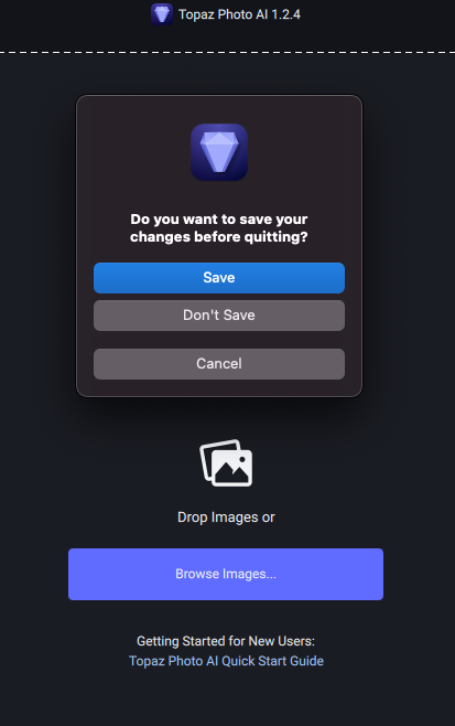

Today in the office on a 2017 SSD iMac running Ventura latest I am experiencing the same thing I went through on the M2 Mac Mini at home: The app’s interface in standalone mode can’t be moved around the screen (it jitters and flickers).
Even worse, I cannot load an image with the Browse option (nothing happens). Same with dragging from Finder (whether TIFF or JPEG).
When used as a Photoshop 2023 plugin, Photo AI won’t load the photo (only the Drop/Browse window is presented).
Also, how do I save changes to nothing-?
Screenshot 2023-03-06 at 3.08.51 PM
I fought with PAI as a plugin some more and had to resize the window before the photo displayed. Otherwise it was No Filter Selected (or similar) and a blank canvas.
