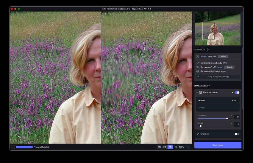

Same problem persists in this update, as in the prior three. Artifacts in the grass to left of face when “Remove Noise” is switched on, no artifacts when “RN” is off.
This is on a Mac Air M2, Monterey with all updates. Same thing happens on my Intel Mac Mini, Monterey with all updates. It doesn’t happen with any other image processing program that I have, including Denoise AI.
No progress. Discouraging.
See my post above from yesterday concerning this. I contacted Topaz to report this problem and I was told it is working as intended so they do not plan to fix it. :frowning: They intentionally sharpen when Remove Noise is used and do not allow sharpening to be turned off.
Today I was working on another photo with Photo AI and once again had the same problem with Remove Noise. Out of focus grass in the background was sharpened even though I did not want that. Very ugly. I set Detail to minimum (as suggested by Topaz) which is 1, not 0, but it barely helped. There is no way to turn off sharpening in Remove Noise.

A few minutes ago I discovered a similar sharpening problem with Enhance Resolution. Remove Noise and Sharpen were both turned off. Enhance Resolution sharpens out of focus grass and leaves in the background and the result is very ugly. Changing the Upscale to 1x still does ugly sharpening on the out of focus background. Turning off Enhance Resolution gets rid of the ugly sharpening.
I tried it with Gigapixel AI and played around with the models and the Remove Blur slider. It does almost the same thing as Photo AI, but by adjusting the Gigapixel AI controls I could reduce the ugliness some. I could not eliminate it though. Photo AI has no controls though.

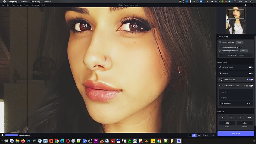

It may just be me, but it seems like this version seems to be really messing up straight lines (or what should be) at low resolution, especially in photos with guitars. Just check out the frets and strings in this screenshot. I realize the image on the whole is low res, but it’s really bending what should be straight lines and then taking a rather monochrome photo and adjusting the color when recovering the face.
