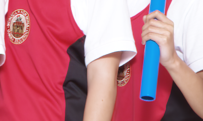

Photo Ai 1.1 is producing some seriously bad artifacts. this occurs a 1x and 2x scale. the beta version was not producing these issues. I tried the same raw images in gixapixel beta latest version, zero artifacts around the badges.
