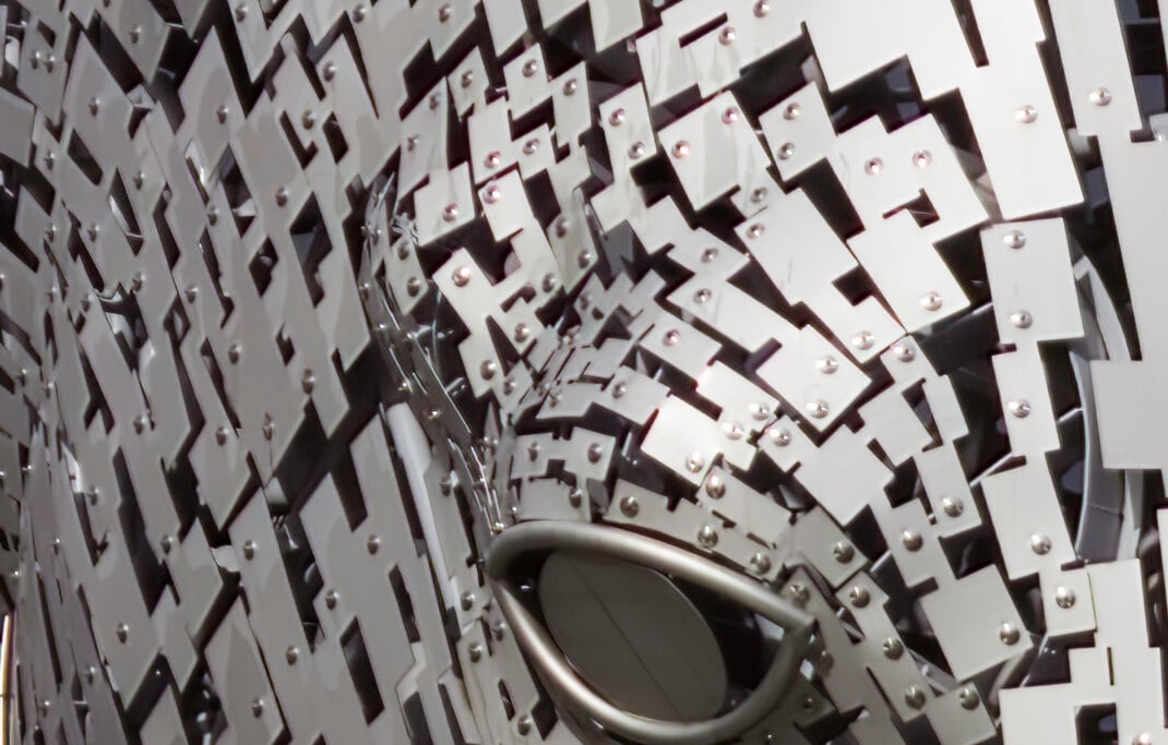

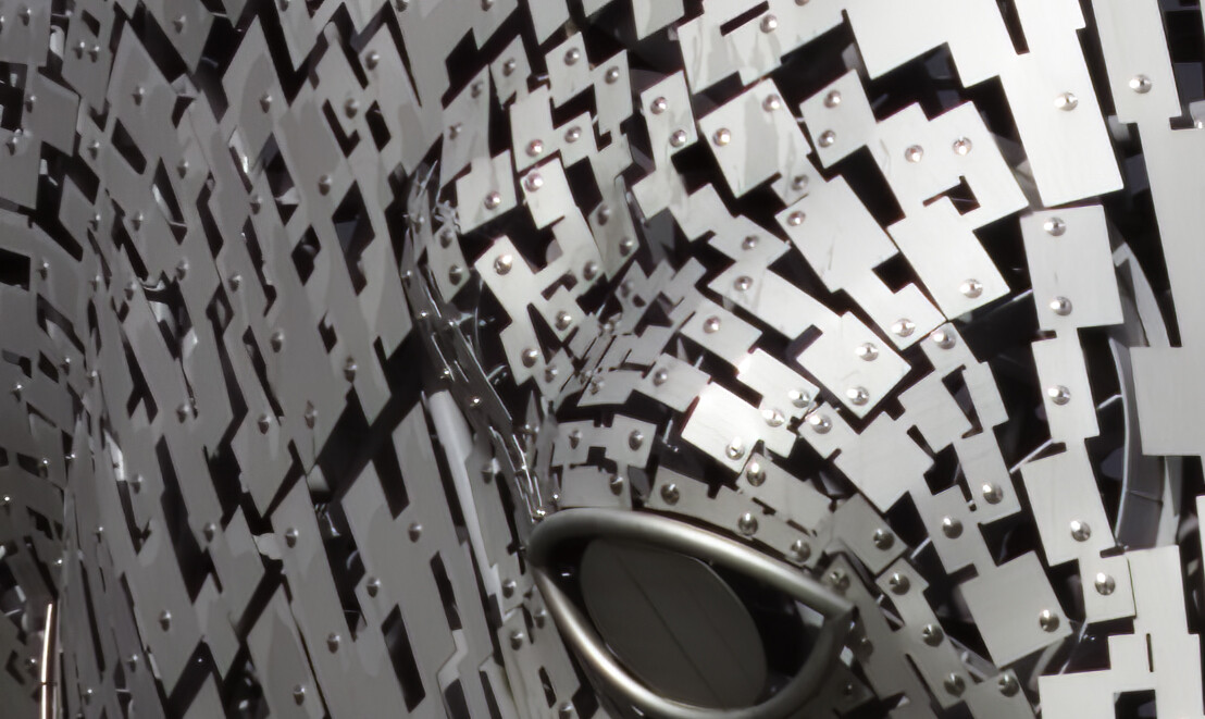

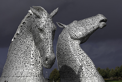

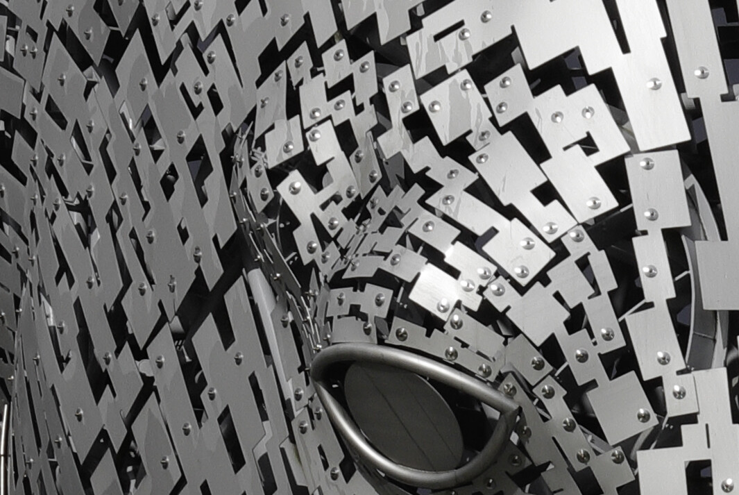

First image, and a comparison…
Four versions each with their own basic RAW conversion and using Lens Corrections.
ACR ( Adobe Camera RAW ) DPP ( Canon Digital Photo Professional ) Topaz Photo AI v 1.3 and v 1.5
Note the chroma errors and the overall colour . Images are jpeg from 16 bit Profoto Tiff.
The four close ups are 100% views and on my monitor I give the award to ( drum roll) Canon DPP , followed by ACR , then AI 1.3 and last with red edges AI 1.5.

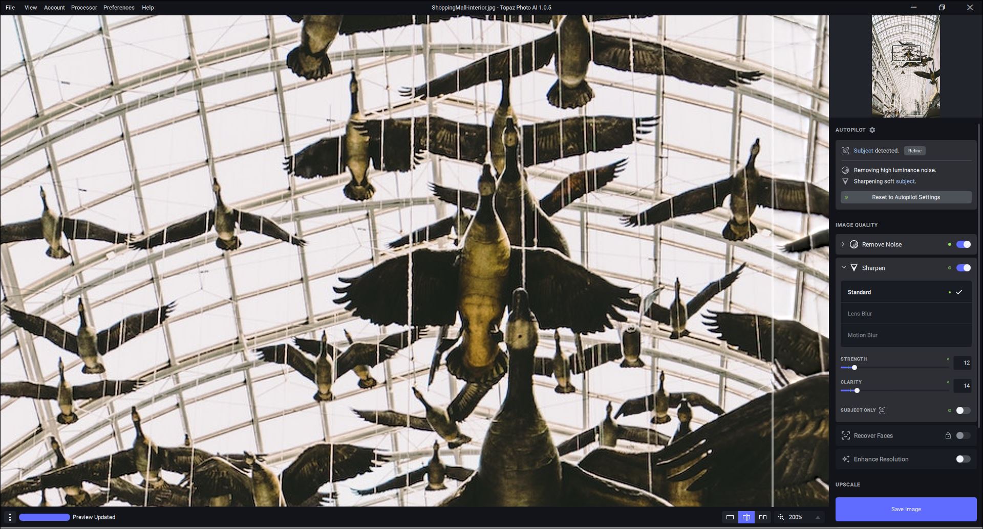

So I just downloaded/overwrote .4 on my Win 11 Pro desktop PC. Processor still = Auto.
No issues with the download/install - as usual (so far I’ve just tried the Standalone with a jpg original image (1920 x 2880 px).

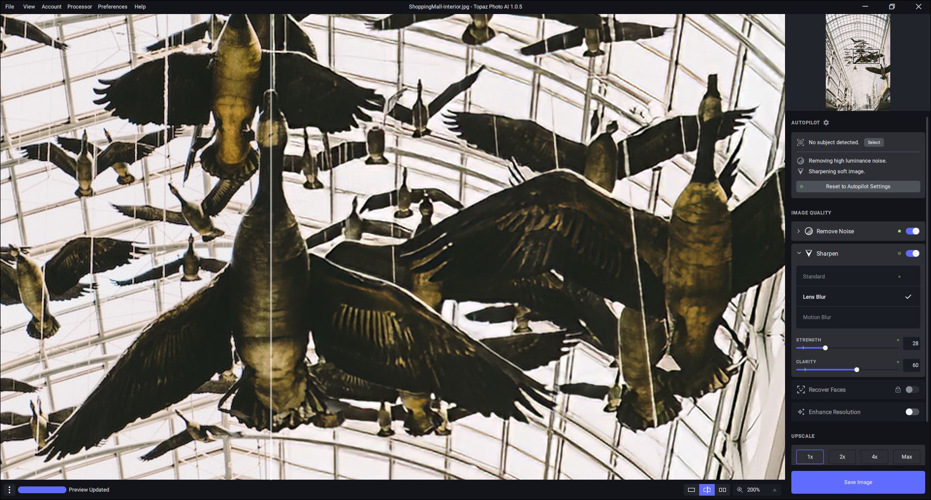

Seeing the same thing as I’ve experienced in selected other (not all!) releases - the processed image looks softer and less detailed than the ORIG. Snips below. I switched from Auto to trying manual sharpening - it didn’t help. I also turned off “Sharpen Subj Only” b/c very little subject was detected…snip attached for that too).
QUES: Is there a way that ‘Sharpen Subject Only’ could be made “sticky”? More often than not, the A.P. isn’t selecting either the subject I want sharpened or is selecting random parts of the image (which Refine doesn’t let me correct, unfortunately - as with this pic). If it would hold my last used setting that would be (as they say) mahvuhlus (ie, great)!
PAI Post-Processed Preview in interface - softer, less detailed than Original (before & after manual Sharpen slider adjustments & turning off Sharpen Subj Only):
You can effectively turn off subject only by setting the default subject detection to “none” in the Autopilot settings. You can still manually change the subject detection to another model on images you want it to find a subject in.
Yippee! I just closed out to “cleanse PAI’s palate” (as it were…). Then re-opened the image after adjusting the AP settings as you suggested above. Much better! In the process then I also played around with the Sharpen non-Std models/sliders and got results that showed some improvement vs. the ORIG jpg’s blur. But - I’m keeping in mind GIIGO (garbage in, improved garbage out for now … I think I’ve become spoiled b/c I’ve so often experienced GIMO (garbage in, miracle out!).

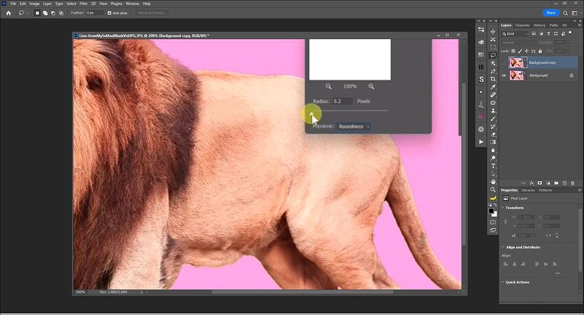

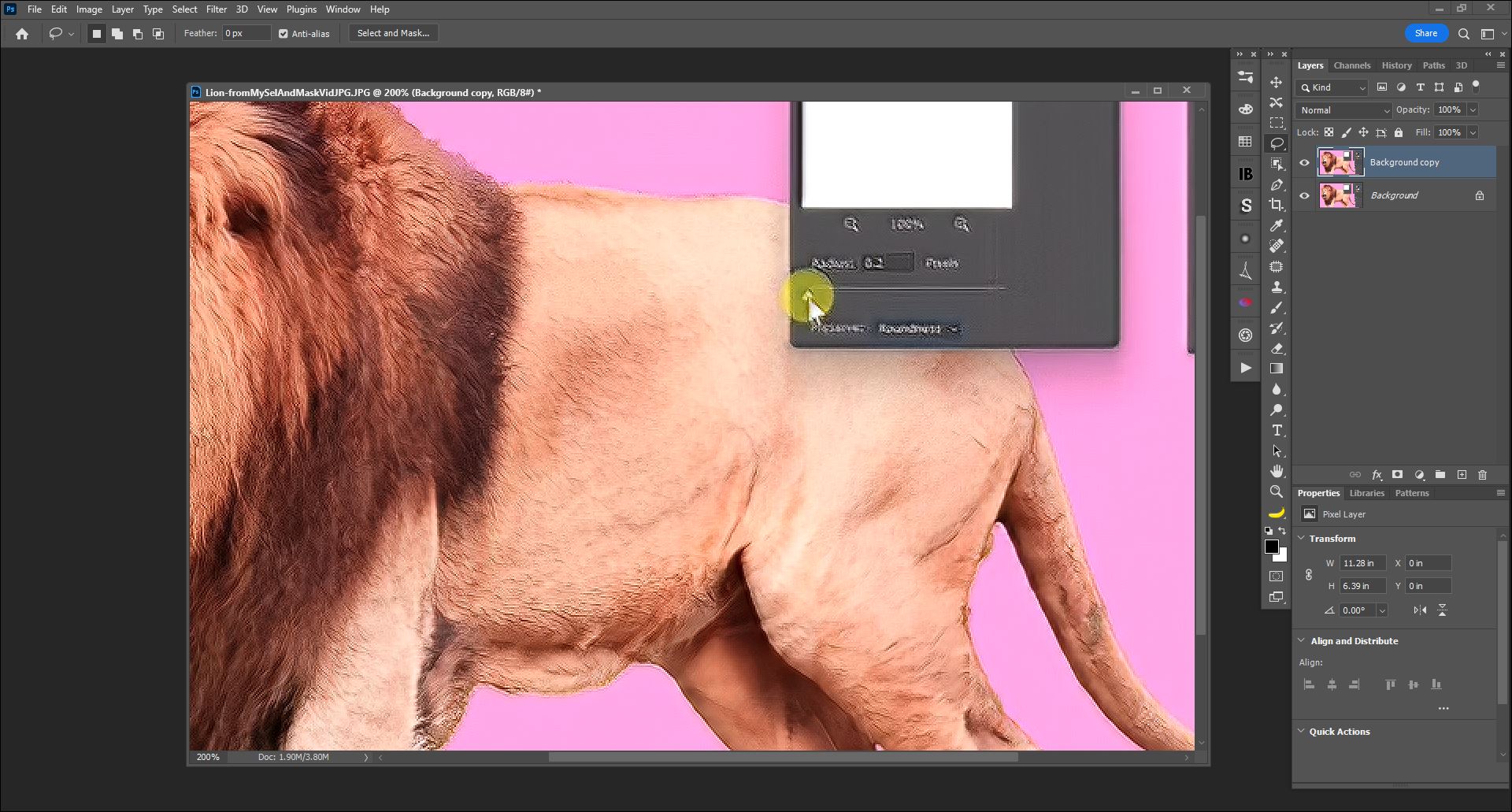

I just tried the Ps 2022 Plugin vers. on my Win 11 Pro desktop PC also.
3 Issues were a Problem: 1- The plugin is back to not opening full-screen when launched from my Ps layer stack. 2- The processed image saved back to Ps is showing a significant Pixel Shift/Hop which it hadn’t been doing in the run of recent releases. 3- To get the test image sharp enough it ends up showing a lot of over-sharpening artifacts (‘snow’) back on the Ps layer.
** Orig. image is a jpg snip from one of my YouTube videos that I’m trying to use to create page reps for each video.
Here’s snips from inside Ps 2022… so you can see what I do.

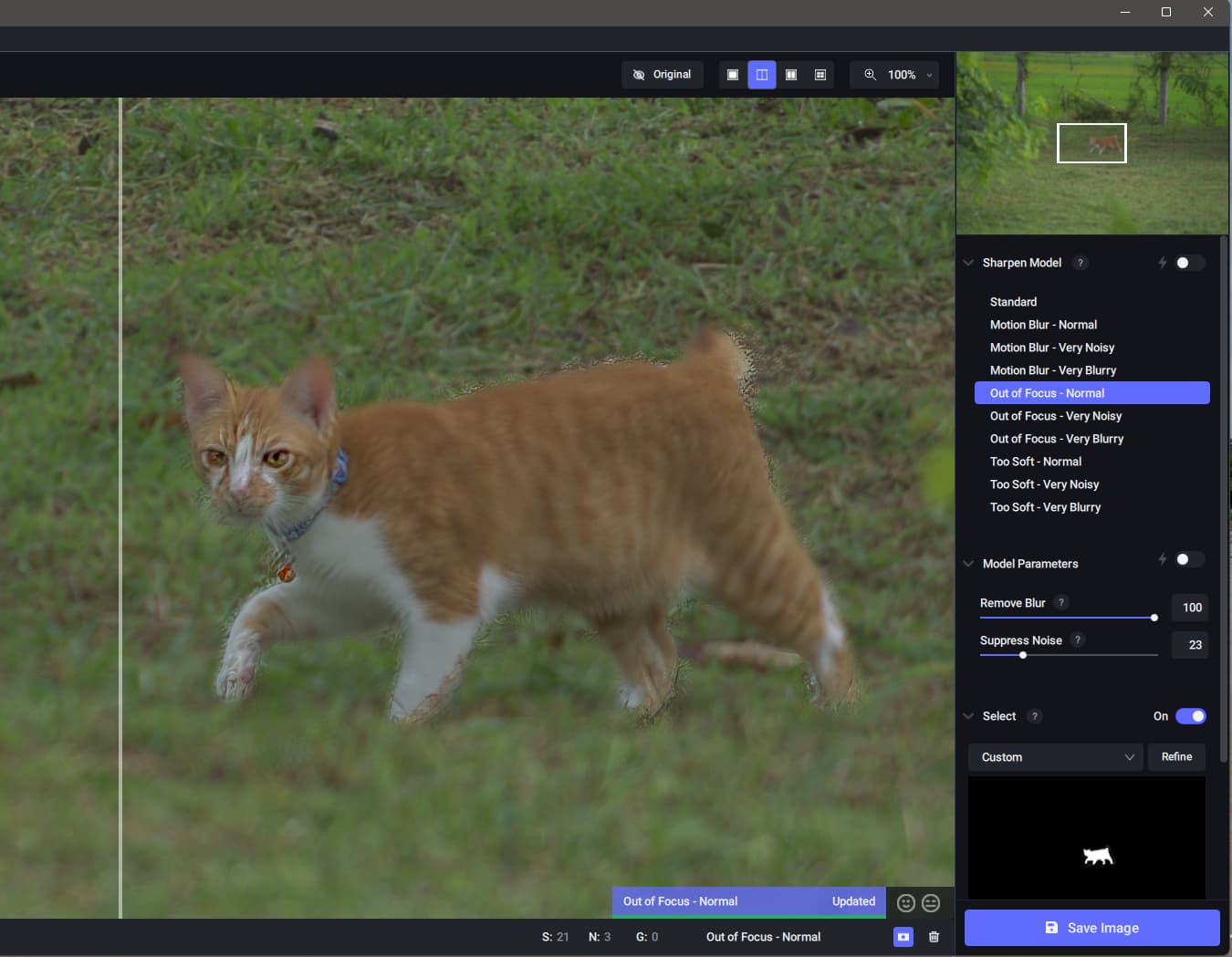

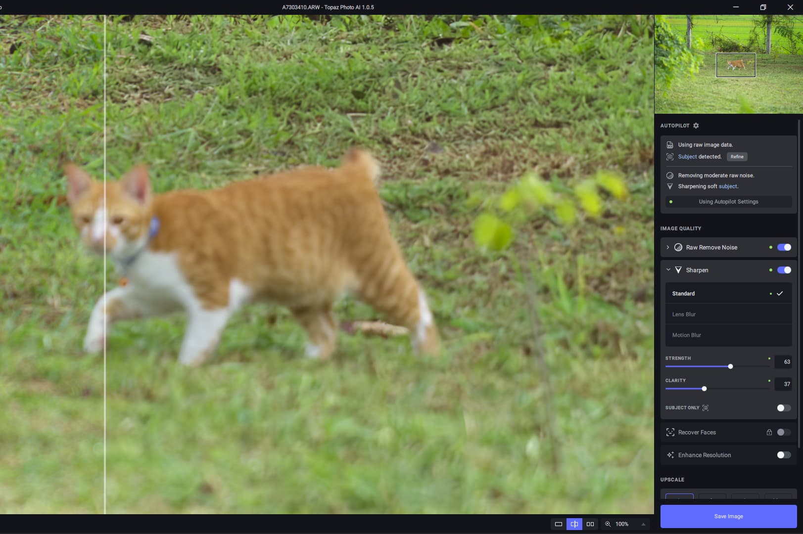

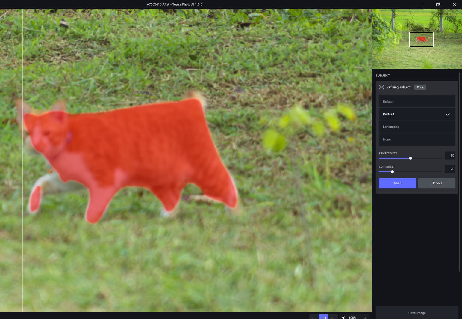

Obviously I will need to adjust the mask but this is what Sharpen AI does, chooses Out of Focus - Very Blurry which doesn’t work as well as Out of Focus Normal.
Really there are serious issues with the Subject Detection, Model Applied and Mask Adjustment in Photo AI.
Note though, these are extreme examples just for testing but, with a little tweaking of the mask, you can get a 98% useable image out of this with the subject recovered in Sharpen AI.

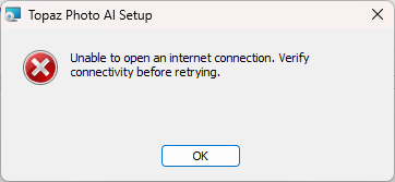

Installation does not work, the 1.0.5 cannot be installed.
Error message see screenshot, Internet works of course.
Installation was done with the download version and via 1.0.4.
The previous version was still uninstalled during the process, at least it can no longer be called up.
The abort comes relatively late in the installation process.

Hi, I have the same Problem. I´d installed 1.0.4. before without any problems.
But now : " Unable to open an inernet connection. Verify connectivity before retrying"

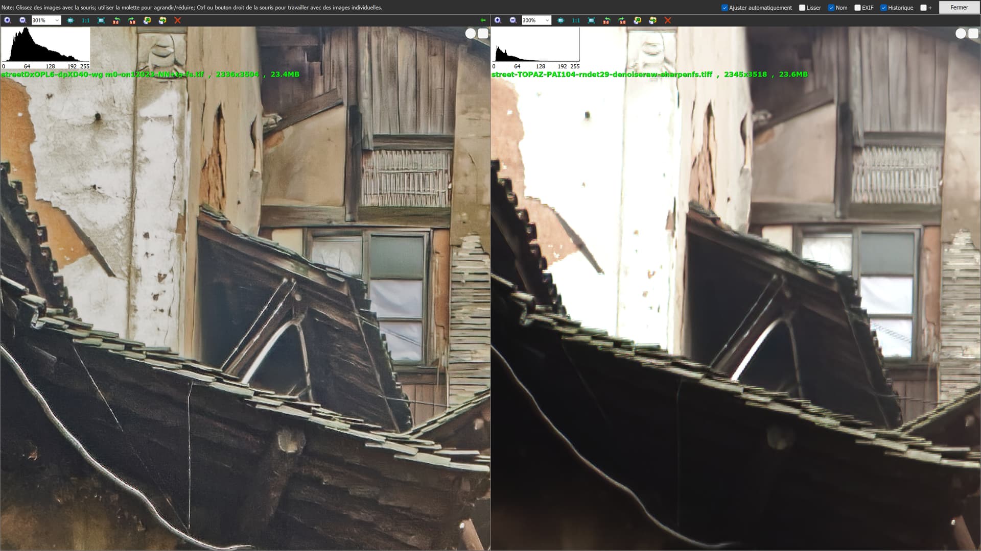

Why using RAW wiith PAI and all others Topaz AIs are totally useless
Here something very convincing
Right is the RAW file (Sony CR2) process with PAI (denoise and little of sharpen)
Left the RAW file is First demosaic and denoise with DXO PL6 and further process with ON PhotoRAW 2023 with Nonoise and Tack Sharp AI
We can see the enormous differences with highlight on the wall totally burn and strange artefacts on the tiles for exemple
I tried to recover the TIF from PAI with CameraRAW LightRoom and for me it’s absolutly not possible !!
This is why I can enjoy to use Topaz AI stuffs only on TIF files so I don’t understand why you are spending so much time and money trying to work on RAW files if you cannot do better ?
