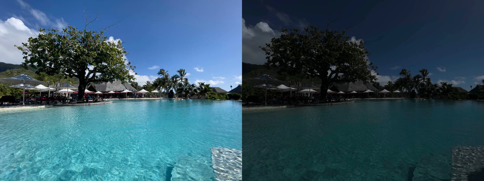

I have been having issues with all DNG raw files taken with my iPhone 12 Pro Max being darkened when processed with AI. And without any sliders for exposure, the only fix is to process them in photoshop and save them out as a different file type, which fixes the issue. The attached photo shows the original photo and the AI-processed one.
