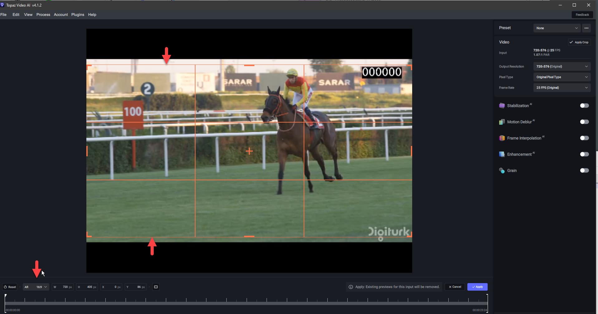

There's something wrong when trying to crop a 16:9 frame from anamoprhic 4:3 PAL DVD
Trying to crop a 16:9 frame from a 4:3 PAL DVD (720x576 DAR 4:3) fails, because there seems to be something wrong with the underlying math.
That’s the source:
Here comes the crop settings:
With square pixels and a given width of 768 pixels (suggested by the GUI), I would expect to see a width of 432 pixels to match 16:9, but it shows 406, which gives an aspect ratio of 1,892 (instead of 1.778).
If you know a way how to upscale this properly to 1280x720 or 1920x1080 to match the desired frame without stretching or further cropping, let me know, please.

Yes, it appears that the crop (or maybe just the calculation) is occuring before the conversion to square pixels, so the widescreen crop is being stretched horizontal by the conversion, making it a bit wider than it should be relative to the vertical (768x406).
If the crop (calculation) was done after the conversion to square pixels you would have the proper 16:9 ratio (768x432).
Thank you for confirming. Your explanation sounds very plausible to me. The frame is displayed on-screen with proper transformation to 4:3, but the crop ( read: the yellow rectangle and the displayed values for X,Y, W, H) seems to refer to anamorphic pixels. Beside of creating undesired aspect ratio, this has also some other negative side effects, one of those:

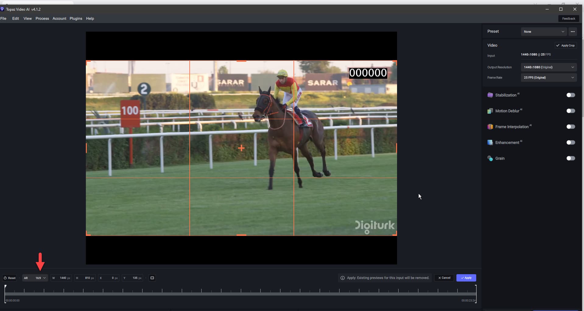

This is a 16:9 image centered in a 4:3 frame with 1440x1080 pixels, with crop set to 16:9. It looks as expected:

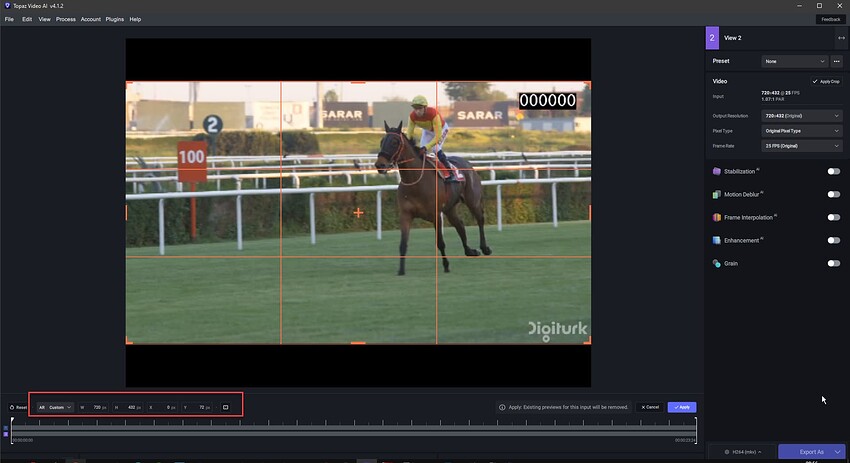

That’s exactly the same frame converted to PAL DVD. The crop says 16:9, but in fact it isn’t:

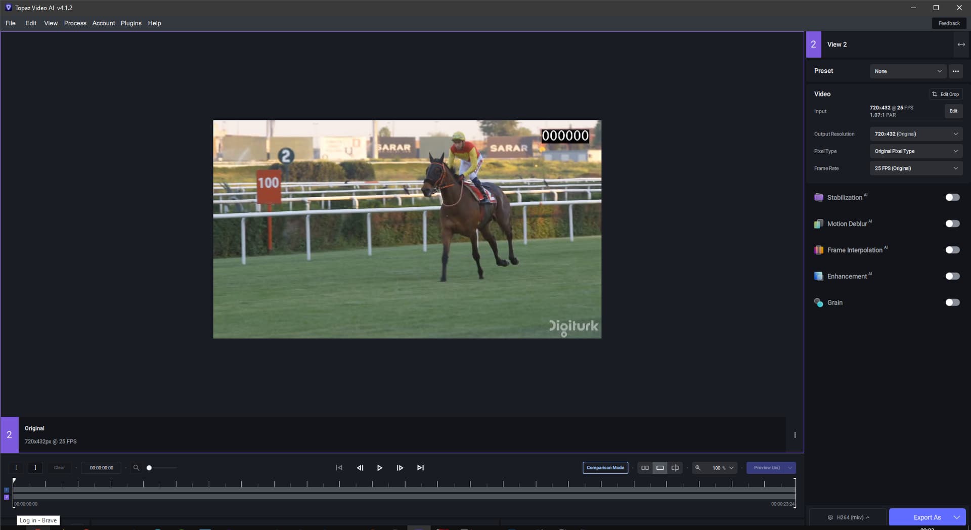

This is the crop (720,432,0,72):
That’s what Fit shows, which isn’t what you will get when exporting:

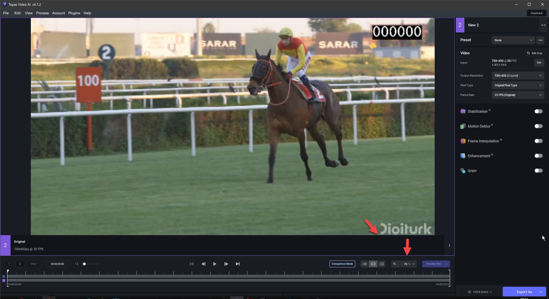

100% preview looks as epected:
