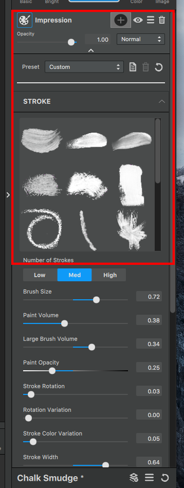

I cleared my system of ALL Topaz Studio files to enable a fresh download of resource files. The most obvious missing pieces were no brush png’s in the Studio trgc file as there are in Impression2’s/

@JoeFedric-TL Yes the new update V 1.6.8 fixed the impression brushes and textures, well done, working well for me

The newest version is 1.69…Brush strokes still not showing. Click on Studio on Beta page for Studio PR

@cre8art Sorry for the confusion but it is a PR 1.6.8 The PR version is now at 1.6.9 I just updated and still have all my impression brushes and textures

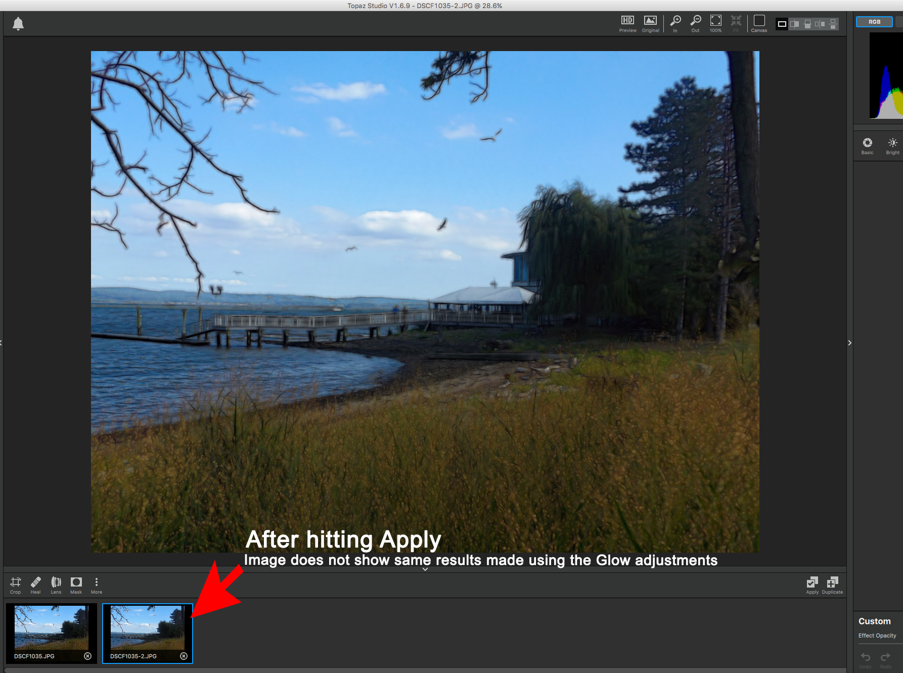

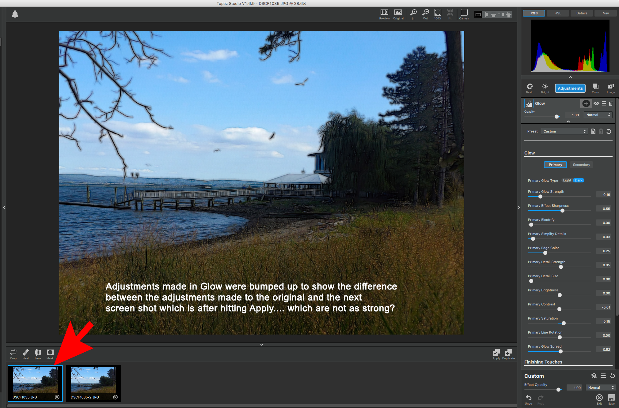

Checking Glow in Studio v.1.6.9 on my Mac using 10.11.6
I find that after using the Adjustment sliders in Glow (not sure about other adjustments)?
That after hitting APPLY you do NOT get the same results?
I bumped up the adjustments to see if they held and they did not.
After hitting Apply, the adjustments had a softer and less detailed appearance?
See screen shots below:
After hitting Apply
I also find that the zoom sliders are too extreme when using.
