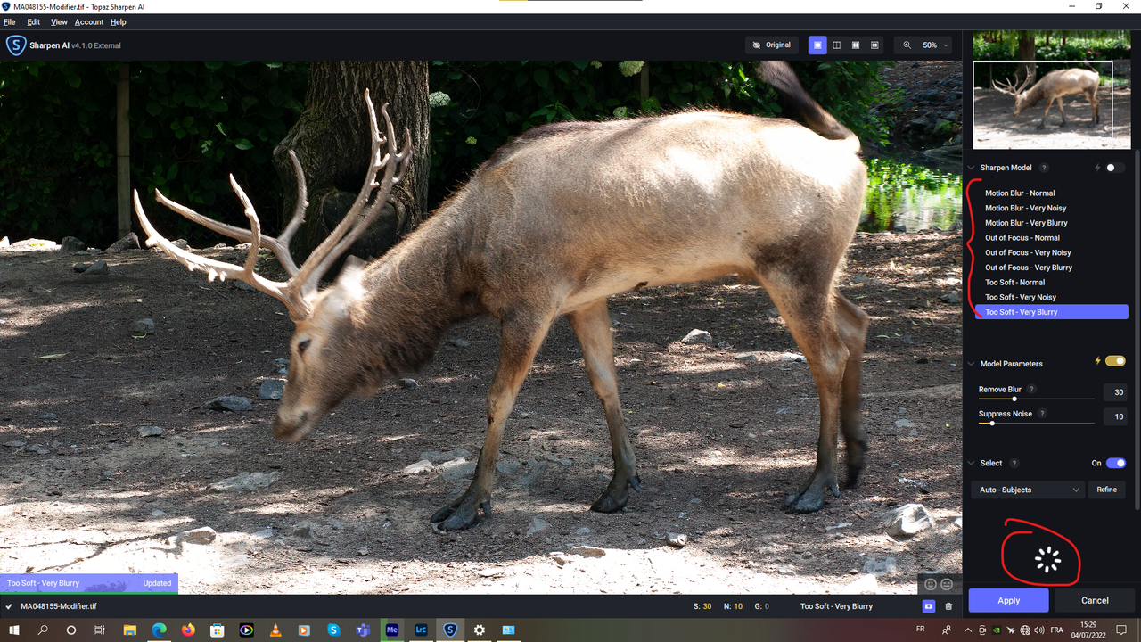

Any of these are continuously looped
Pour moi, ça ne marche pas. Si je le connecte au réseau, il fonctionne. Mais je n’ai pas le modèle standard dans le dossier des modèles. ni la fonction de masquage. And in the software, it does not appear unless the network is active. This is very annoying

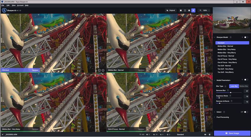

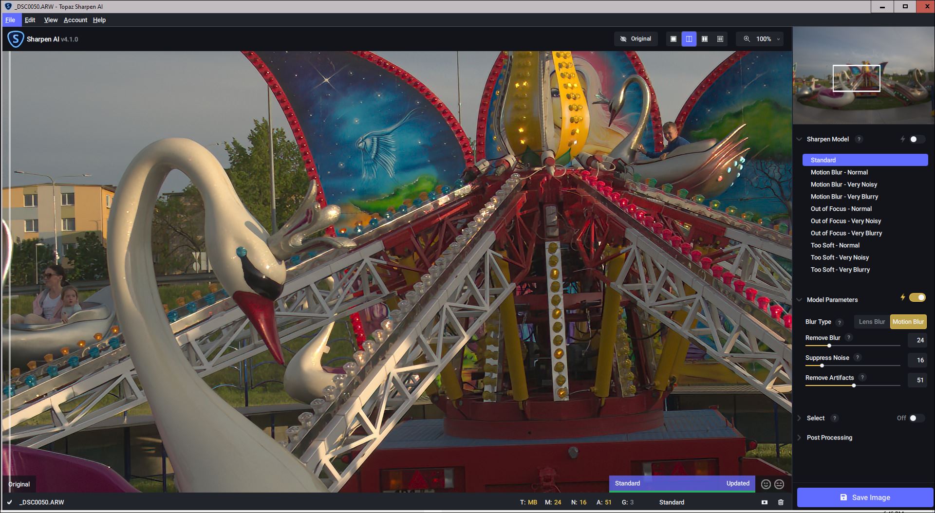

When i open the ARW file in Sharpen AI i see color profile messed up when output file color shift and haze happens all over the image regardless what export format i use DNG, JPG or TIF.

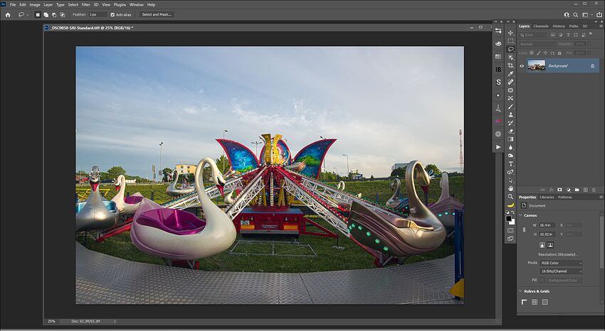

When i save ARW as TIF in Photoshop and import to Sharpen AI it outputs properly without messing up colors.
I just tried a Sony ARW image using the standalone SAI (Win 10 desktop PC).
With the image I just tested, the colors are all fine & accurate and reflect what my Sony camera captured - both while working with it in the SAI interface & as a saved output from SAI. I saved from the original ARW to a TIFF. I capture in camera as an Adobe RGB & I saved as an Adobe RGB (when in the SAI save as settings panel).
I think sometimes diff. images seem to behave in diff ways in the software (for some reason beyond my pay grade…). What is the image that you used? Can you post before, after and during (ie, in the SAI UI) snips of what you saw? Did you change b/wn colorspaces when you saved?

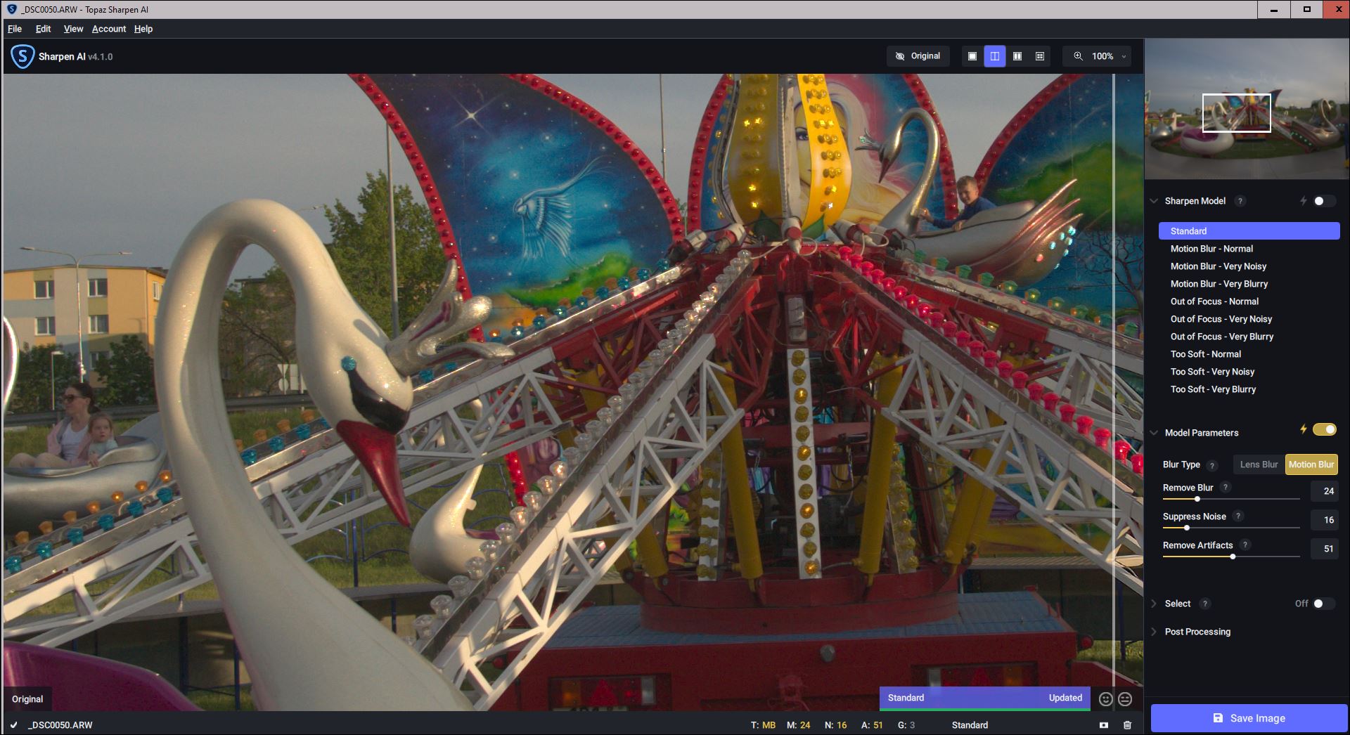

Pls. see my labelled snips below.

The busy indicator appears while its running the model. Sharpen will download required models on demand, however once the model is stored locally it will continue to work offline forever.
As for it loading forever, that sounds like a bug and you can contact us at our support page.

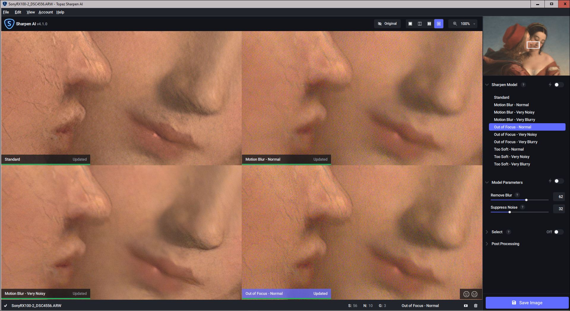

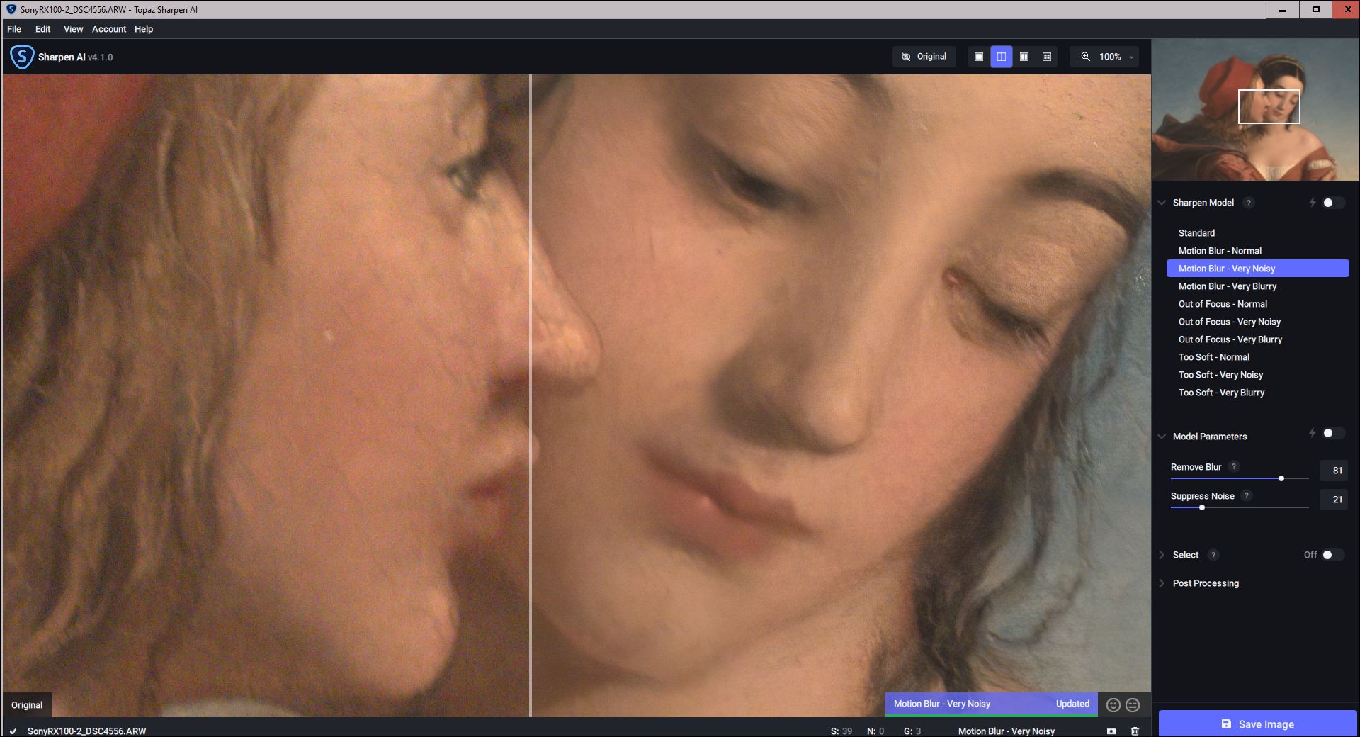

I tried the ARW image in SAI 4.1. Saved the Std model as a TIFF. Then opened that in Ps ACR and made some slider changes there. I just find I usually have to process my raw images to get colors & tones the way I want them (Topaz prods. used or not). Here’s what I saw in the various stages of experimenting:
Image (Sony ARW) in SAI Standalone Comparison View:
Before/Orig. (Std) in SAI Split View:
Processed Preview (Std model) in SAI Split View:

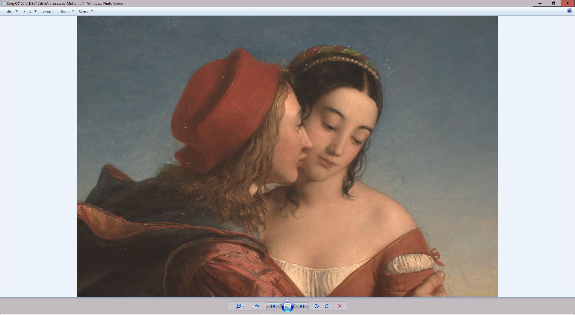

TIFF (snip of) Saved Output from SAI (Std Model):
Ps ACR processed View of the SAI TIFF in Ps: [Horizon adjust, Basics Adjust, Vibrance, Clarity/Texture]
Oddly, if I connect to the network, the autohide works and the standard model also works. But under no circumstances with any image it will download the autohide templates and standard template. Whether GPU or CPU. And as soon as I disconnect from the network. No more standard template and auto-hide no longer works. also note that the automatic mode to choose the model according to the image is also broken when it is not on the network. It will always choose the “Too soft - very Blurry” model. Whereas with network it will choose +/- correctly depending on the image. It is not normal that the software must be connected to the network to work properly if it already has all models downloaded.
Please contact support as requested.
