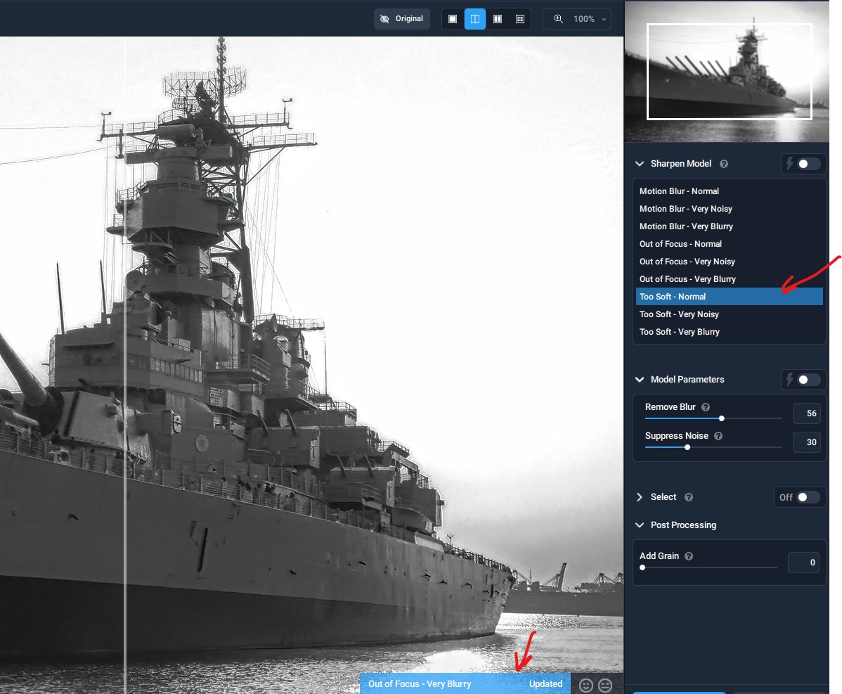

Anthony, I don’t know if you have seen this bug in V3.3.3 . I think it is also in Denoise so it may be in a common software module. After selecting Out of focus and processing the preview, I selected Too Soft and the label didn’t change. This happens numerus times with different selections.
My 3.3.3 just started doing this, too. It won’t change, although the processing seems to be happening.
ALSO, comparison mode now most of the time won’t change any of the processing modes in a blue-highlighted window. Sometimes it unlocks, most of the time it just won’t change the mode.,
And this just started yesterday after a week of it being fine.
I reinstalled and still no fix. Very disappointing. Win10, AMD Ryzen 7, AMD graphics, 24Gb RAM.
All of a sudden it doesn’t change the blue highlighted sharpen mode when a new one is chosen. Reinstalled and same. Win 10. Often in the 4-window comparison the sharpening doesn’t happen AND the window modes won’t assign as requested. So many bugs for a product with such capability. Very difficult to stay excited.

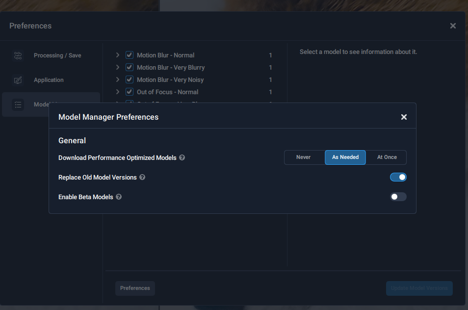

Just downloaded and installed 3.3.3 from 2.2.1. Ran it as a Plug-in from PS, which first required me to move the new plugin to a different folder. Practically nothing works. For all but the “normal” models, I get “A file is needed for this model to give you the best possible speed”. Pops up for a split second, takes several tries to piece together the entire message. I went into prefs and set “download as needed” for model files, but that had no effect.

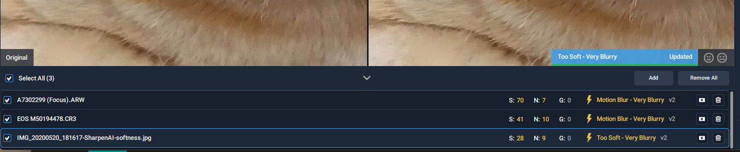

I agree with Michael and David that this seems to be a bug. Auto settings used to dynamically change with every picture and AI model chosen. Please fix!
It seems that on Win 11 the mode and auto settings do change. These are three images used for testing and the settings are close enough to perfect:

Still can’t get the model mgr to work. If I select “as needed”, nothing ever gets downloaded. “at once” is better, but it still becomes very confused about what it says it’s going to do after I check and uncheck various models, can’t clear it’s head unless/until I exit and restart the entire application.
Ditto here.

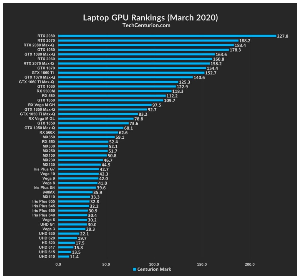

Mike, one comment, your GPU is near the low end of what might be acceptable for these products. Below is a performance chart using a bench test of many GPUs. You can see the 620 near the bottom. One reason is that it is not using VRAM but is using the normal system RAM which is slower.
Note: Model preferences has been eliminated in later versions.
