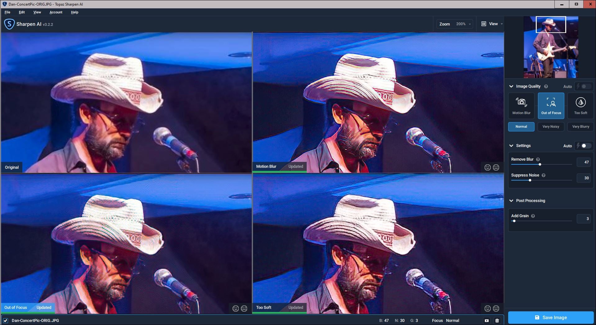

So it looks like I’m using 3.1.0, I’m going to upgrade and see if that makes a difference. Sorry, guess I didn’t realize that. Here is a sample using 3.1.0. The original is the first one, you can really see the halo effect in the second one around the hat.

When you mentioned halo’ing I pictured the hard-edged halos that sometimes appear along the edges of mountains in landscape shots. What I’m seeing in your After SAI pic above is a very soft, glowy halo. It’s quite distinctive. I wanted to see if the original had any kind of contrast that SAI was accentuating. But I’m not seeing anything that should produce that edge softening and drift.
I made a snip of your Orig. above (so obviously I’m working with not high quality starting image…). By doing that I didn’t see any real halo’ing appear in the After previews on my system (using rel. 3.2.2). It may be a result of me snipping from a low-res image, but what I do see is that the Motion Blur correction ends up looking like an illustration and produces a lot of yellow & greenish turquoise artifact color noise. Out of Focus looks the best to my eyes (I enlarged to 200% for viewing). But there’s also some greenish/turquoise color artifacting in your singer’s wht cowboy hat. Too Soft just looks like a pixelated version of the Motion Blur preview - to me.
See what you think. Here’s a snip from my screen. But best for you to work with your original image. Try the comparison views to pick your favorite AI model. Then increase to at least 200% to look at the details more closely (and see if you’re getting the color artifacting I am in my “secondhand, low res snip”).

Once you gen your SAI model previews and pick the one that you like best. If you’re still getting some soft halo wht drift around the cowboy hat… what happens if you go into Masking (within the SAI interface) and mask off the sharpening just outside the perimeter of the hat (so on the blue where the halo-ing was appearing)? The program should be able to delineate boundaries like that. But it could be that the almost blown/blown highlights are faking out the models somehow (I’m not a programmer, I don’t know…). That kind of thing would be okay to fix if you’re working with indiv images, but if you’re batching that would be a “bear” to do for each image.

I use SAI as a standalone…I’ll try comparing all the options available, I’ve just always used motion blur as a default, but maybe playing around with other options might give me better results.
Can’t hurt to compare then switch to a split, side x side or single view for the model that looks best for any given image in comparison view. Probably depends on your ultimate use and output method how precise you feel your images should be & how much time you want to invest per image. Glad the update fixed the halo’ing for you.

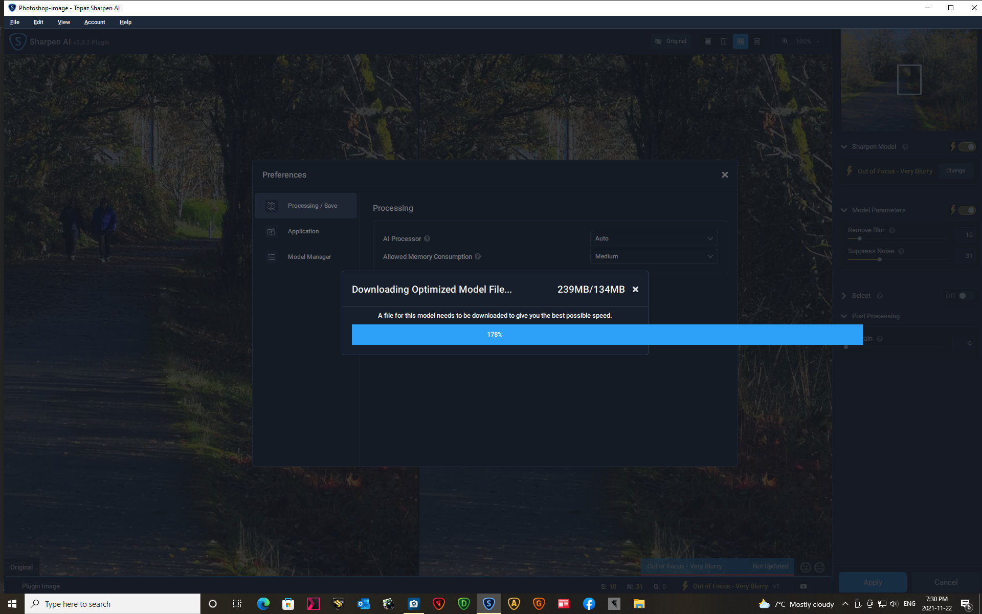

There are significant issues in 3.3.2 model management. Downloading a “new model” and the percentage update going across the screen at 632%!, going in comparison view, it starts flashing as it attempts to downloads new models (all of which I already downloaded).
I have the same problem - is it best just to roll-back to an earlier version? It’s pretty much unusable as it is…
It did the same for me.
I thought the loading bar was really funny.
