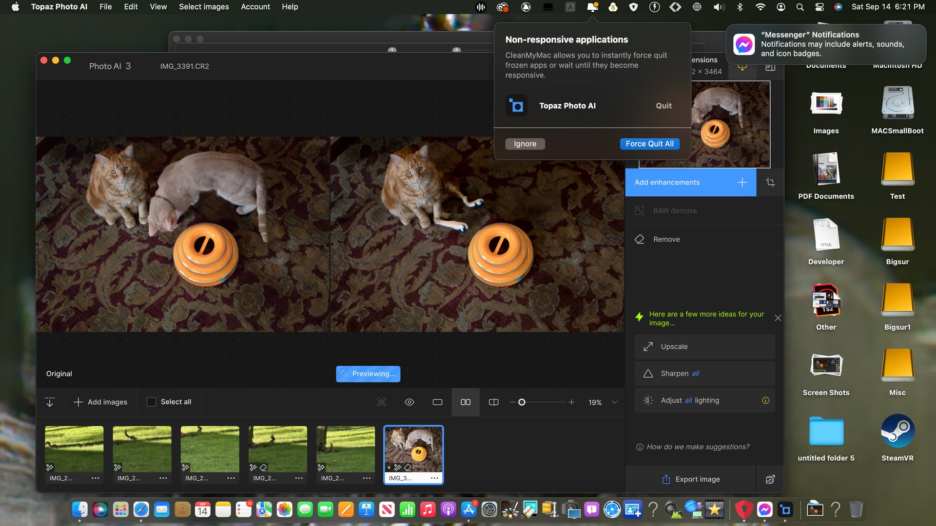

Steps to reproduce issue:
  1. Step 1
    Load Photo
  2. Step 2
    Select cat on right
  3. Step 3
    Select Quality than remove
IMG_3391.CR2 (26.4 MB)
2024-09-14-14-33-30.tzlog.zip (75.8 KB)
iMac.spx (8.2 MB)
Thanks for sending in those screenshots, and I understand this is not an ideal edit to receive for this image. It also appears that you are experiencing a crash while using Photo AI. I want to get some more information to help troubleshoot the problem you are having.
Could you send us your computer’s full system profile?
Also if you can, please try to recreate this crash in Topaz Photo AI, then go to Help > Open Log Folder, please send me all of the files within that folder. You should be able to attach them directly as a response to this thread.
If you would prefer you can securely submit your files(s) to my Dropbox using the link below. Make sure to send me a note to let me know you sent something. :slight_smile:
Dropbox File Request
Those were up loaded
As you see it happens if you remove like you show in face book.if you remove objects apart or only 1 doesn’t
Happen.
Just uploaded.
Thanks for sharing that information. I’ve included these examples with an ongoing development ticket our Support Team has opened with the developers.
I will be sure to contact you on this thread once we have more information regarding this issue.

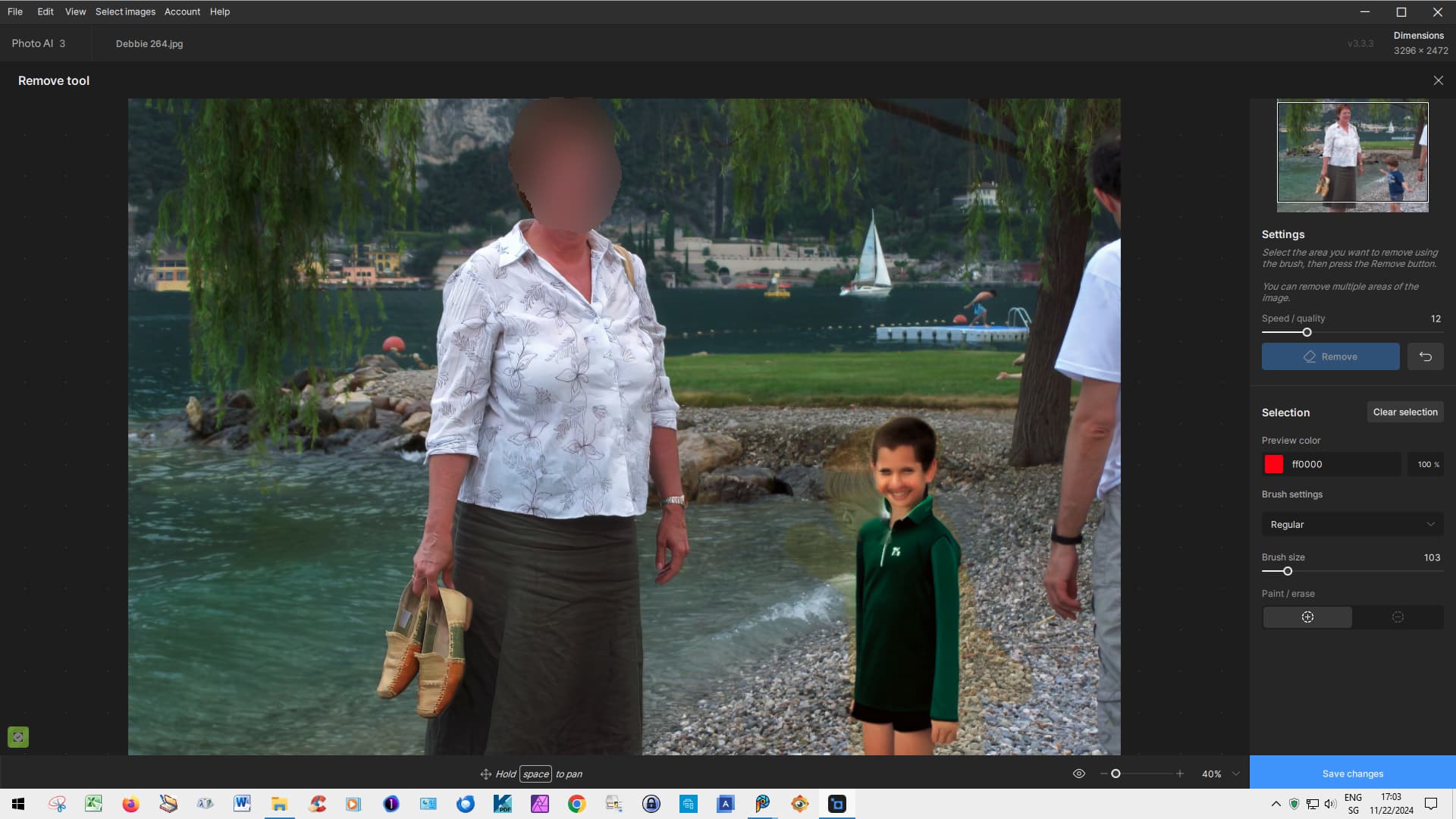

Tried ‘remove’ on a photo of my wife.When I took the photo a little boy ran into the scene. Just for fun I have used ‘remove’ on this one with astonishing results. The little boy did not disappear but was replaced with another boy. I tried the same again with the result that instead of removing the boy a different boy came into the photo.
  1. Step 1
  2. Step 2
  3. Step 3
Topaz Photo AI [v.3.3.3 [Windows 10
Hi. This is happening because you’re not completely covering the boy I mean every aspect of the boy and your mask is the shape of a small person and that’s why Photo AI is replacing the boy with another one.
To resolve this paint completely over the boy and trying not to make your mask the shape of a human then apply Remove again
Hope this helps
Seems rather weird to have to do this if using the “remove object” selection
Ed
Hi Ed.
It seems weird yes but, if you zoom into the image with the Mask you’ll find that they haven’t completely covered the whole body there is still parts of the boy’s clothing showing outside of the Mask.
The Remove Tool analyses the image as well as the shape of the Mask and recognises those parts missed by the Mask are indeed clothing and the Mask is the shape of a small person
Therefore, going by the information the Remove Tool has it’s taking those small parts of the clothing as well the Mask shape into consideration and thinks the user wants to replace one small person with another.
This isn’t isolated to just Topaz AI products this behaviour is true with all AI related software for instance the Adobe suite of products.
The thing is, the user thinks they have covered the whole object with a Mask then click Apply and it doesn’t work because, the whole process happens so fast the user naturally think it’s the software at fault when in reality it’s the user who hasn’t Masked the object completely in the first place
Hi thanks for this. It worked!
