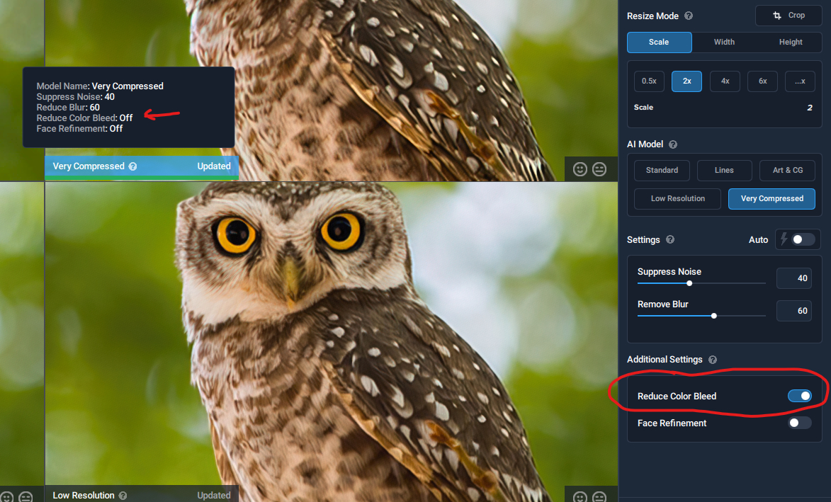

Topaz should have fixed the info call out on this 5.6.1 update. I mentioned it previously and the call out does not show the correct info for Face Refine and Color Bleed settings. I finally found a way to capture this below. Only the setting for color bleed was on at the time.

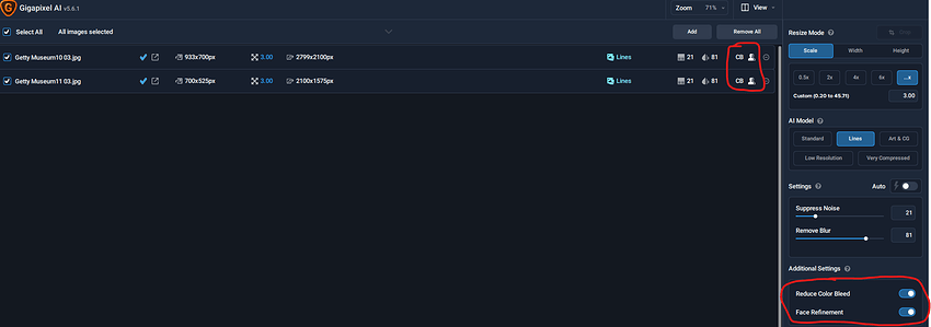

That makes me wonder whether the saved version had it on, or off…
I think the saved files had the correct settings. You can see here that the results after saving show correctly.
