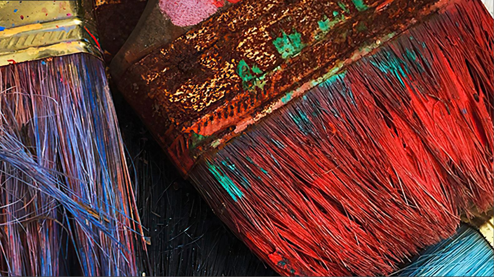

The end result is that 6X scaling still is far superior to just using standard methods like Bicubic. Below is a test using the 1000 x 1000 px paintbrush picture that comes with Gigapixel. You can see that the 4X + 1.5X is slightly sharper than the 6X version but I believe that is due to extra sharpening by running twice. The 6X + unsharp mask is equivalent. All settings were reduce noise = 40 and reduce blur = 40 and picture crops are 50%.
6X bicubic only:
Gigapixel 4X resized to 6X using bicubic:
Gigapixel 6X:
Gigapixel 4X then 1.5X:
Gigapixel 6X + unsharp mask:
My favorite Unsharp Mask settings are Amount: 20%, Radius: 30 pixels, Threshold: 0. This provides a nice touch of local contrast enhancement to make the image look crisp (less veiled) without creating any sharpening artifacts.
