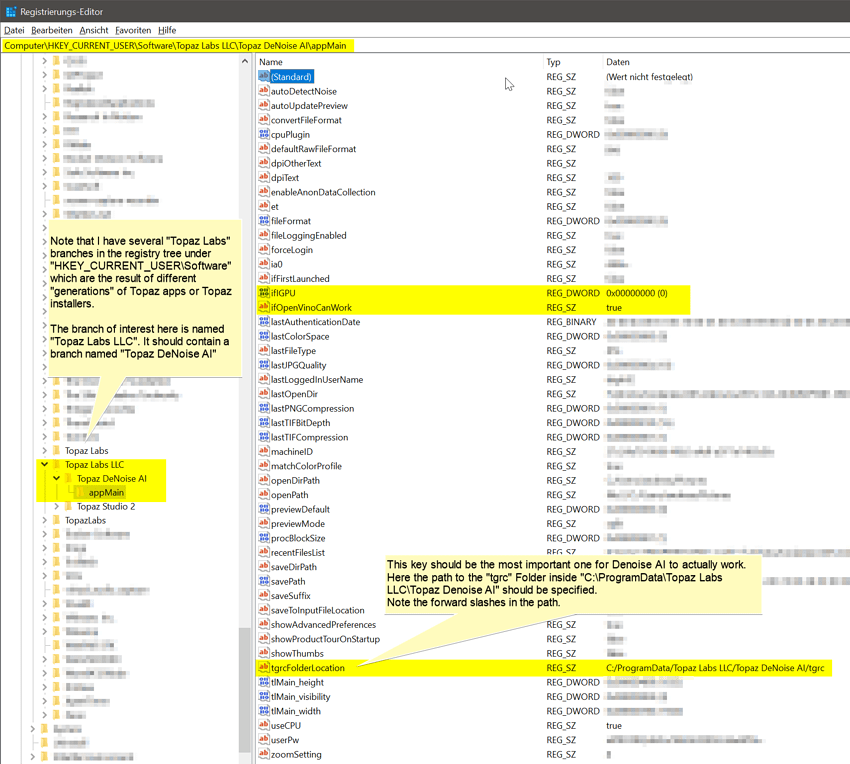

    In my case the installer created the registry keys correctly for the Administrator user but not for my normal user account. Specifically the key where the path to the folder where Denoise AI finds its resources was plain empty. I had to manually enter the correct path in the registry key HKEY_CURRENT_USER\Software\Topaz Labs LLC\Topaz DeNoise AI\appMain\tgrcFolderLocation. One thing to pay attention to when doing that ist that you need to use forward slashes instead of backslashes.

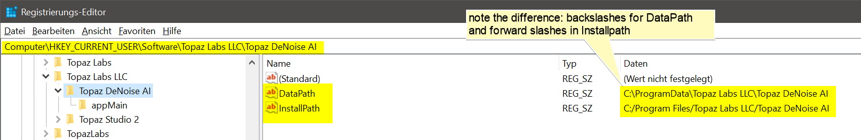

    Because a picture tells more than a thousand words I attach two screen shots where you can see the correct location for these keys and the values needed for the most important ones.
Keep in mind that modifying the registry can potentially damage your system. So always be sure to make a backup before using the registry editor (type “regedit” on the command line)!
